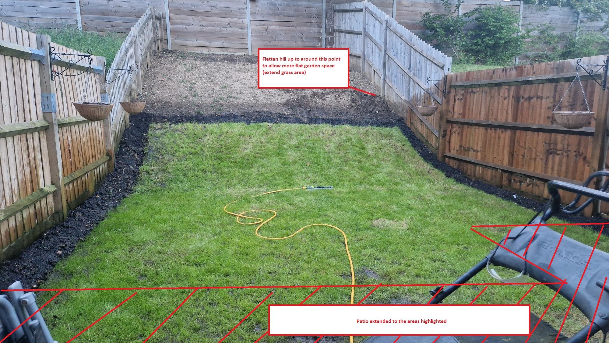

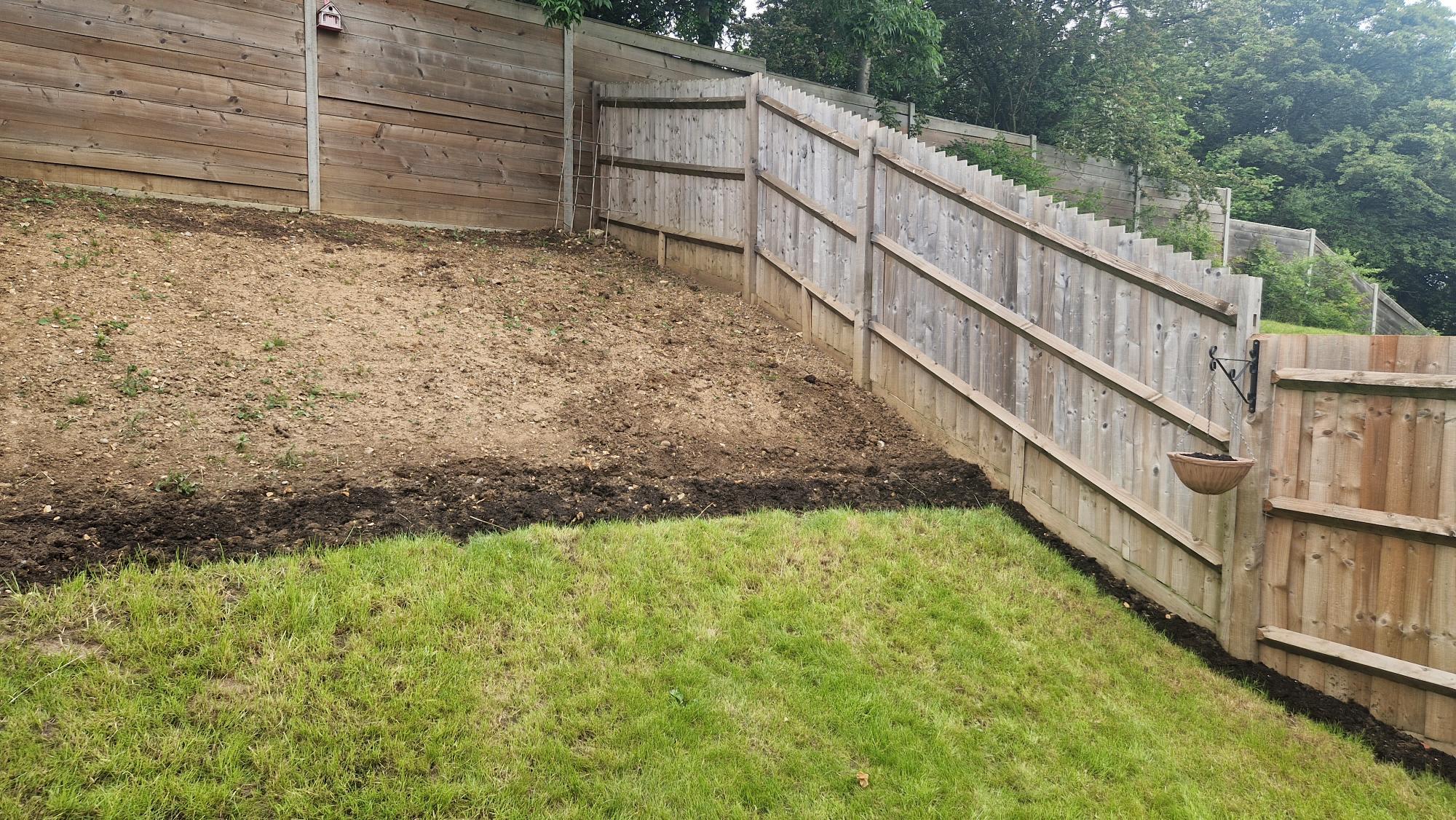

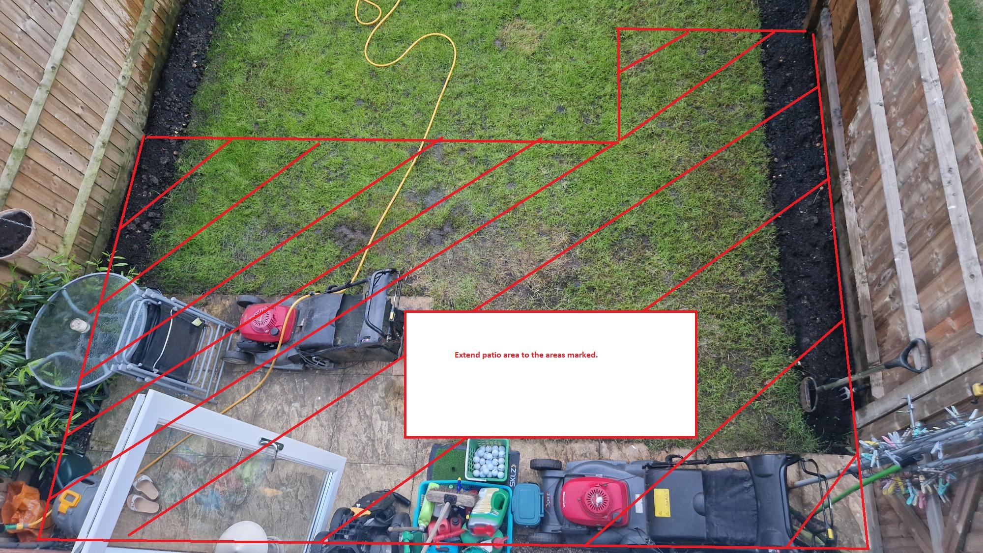

sb1987 Posted June 4, 2023 Posted June 4, 2023 Hi all, I'm looking to redesign my garden. As you can see from the pictures, almost half the garden has a fairly steep slope which is wasted space. I also plan on extending the patio area because currently there is only enough room for a very small table and two chairs. The reason I want to flatten part of the slope is because otherwise there will be very little grass area left. I'm aware a retaining wall will be required, and have toyed with the idea of a Gabion wall too. I'm also aware anything over 2m would require planning permission. The slope runs all along the back (neighbours garden on the left, community car park on the right), so obviously the adjoining ground height difference on either side will need to be accounted for if the slope is removed. Another option is a stepped slope, but again, my priority is to extend to flat grass area as much as possible. I'm sure this could be a considerable amount of work and some of you may suggest to just plant shrubs/trees at the back, but this is something I really would like to have done to maximize the usable space. Even cutting the grass on the slope is hard work, currently. Does anyone have any suggestions? Or a very rough idea how much something like this would cost (I know it's hard to say) - I hoping for it to be £10k or less. Many thanks.

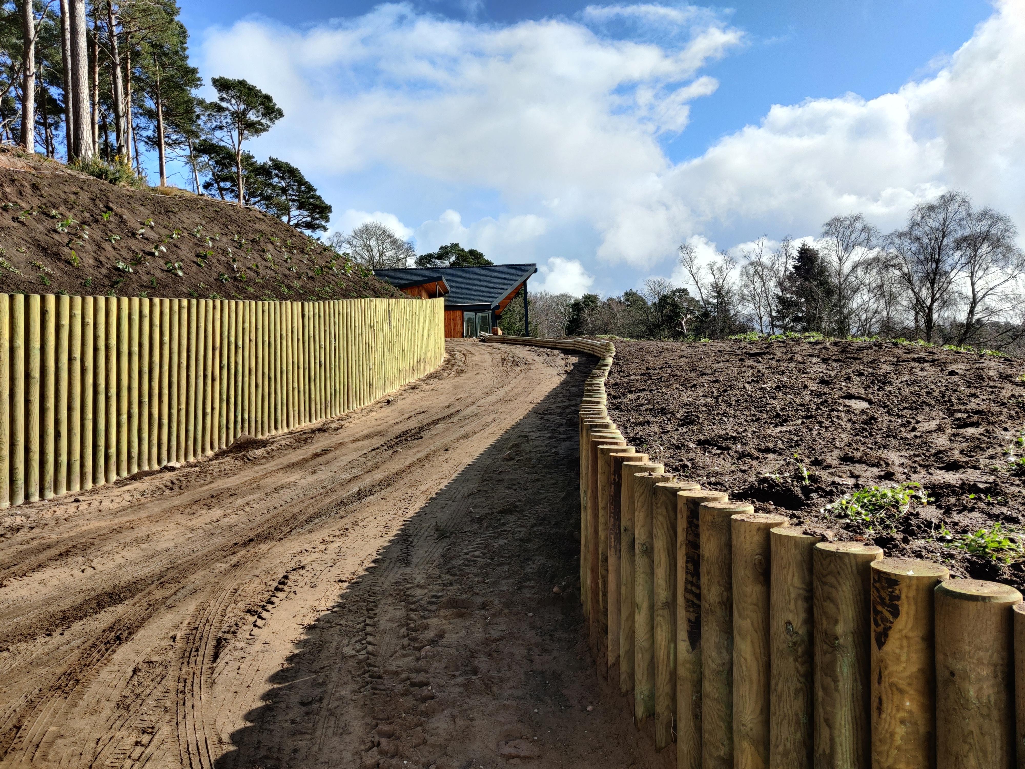

JohnMo Posted June 5, 2023 Posted June 5, 2023 Buy a pair short ski's or snowboard. Small dry ski slope? We used 8" diameter posts to hold our bank back. Think they are 3M long, with a meter concreted into the ground. . 1
Wumpus Posted June 5, 2023 Posted June 5, 2023 It might be possible to create a couple of terraces and use the dig-out from the lower level to backfill the upper level behind some kind of gravity structure like gabions. Cartaway will be expensive so best avoided, especially as your access looks difficult. It will need some kind of excavator I would think, not something you would want to do by hand. another option might be a criblock system which can look softer than gabions.

Conor Posted June 5, 2023 Posted June 5, 2023 (edited) Having full drive in drive out access for plant is a game changer. A 5tonne digger will have the stripped back and trenches dug for retaining walls in a day. Another day to pour a base for the wall (assuming RC), another day of shuttering and a pour for the walls themselves. I wouldn't skimp on the retaining wall at the back as you've a fairly substantial slope above it, in these cases you are just retianing to the height of the wall, but the extra load coming "down" the slope when it's wet. You might want a structural engineer for peice of mind. Then final levelling of the ground and reinstating. £5-7k. You'd nearly double that if you only had padestrian access. Edited June 5, 2023 by Conor

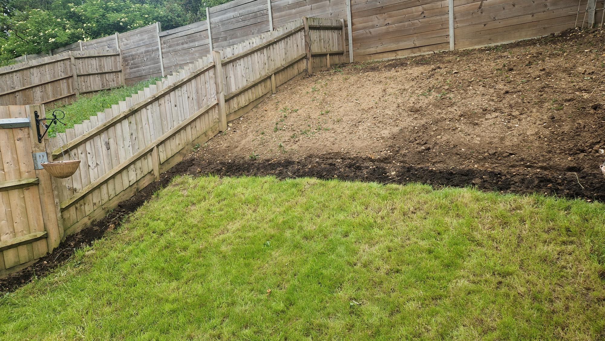

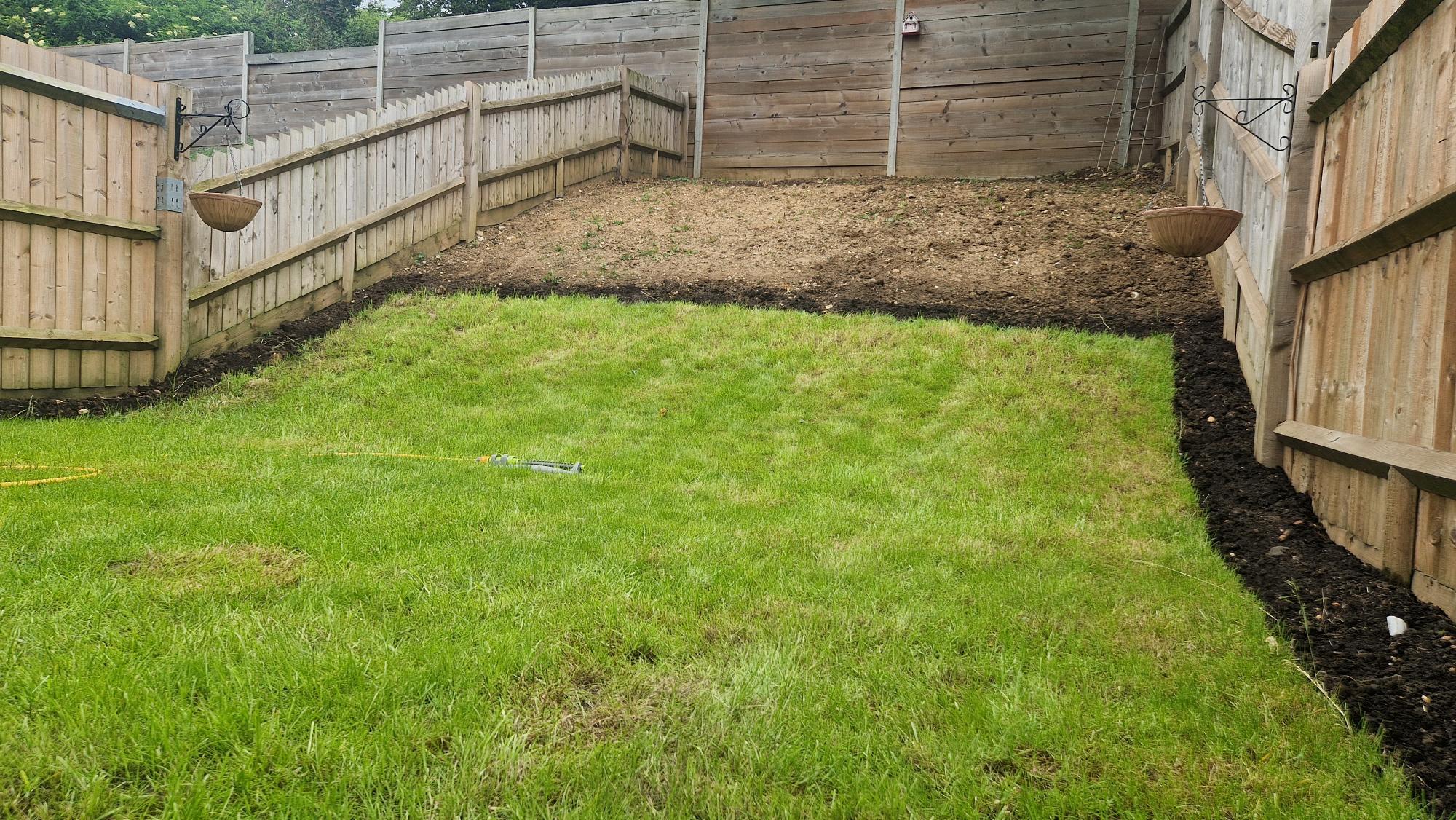

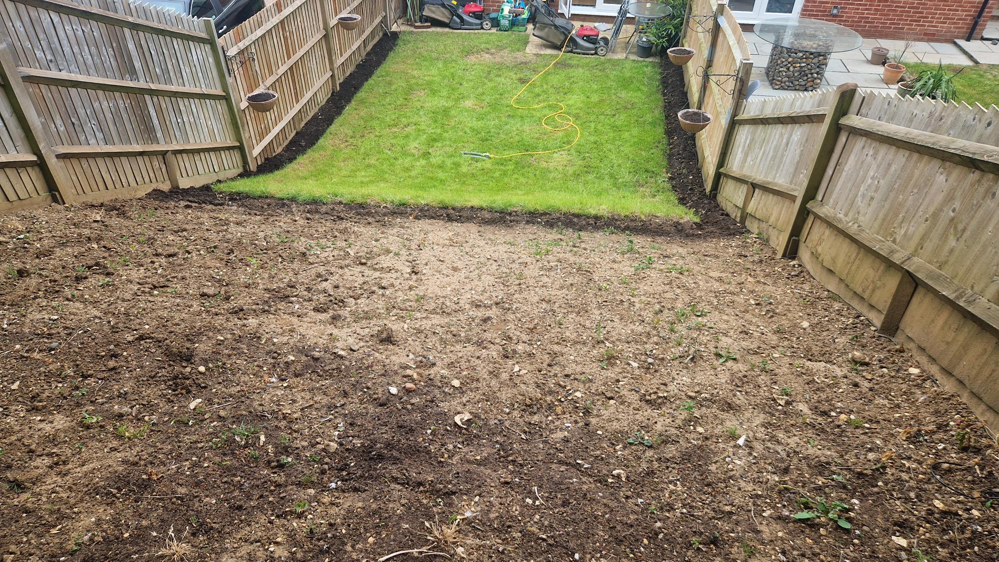

sb1987 Posted June 5, 2023 Author Posted June 5, 2023 (edited) Here are a few more photos to help vision the elevation. I would say the elevation from the flat turf to the highest point to be around 2m. Edited June 5, 2023 by sb1987
Temp Posted June 5, 2023 Posted June 5, 2023 If you dig out the full width you would most likely have to take out the fences both sides and build side retaining wall and reinstate the fences. How about leaving a meter of so either side sloping down and taper the retaining walls something like this. Gives you a recessed area near the "P" of "Plan" for a small BBQ or seating area. Not a great sketch sorry..

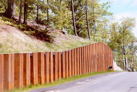

Radian Posted June 5, 2023 Posted June 5, 2023 Have you considered steel piling? It could allow you to go nearly all the way into the bank. Then dig out and maybe build a garden room!

Temp Posted June 6, 2023 Posted June 6, 2023 21 hours ago, sb1987 said: does a wall created in such a way (where there is a meter left on either side) have benefits i.e. less construction cost/effort? The main advantage is you might get away without having to take down fences and dig out your neighbours garden temporarily while you build the retaining wall. That's one advantage of the sheet steel piling that @Radian mentioned. These can be hammered into the ground close to the boundary and then you dig out your side afterwards. Curved walls are inherently stronger than straight and look better in my opinion. If you want to go back so far that the wall is over 1m high you should get a professional involved and they should be able to propose different design ideas and solutions.
sb1987 Posted June 6, 2023 Author Posted June 6, 2023 On 05/06/2023 at 21:52, Radian said: Have you considered steel piling? It could allow you to go nearly all the way into the bank. Then dig out and maybe build a garden room! That sounds interesting. After a quick google search I remembered an estate nearby has used the same for their gardens where it backs onto a steep slope. Would this be considerable work and expensive? Would it be a solution for the neighbouring ground difference once the slope is dug out?

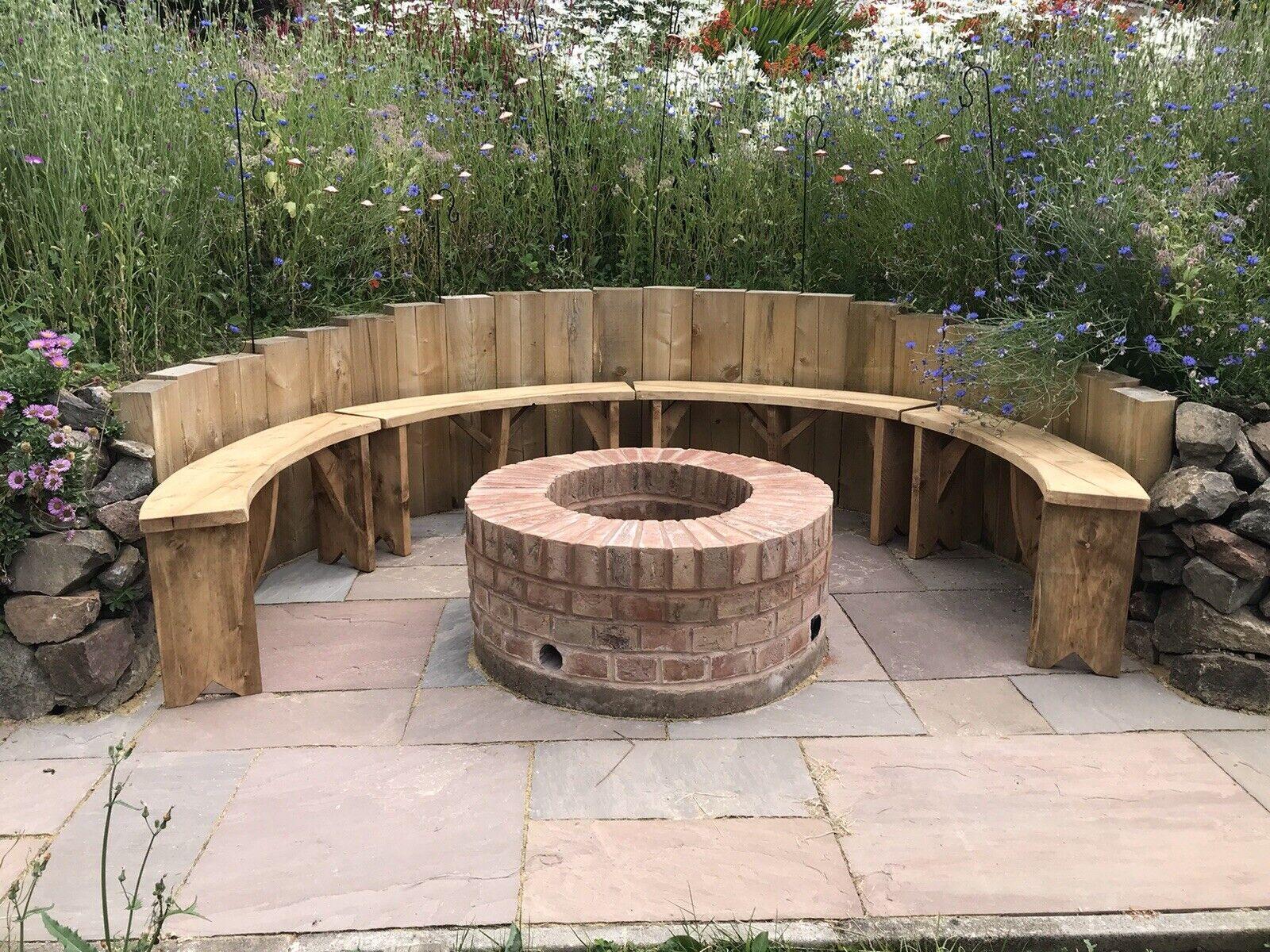

bgmill Posted June 7, 2023 Posted June 7, 2023 I would be inclined to cut a seating area into the hill, like a half-sunken fire pit enclosed on 3 sides. 1
oldkettle Posted June 7, 2023 Posted June 7, 2023 A general observation. Get a laser level and measure the actual fall, you can easily do this in the evening. I was surprised to find out that our slope, which doesn't look steep from the house, is over 3m overall.

sb1987 Posted June 7, 2023 Author Posted June 7, 2023 11 hours ago, bgmill said: I would be inclined to cut a seating area into the hill, like a half-sunken fire pit enclosed on 3 sides. That looks nice, but I believe will still need a form of retaining wall to encircle it.
Temp Posted June 7, 2023 Posted June 7, 2023 On 06/06/2023 at 22:02, sb1987 said: That sounds interesting. After a quick google search I remembered an estate nearby has used the same for their gardens where it backs onto a steep slope. Would this be considerable work and expensive? Would it be a solution for the neighbouring ground difference once the slope is dug out? Yes the sheet steel piling serves as a structural retaining wall. If you don't like the look you can add non structural timber cladding or planting to hide it. While googling for a picture I found there is also PVC sheet piling but not sure if available in the UK. https://www.escpvcsheetpiling.com/retaining-wall
