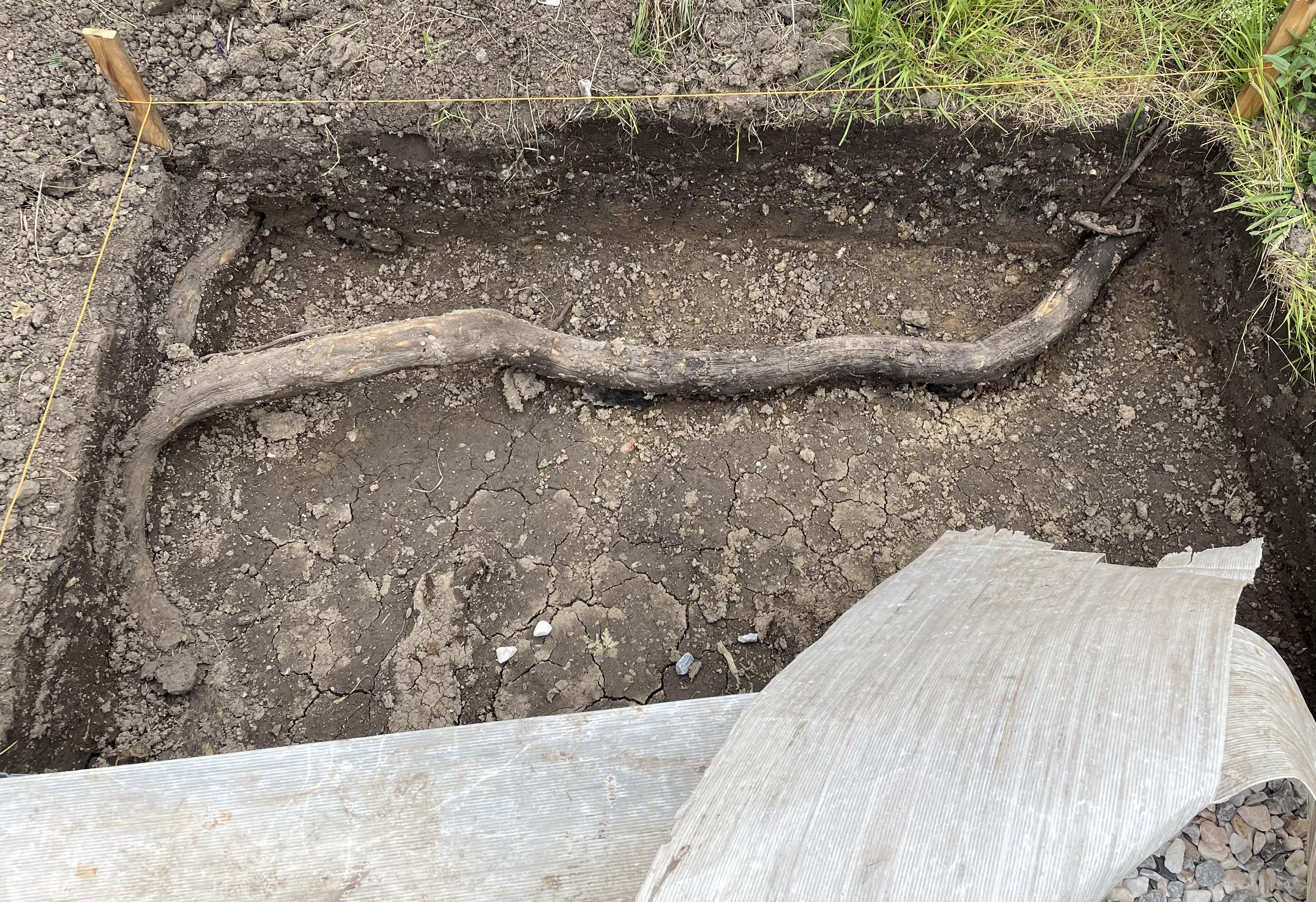

Adsibob Posted June 6, 2023 Author Posted June 6, 2023 Bloody good job I insisted on over engineered foundations. Look what they found: A rather large tree root (diameter is about 9cm), almost certainly from an apple tree we cut down almost 5 years ago. Had I gone less deep, we might have missed this root, it would have eventually rotted and caused moree movement that my barbecuing skills can cope with! 2
George Posted June 7, 2023 Posted June 7, 2023 You do need to go deep enough to get to clean sub-soil but you don't need to build back in concrete. 150mm layers of compacted stone is a lot cheaper.
saveasteading Posted June 7, 2023 Posted June 7, 2023 Saw the trunk off and wrap some polythene up the face to keep out small roots. your choice stone or concrete base.
