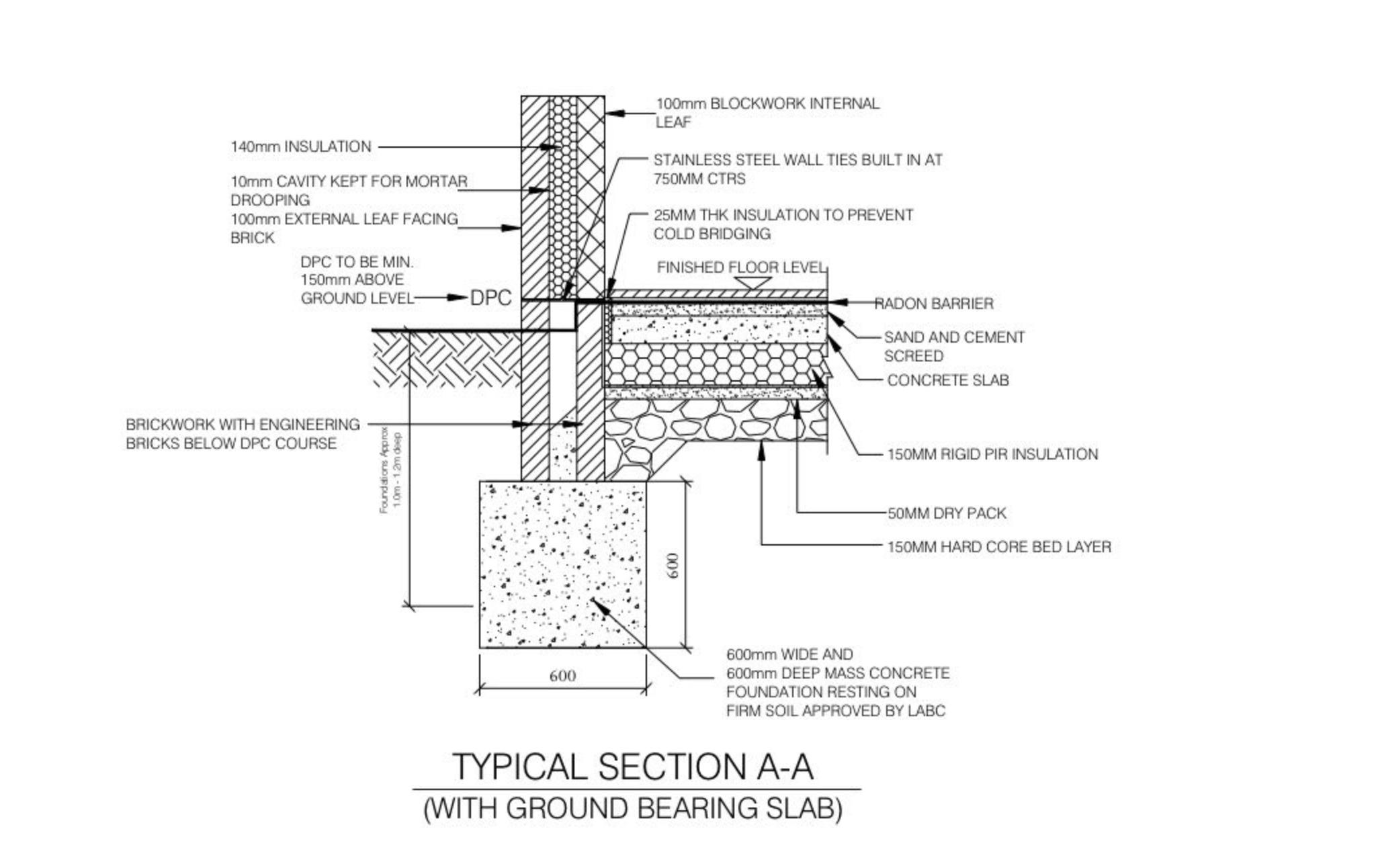

Sophiae Posted July 6, 2023 Author Posted July 6, 2023 (edited) @ETC would you kindly help me figure this out. Finally after 4 weeks or so I got the B-regs done. BCO happy but sent me this note yesterday. “the section through the foundations, oversite and dpc is missing a second radon barrier Tray but I can explain on site providing I inspect before you build”. I want to understand what he means prior to his visit as I won’t be able to be there on every occasion (childcare issues). Any drawing would be greatly appreciated. Edited July 6, 2023 by Sophiae

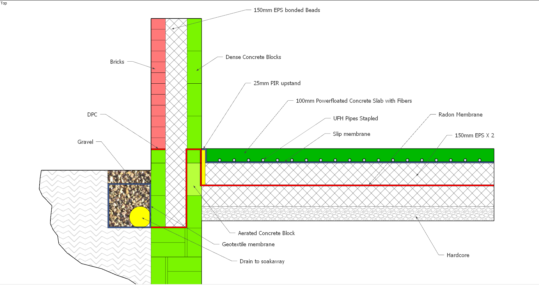

Iceverge Posted July 6, 2023 Posted July 6, 2023 Strange detail that. Not to fear, plenty of expertise here. Are you planning on UFH? A simpler detail for the floor might be. 1. Finished floor. 2. 100mm powerfloated concrete slab with UFH stapled to insulation. 3. Slip membrane. 4. Insulation ( as much as you can fit) EPS is cheaper and better than PIR in my opinion but thicker. 5. Radon Membrane. It's just a slightly thicker sheet of plastic with all tapes welded/taped so does the job of the DPM. 6. Sand binding. 7. Hardcore. You'll have a significant thermal bridge at the wall floor junction there. You need an aerated concrete block in line with the insulation and to take the cavity insulation down to the plane of the floor insulation. 150mm full fill EPS beds would be my choice as it can be used to insulate below ground level and is harder to muck up and will give a U-Value of 0.21W/m2K. I might do a drawing....

Iceverge Posted July 6, 2023 Posted July 6, 2023 Points to note 1. I've moved the Radon membrane between the two layers of EPS and forgone the Sand binding as the EPS will protect the membrane. You could then use 150mm X 2 of Floor insulation then which will give you a U value of about 0.11. 2. I've put a French Drain at the perimeter which is always a good idea to keep the bottom of the walls dry and prevent splashing. 3. The cavity insulation extends well below the floor insulation. This will ensure any mortor droppings don't fill the cavity and create a thermal bridge here. 4. The PIR upstand is "pinned" in place by the floor insulation. Otherwise it comes loose during the floor pour. 5. Let the slip membrane extends well beyond the internal leaf during the pour and trim it back later. It'll protect the Radon membrane and the PIR upstand during screeding. 6. I've included the block sizes to allow for normal cavity tie spacings. 1

Nickfromwales Posted July 6, 2023 Posted July 6, 2023 1 minute ago, JackofAll said: What is the slip membrane for? It's unnecessary with a concrete pour afaic, but necessary with a Flocrete or liquid screed. Radon is down low with Kore and MBC, so doesn't need much more protection other than at the perimeter, where it is exposed for a while. The upper level of EPS becomes the 'sacrificial layer' and protects it. 1
Sophiae Posted July 6, 2023 Author Posted July 6, 2023 1 hour ago, Iceverge said: Points to note 1. I've moved the Radon membrane between the two layers of EPS and forgone the Sand binding as the EPS will protect the membrane. You could then use 150mm X 2 of Floor insulation then which will give you a U value of about 0.11. 2. I've put a French Drain at the perimeter which is always a good idea to keep the bottom of the walls dry and prevent splashing. 3. The cavity insulation extends well below the floor insulation. This will ensure any mortor droppings don't fill the cavity and create a thermal bridge here. 4. The PIR upstand is "pinned" in place by the floor insulation. Otherwise it comes loose during the floor pour. 5. Let the slip membrane extends well beyond the internal leaf during the pour and trim it back later. It'll protect the Radon membrane and the PIR upstand during screeding. 6. I've included the block sizes to allow for normal cavity tie spacings. My arrangement was made to match the pre-existing floor type (solid concrete). The only difference is that existing slab doesn’t have any insulation as it was built pre-insulation era. The extension is rather small 4X9m at the most as the walls are 35cm housing the 2023 150mm cavity insulation. The existing cavity walls will have the upgraded beads installed into them as we only managed to add 25mm PIR to them prior to plastering. More than that would eat more of my living space which is already small. Yes I intend to use UFH as radiators are a health hazard for my son, so I needed to make up the floor layers like that to have the most energy efficient floorings I can get. The existing building floors will be subsequently dug and insulation will be laid and concrete poured again. A Radon Sump will be installed to mitigate all Radon from the original build. Going back to the BCO comment about a second tray. Where would that be on the drawing as I failed to understand?.
Sophiae Posted July 6, 2023 Author Posted July 6, 2023 This is what I followed. But now he wants a second one?
saveasteading Posted July 6, 2023 Posted July 6, 2023 I expect there is a misunderstanding. One is enough, and can also act as the dpm.. but the original design wasn't quite right so maybe he meant something else. It's great that he's being helpful
Sophiae Posted July 6, 2023 Author Posted July 6, 2023 9 minutes ago, saveasteading said: I expect there is a misunderstanding. One is enough, and can also act as the dpm.. but the original design wasn't quite right so maybe he meant something else. It's great that he's being helpful Thank you. What do you see is wrong about the original design. It was suggested here and the only thing I did was increase the PIR to 150 instead of the 100. What seems to be the problem?
Sophiae Posted July 6, 2023 Author Posted July 6, 2023 (edited) Could it be that? TD-JUTA.GP4_.016-Ground-Bearing-Slab-Perimeter-Detail-Membrane-Below-Slab.pdf Edited July 6, 2023 by Sophiae
saveasteading Posted July 6, 2023 Posted July 6, 2023 Yes. The radon barrier needs to continue to the outside, so that any radon gas disappears into the atmosphere. So the 'second' layer may be what is shown dark blue: a strip up the wall and out. I don't know Juta products. They seem to cost more though as they are red and have "radon barrier" printed on them.
Sophiae Posted July 6, 2023 Author Posted July 6, 2023 4 minutes ago, saveasteading said: Yes. The radon barrier needs to continue to the outside, so that any radon gas disappears into the atmosphere. So the 'second' layer may be what is shown dark blue: a strip up the wall and out. I don't know Juta products. They seem to cost more though as they are red and have "radon barrier" printed on them. Thank you very much for explaining. I won’t be buying their products, I found their diagrams very useful so I wanted to share with copyrights intact.
