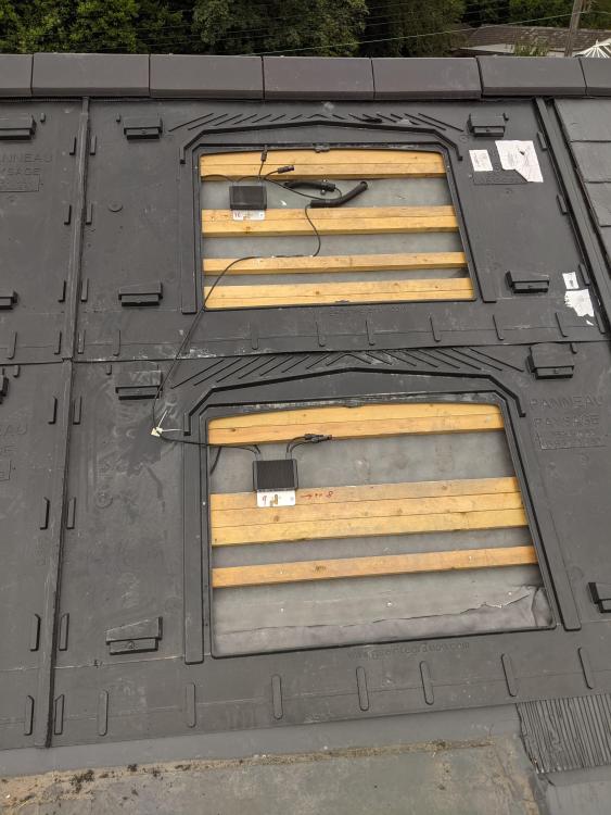

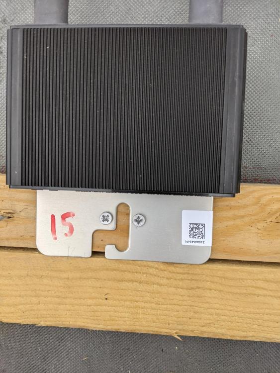

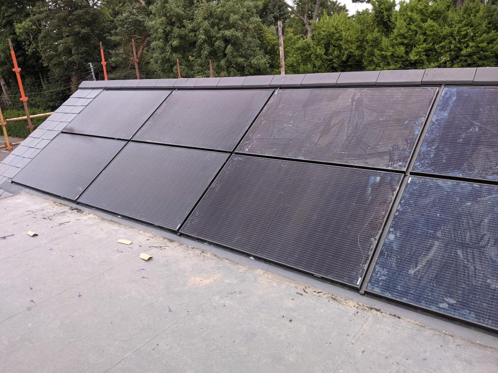

Dave Jones Posted June 5, 2023 Share Posted June 5, 2023 mcs waste of time for solar, leave them to ripoff the heat pump installs. the inroof micro inverters are very good, a little more expensive but better features. they fit underneath the panels so you only end up with a single cable entering the loft. Link to comment Share on other sites More sharing options...
