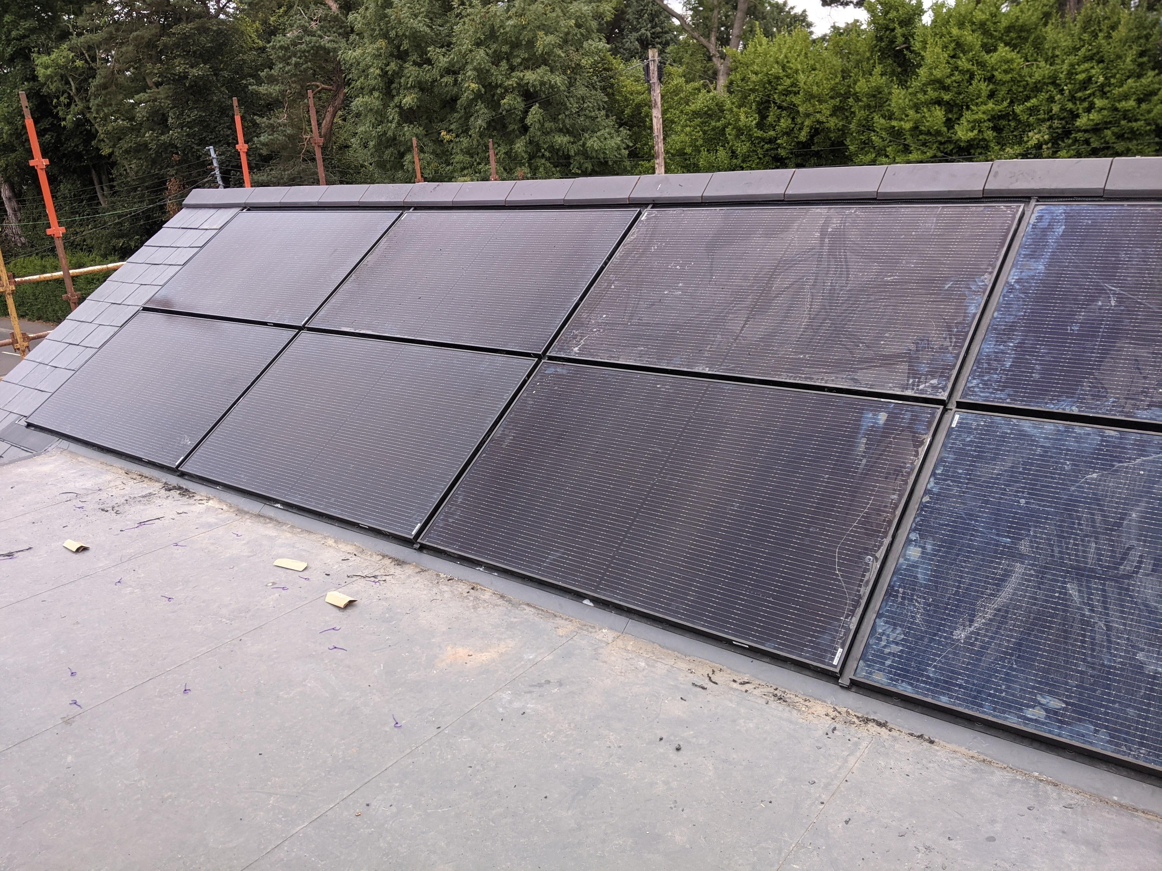

On 02/06/2023 at 12:32, Conor said:
BC won't care as long as the loadings have been accounted for in the design. Your DNO and electric supplier will, however. The installation will need to be signed off as safe and G98 compliant by a competent spark. But no requirement to be part of any scheme. My 5.2pKw in roof install cost about £5k. That includes the £600 for the sparks side of things. Prices have gone up a bit so im not sure you'll get it done for 1p/W. I installed the trays myself with help of the roofers. Fairly simple once you get your head around the battening requirements.

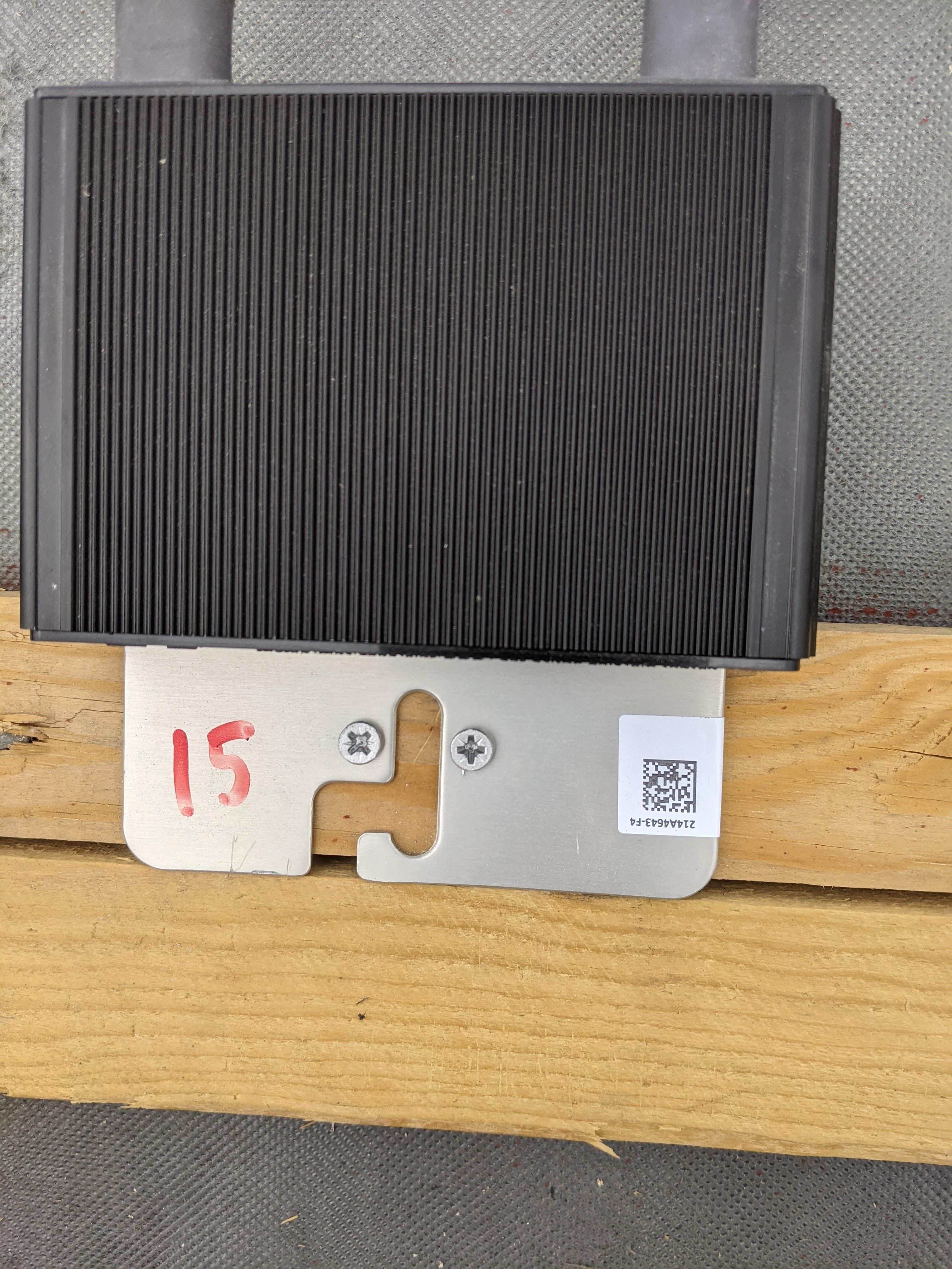

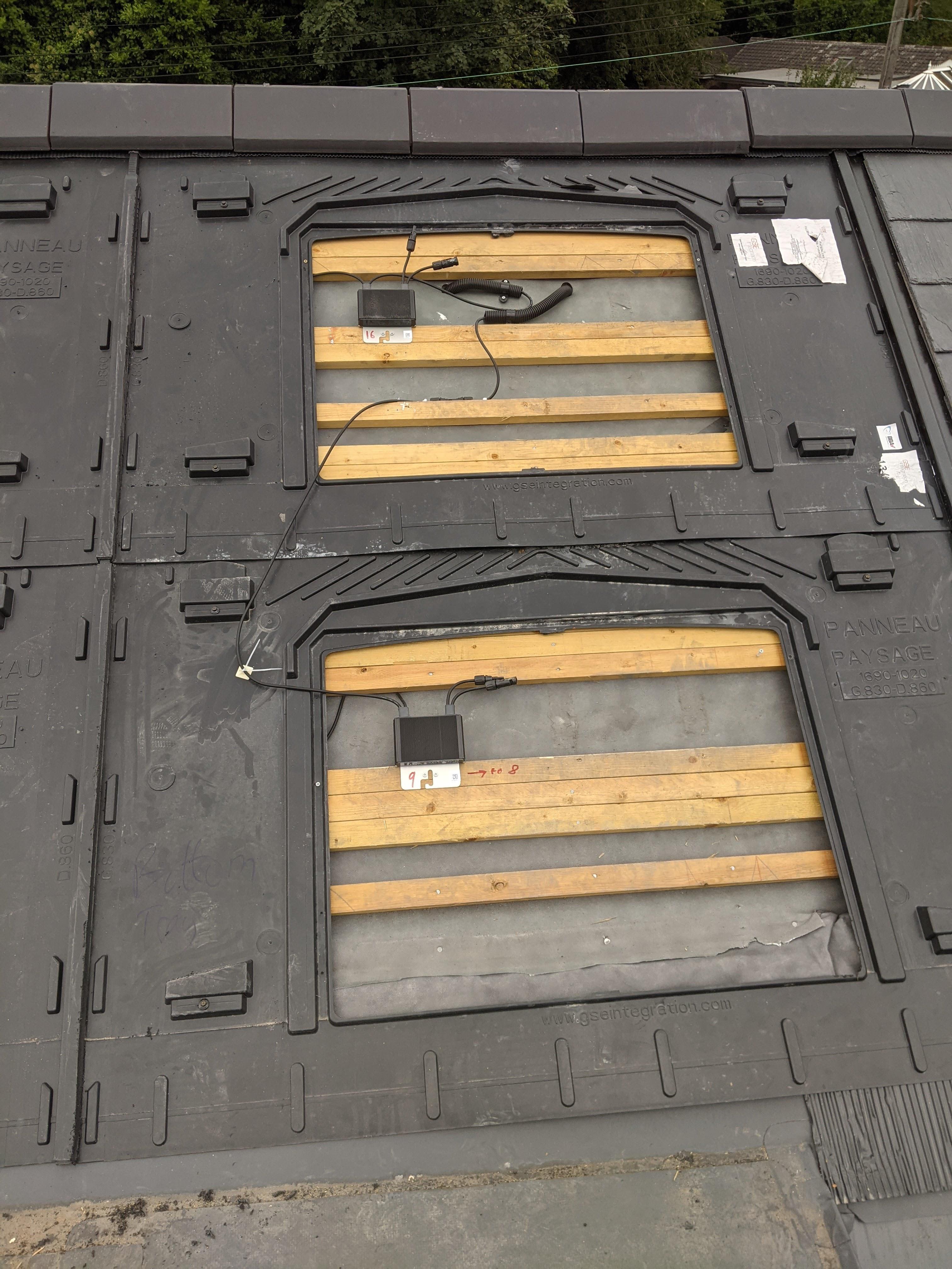

GSE panels just go directly on top of the 25mm battens as per the instructions. You need to get the batten positions right. Reccomend getting some 25x100mm battens for this. The screws with the panels are pretty hefty and I found they split the 50mm battens, even with predrilling.
I screwed my optimisers on after the roof was done.
Think these may have been facing the wrong way and I had to flip them over.

There are various batten positions needed for the panels, panel fixing point, tray fixing, clamp fixing. Yeah, read the manual first!!!
