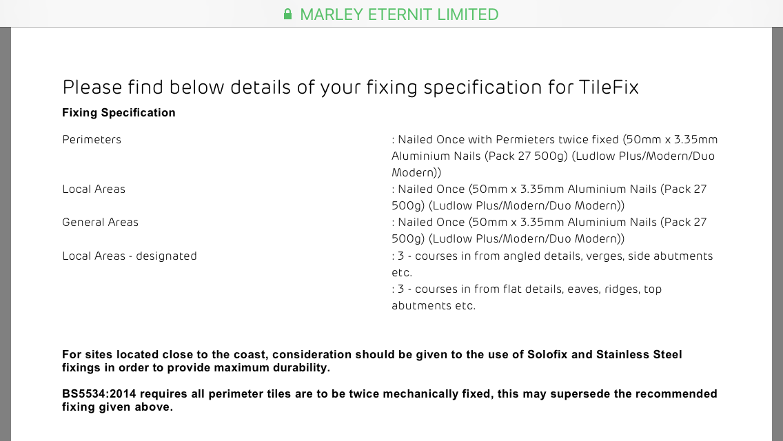

Pocster Posted August 26, 2017 Author Share Posted August 26, 2017 36 minutes ago, Declan52 said: Are you joking!!! Hard to make out from the pics but are you saying all the joints on the tiles are in a line and not 1 nail was used??? You can get roof tiles that are laid like this but they are the wavy looking tiles which yours are definitely not. Correct I did ask he said can lay crossbonded or not makes no difference . Nailing he said no point on such a shallow slope ; the nail hole was really for vertical tiles . These are not wavy tiles . They are interlocking tiles ( not sure if that's clear from the photo ). i suppose as they overlap each other the chance of a tile 'moving' must be difficult as the tile above it is holding it down . Link to comment Share on other sites More sharing options...

ProDave Posted August 26, 2017 Share Posted August 26, 2017 I would not be happy with this job. More importantly will your BCO be happy with it? The nail holes are not only for "vertical tiles" they are to hold them down in a storm. Someone mentioned nailing every third row is normal practice and it certainly does not hurt to nail every row. The clips at the bottom edge that clip them to the batten below are to stop the wing getting under and lifting them. Link to comment Share on other sites More sharing options...
Oz07 Posted August 26, 2017 Share Posted August 26, 2017 Surely a lower pitch is more susceptible to uplift. I bet manufacturers don't approve straight bond. I wouldn't be paying Link to comment Share on other sites More sharing options...
PeterW Posted August 26, 2017 Share Posted August 26, 2017 Latest spec for Marley Modern at 32.5 degree pitch. This is to the latest BS references. Link to comment Share on other sites More sharing options...
Declan52 Posted August 26, 2017 Share Posted August 26, 2017 Get on to the scaffold and try to push the tile up from the batten. The un nailed tiles will slide pretty easy. Pick a few rows and see if he really did nailed them. Link to comment Share on other sites More sharing options...
Pocster Posted August 26, 2017 Author Share Posted August 26, 2017 Right ! as you lot have got me worried I went and checked ! these are bloody heavy to move I'll tell you that - they certainly ain't going no where can confirm verge nailed can confirm on one side final row I.e into gutter nailed ; otherside not done yet as ran out of tiles ridge have to take his word for .... as for checking any 3rd row I can't even lift 'em - too worried they'll break . they are rock solid I have to be honest - nothing has a hint of moving even at the edge where I can get full access you guys stop worrying me !! Link to comment Share on other sites More sharing options...

Pocster Posted August 27, 2017 Author Share Posted August 27, 2017 Thinking about this there is some kind of lesson to be learnt. I can't do it because of the height; that's the only reason. Watched enough videos , got this forum and it's not rocket science . I would do it correctly and anything I was unsure of I would get checked. I could do a better job. But because of the height and 'fear' of getting it wrong and doing a bodge job I employ a 'professional'. He in turn has no fear of heights and effectively does a bodge job. Will the tiles blow off; unlikely . Will the roof leak unlikely . So for him it's a "job well done" i.e. profitable and quick. Is it sub standard?; yep. Does he care?, nope. BCO care? ; too be honest and based on my experience probably not TBH. So!. The lesson is simple. DO IT YOUR F*ECKING SELF! as long as it's not high He's coming back Tuesday to 'finish'. I've withheld cash (yes; it's one of those jobs); so I have leverage. As a landlord I get lied to and attempt to be manipulated all the time with BS. I shouldn't really of expected any difference here. Let's at least get *some* tiles nailed in! - the verges should be easy!. Anyone else in the future reads this thread then take heed. Watch every tile go up and make sure you see some nails. Assuming his 'experience' is greater than yours , whilst seeming common sense might not be. Link to comment Share on other sites More sharing options...
