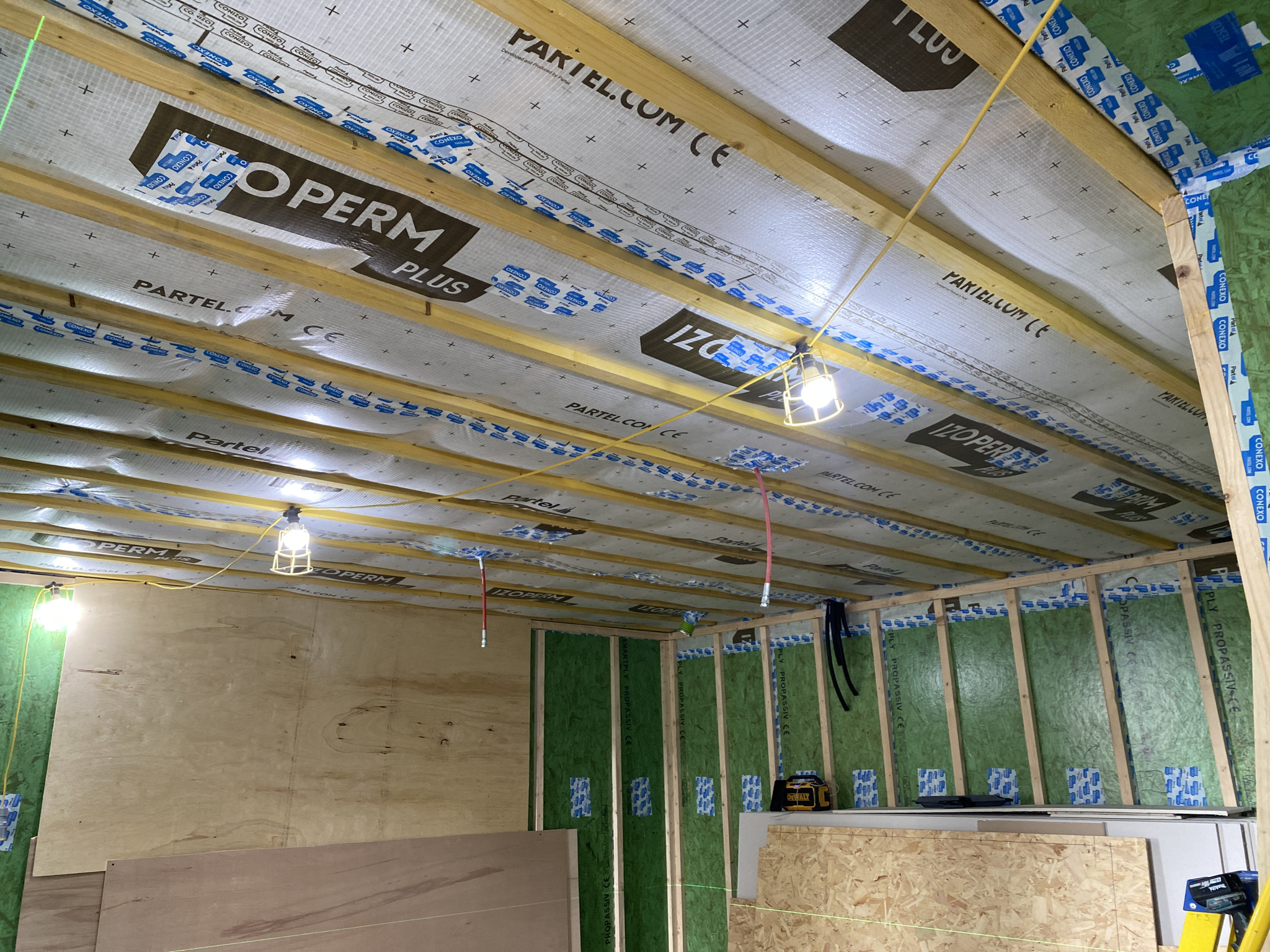

Chanmenie Posted December 16, 2023 Posted December 16, 2023 On 20/06/2023 at 22:57, Nickfromwales said: This is a pic of my current MBC TF project, and this shows the counter-battens that MBC installed, perpendicular to the joists above (hidden by the membrane but you can see where the membrane is quilted where it was first stapled to them). This extra 'bracing' is achieved just as simply as affixing 25x50mm counter-battens (larger of the 2 two common roofing battens) to the underside of the bottom chord. There's zero rocket-science Hi @Nickfromwales I’m going to batten my ceilings like this using 25x50 battens, do MBC fill in the ends where the battens meet the partition walls to support the ends of the ceiling plasterboard or just rely on the plasterboard on the walls to give the support.
Iceverge Posted December 16, 2023 Posted December 16, 2023 2 hours ago, Chanmenie said: Hi @Nickfromwales I’m going to batten my ceilings like this using 25x50 battens, do MBC fill in the ends where the battens meet the partition walls to support the ends of the ceiling plasterboard or just rely on the plasterboard on the walls to give the support. I would consider upping the batten size to 38*50 or 25*75mm as the smaller ones might split. On our ceiling we didn't use end noggins, just allowed the plasterboard to sail between battens. It was held up by a 20mm sand cement layer on the walls however. 1
Chanmenie Posted December 17, 2023 Posted December 17, 2023 26 minutes ago, Iceverge said: I would consider upping the batten size to 38*50 or 25*75mm as the smaller ones might split. On our ceiling we didn't use end noggins, just allowed the plasterboard to sail between battens. It was held up by a 20mm sand cement layer on the walls however. Graded roof tile battens should not split 1
