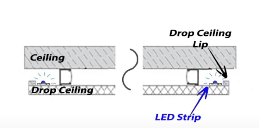

Thorfun Posted June 19, 2023 Author Posted June 19, 2023 afternoon all. I'm now thinking about a different dropped ceiling requirement. in the kids rooms we want to have the LED strips in a dropped ceiling look. e.g. I'm guessing this would be built something like this above the bedrooms is the loft space so there are 600mm centre attic trusses. I'm going to make the assumption that to get the light reflected I would need to board the trusses and then drop the ceiling, right? I'm also thinking that only a 50mm drop would be required? ceiling height is currently 2.4m so don't want to drop it too far really. so a 50mm MF bracket drop, then 9.5mm PB? I guess the other cheaper way to do this is to purchase LED coving profiles? something like this https://www.ultraleds.co.uk/u-shape-polymer-wall-coving.html and attach it 50mm/100mm down from the single skin of 12.5mm plasterboard? anyone have any suggestions/experience on how the best way to do this is? or have used the LED Coving profiles and what the effect is like compared to the dropped ceiling method?

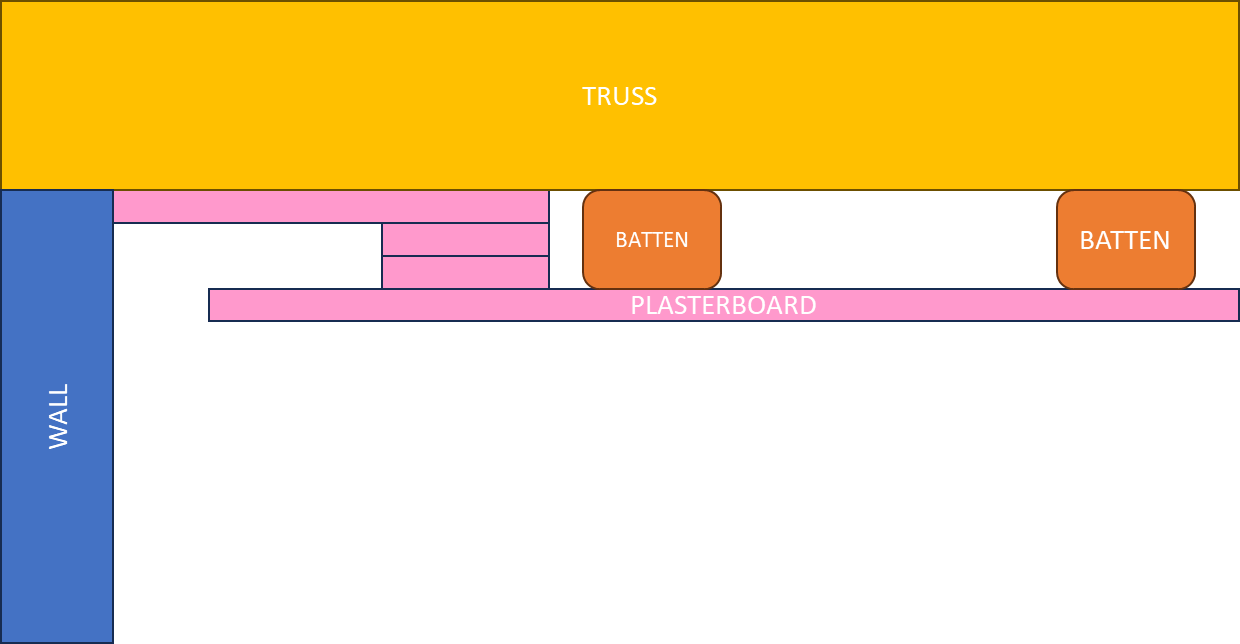

MortarThePoint Posted June 19, 2023 Posted June 19, 2023 6 hours ago, Thorfun said: above the bedrooms is the loft space so there are 600mm centre attic trusses. Is the loft living space? If it is, and the house is 3 storey, you will need this ceiling to be fire rated. That shouldn't rule out the battens, but you'll need to something neat with plasterboard (PB) to achieve a fire seal. Lots of strips of PB probably. Also check the fire properties of the LED strips as they may have a minimum distance to timber. PB in the way should solve that though. Something like the image below. If the plasterboard was 12.5mm then you could use 50mm x 38mm battens at 400mm c/c. If using thicker or thinner plasterboard, you could change batten thickness accordingly. Plasterboard strips can be screwed through with long PB screws, ensuring at least 25mm into timber. Also through the bottom most sheet and through the strips. Use a continuous bead of FireStop sealant between strips. You would probably want to use a plasterboard edge bead. No idea if this would meet regs, so you'll need to check that. Is there any indication as to how big the gap dimensions need to be.
Thorfun Posted June 19, 2023 Author Posted June 19, 2023 7 minutes ago, MortarThePoint said: Is the loft living space? If it is, and the house is 3 storey, you will need this ceiling to be fire rated. That shouldn't rule out the battens, but you'll need to something neat with plasterboard (PB) to achieve a fire seal. Lots of strips of PB probably. Also check the fire properties of the LED strips as they may have a minimum distance to timber. PB in the way should solve that though. Something like the image below. If the plasterboard was 12.5mm then you could use 50mm x 38mm battens at 400mm c/c. If using thicker or thinner plasterboard, you could change batten thickness accordingly. Plasterboard strips can be screwed through with long PB screws, ensuring at least 25mm into timber. Also through the bottom most sheet and through the strips. Use a continuous bead of FireStop sealant between strips. You would probably want to use a plasterboard edge bead. No idea if this would meet regs, so you'll need to check that. Is there any indication as to how big the gap dimensions need to be. loft is not habitable so no issues with fire rating. I like your drawing and was thinking of using 38mm x 50mm battens but was going to use 12.5mm plasterboard at 600mm centres. my only concern was the bit of plasterboard 'overhanging' at the end of the run by the wall. seems a bit flimsy to just have it like that without any support. like someone could just put their hand up and yank it down.

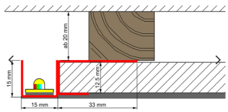

MortarThePoint Posted June 20, 2023 Posted June 20, 2023 There are some expensive profiles out there to do this. First link has an installation animation. ~£35/m seems steep to me, but may be the easiest way to go. https://www.darklightdesign.com/led-profilelement-dsl-profile/ https://www.ebay.co.uk/itm/273214350882 https://www.iluminize.com/en/shop/product/4604-led-drywall-profile-dsl-2m-long-for-floating-surfaces-with-a-substructure-363#attr= 1
Thorfun Posted June 20, 2023 Author Posted June 20, 2023 49 minutes ago, MortarThePoint said: There are some expensive profiles out there to do this. First link has an installation animation. ~£35/m seems steep to me, but may be the easiest way to go. https://www.darklightdesign.com/led-profilelement-dsl-profile/ https://www.ebay.co.uk/itm/273214350882 https://www.iluminize.com/en/shop/product/4604-led-drywall-profile-dsl-2m-long-for-floating-surfaces-with-a-substructure-363#attr= thanks for this. it is a nice solution albeit expensive but it does mean that the battens can be reduced to 25mm saving cost and ceiling height reduction and also plasterboard overhang which is something i was concerned about. i will investigate this solution!
MortarThePoint Posted June 20, 2023 Posted June 20, 2023 12 hours ago, Thorfun said: thinking of using 38mm x 50mm battens but was going to use 12.5mm plasterboard at 600mm centres With 12.5mm PB, I'd use battens at 400mm centres. Minimal extra cost/weight/time. 1
Thorfun Posted June 20, 2023 Author Posted June 20, 2023 1 hour ago, MortarThePoint said: There are some expensive profiles out there to do this. First link has an installation animation. ~£35/m seems steep to me, but may be the easiest way to go. https://www.darklightdesign.com/led-profilelement-dsl-profile/ https://www.ebay.co.uk/itm/273214350882 https://www.iluminize.com/en/shop/product/4604-led-drywall-profile-dsl-2m-long-for-floating-surfaces-with-a-substructure-363#attr= so i've done a little bit of quick research and i can't justify the cost of these profiles when i could just glue these https://www.ultraleds.co.uk/standard-aluminium-channel-178-in-white-3-metre-length.html to the top of the plasterboard, right? even with the extra £0.44 per meter for the 38mm battens i make that a total of about an extra £18 per room on battens. doesn't even touch the cost of the specialist profiles. i'm not just being tight here, what would the justification be to use those specialist profiles? maybe in an area like they show in their video where you can actually see the edge of the dropped ceiling, e.g. above a kitchen island, but in my scenario where the dropped ceiling will be against a wall no one is ever going to see up there.
