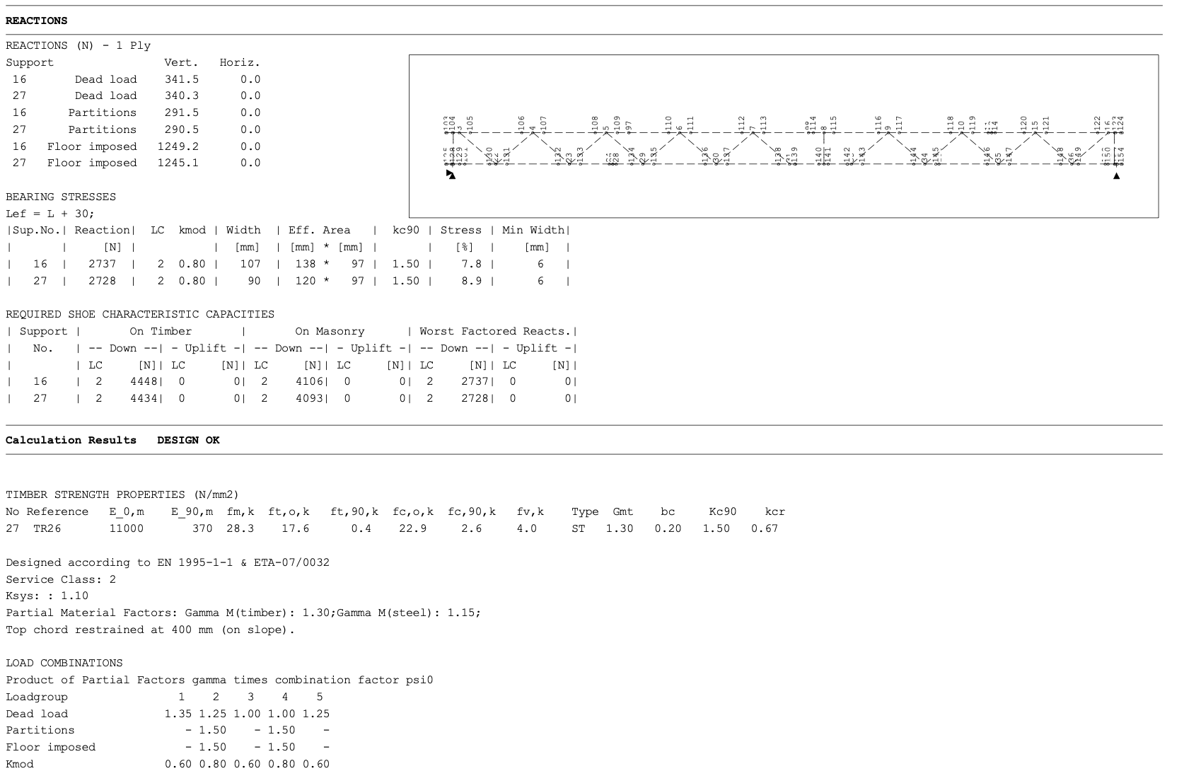

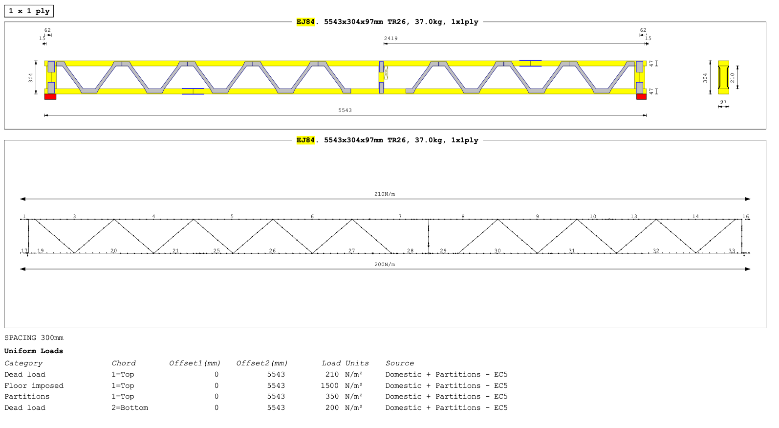

Thorfun Posted May 24, 2023 Author Share Posted May 24, 2023 right, more maths required as BG technical support had finished for the day when i tried calling. according to this data sheet the GL1 channels are 0.37kg/lm. i've calculated that i will need 18lm of the stuff. the room is 16.32m2 and the GL1 channels will be spaced at 400mm centres. anyone know how to calculate the downward force imposed on the bottom chord of the posi-joists per meter squared? 1 Link to comment Share on other sites More sharing options...
Thorfun Posted May 24, 2023 Author Share Posted May 24, 2023 5 minutes ago, Thorfun said: right, more maths required as BG technical support had finished for the day when i tried calling. according to this data sheet the GL1 channels are 0.37kg/lm. i've calculated that i will need 18lm of the stuff. the room is 16.32m2 and the GL1 channels will be spaced at 400mm centres. anyone know how to calculate the downward force imposed on the bottom chord of the posi-joists per meter squared? does this maths seem correct? 18lm x 0.37kg = 6.66kg / 16.32m2 = 0.41kg/m2 if so, that's nothing! and so with those maths the MF ceiling won't add any extra load i just need to figure out if i can double board with 12.5mm PB and not exceed the 200N/m2 maximum load of the bottom chord. maybe i should post this in boffins corner so all the boffins see it? otherwise it's just me and @pocster bumbling through as usual. 1 1 Link to comment Share on other sites More sharing options...

SteamyTea Posted May 24, 2023 Share Posted May 24, 2023 Just run it though a beam calculator and see what the deflection is. Link to comment Share on other sites More sharing options...
Thorfun Posted May 24, 2023 Author Share Posted May 24, 2023 23 minutes ago, SteamyTea said: Just run it though a beam calculator and see what the deflection is. The guy from the posi place said that the joist could fail if the load exceeds 200N/m2 . That sounds scary. I might have been able to find the calculations used by the TF company though so will send that off to them and see what they say. it’s a shame Flight Timber went belly up for all those that lost money with them and also as they were always really quick to respond to queries like this. I don’t have that resource anymore and so I’m left to my own devices. im not sure what the beam calculator will show as I don’t believe it’s deflection that’s the issue here as the top chord load is 2060N/m2 and we’re designed for 8mm deflection. But that’s the top chord. The bottom chord is designed for only 200N/m2 Link to comment Share on other sites More sharing options...
Thorfun Posted May 24, 2023 Author Share Posted May 24, 2023 this is from the document showing the joist design I managed to find. Link to comment Share on other sites More sharing options...
Thorfun Posted May 24, 2023 Author Share Posted May 24, 2023 and this. anyone able to make heads or tails of it? Link to comment Share on other sites More sharing options...
Thorfun Posted May 24, 2023 Author Share Posted May 24, 2023 actually there are a lot more calculations that I posted above. here's a pdf for the joists in question. joist_calcs.pdf it's all Greek to me. I'm hoping someone can tell me what it all means! Link to comment Share on other sites More sharing options...
SteamyTea Posted May 24, 2023 Share Posted May 24, 2023 (edited) 17 minutes ago, Thorfun said: it's all Greek to me. I'm hoping someone can tell me what it all means! One for @Gus Potter I think. Had a quick look, Cord 1 and 1 (top and bottom) have similar dead loads at 210 and 200 N.m-2, so that is 410 N.m-2 for flooring and ceiling. The there is the imposed load, which I think is point loading, at 1500 N.m-2, which is 159 kg.m-2. My knowledge is lacking in that I do not know for definite what the imposed load it. Seems from a very quick internet search that they are considered equal to impact loads. https://eng.libretexts.org/Bookshelves/Civil_Engineering/Structural_Analysis_(Udoeyo)/01%3A_Chapters/1.02%3A_Structural_Loads_and_Loading_System Edited May 24, 2023 by SteamyTea 1 Link to comment Share on other sites More sharing options...
Thorfun Posted May 24, 2023 Author Share Posted May 24, 2023 1 hour ago, SteamyTea said: One for @Gus Potter I think. Had a quick look, Cord 1 and 1 (top and bottom) have similar dead loads at 210 and 200 N.m-2, so that is 410 N.m-2 for flooring and ceiling. The there is the imposed load, which I think is point loading, at 1500 N.m-2, which is 159 kg.m-2. My knowledge is lacking in that I do not know for definite what the imposed load it. Seems from a very quick internet search that they are considered equal to impact loads. https://eng.libretexts.org/Bookshelves/Civil_Engineering/Structural_Analysis_(Udoeyo)/01%3A_Chapters/1.02%3A_Structural_Loads_and_Loading_System Thank you. I had a quick read of the link and will look into it in more detail tomorrow. Link to comment Share on other sites More sharing options...
