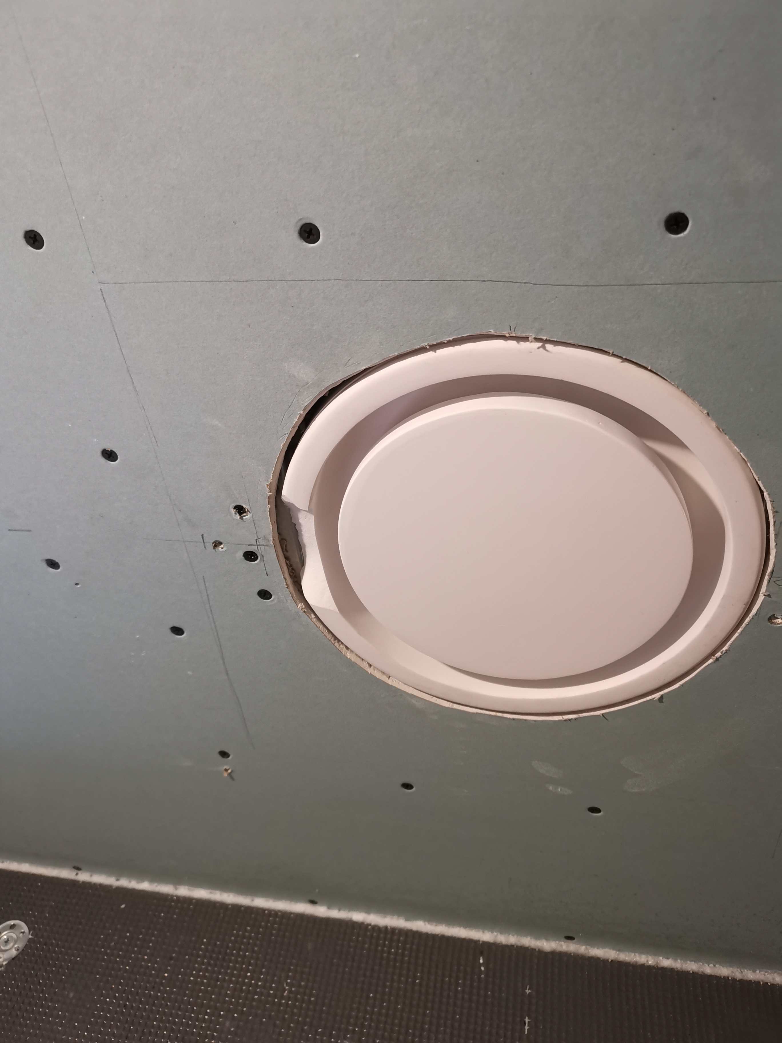

    annoyingly i didnt take any photos of that, but it was pretty easy. Im no expert plasterer and i was able to do it. When i had my opening i used CT1 on the tabs above the plasterboard before screwing

Bit of a kick in the balls, when I was screwing up my plaster in grill it cracked a bit off. Not a chance I'm buying another for £70 a go, so what adhesive is best for this to stick the bit back in before I scrim tape and multi over the ceiling?
CT1? plasterboard adhesive?

If you use superglue, do NOT use too much as it won't sand back as quickly as the plaster / paint around it.
As it's plaster you could prob happily just use neat PVA, with the benefit of being able to wipe this with a wet cloth to clear away excess when wet.
Remember to stop the scrim tape well away from the edge as you defo do not want to catch that when tidying up after the plasterer with some sandpaper; I doubt they'll get them A1 so expect to have some faffing to do before paint.
Also, don't forget to take the centres off and remove the foam restrictor before (and put them bloody safe so you don't need to repair those!!).

PVA eh? Any problems with it being above the shower though and reactivating? I guess not once it's been plastered and painted but thought I'd ask.
You're supposed to paint over these after they've been "finessed" ;) Raw plaster (of Paris) is not meant to be left on show afaik.
However, in real life, air will be continuously flowing here 24/7/365, so is it ever actually going to remain 'wet'? A: "No".

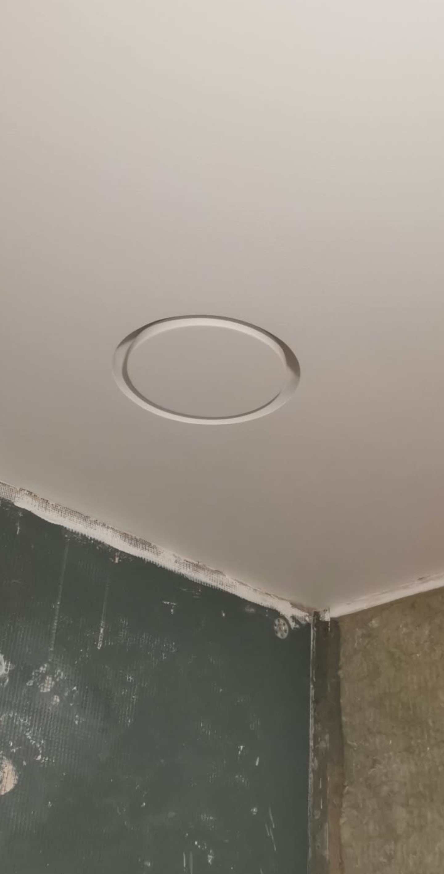

Bit quiet in here recently, so for your viewing pleasure...
Still need to paint the lid but these things look the b*ll*cks.

Use your words lol.
“The dogs bollocks” ;).
When you see these, and then the standard valves you really do think “why did I fit these cheap ones in my beautiful new home?”.
There are some very nice intermediate options vs the ‘service station toilet’ ones……. 🤢🤮 so look at your options before buying; some which don't need the plaster-in skillset / time / money.
These are a doddle to do after the 1st ones in.

As the cover is plaster of paris I assume it's mega thirsty when I paint it. Just go with the same process, mist coat then the Permawhite over the top?
Roller twice with trade white, and get your ass to the pub ;)

We still need to choose our valves (and until we do can't cut the plenums to height). Plaster in do look great but are they hard to get perfect?
@Super_Paulie how tricky was plastering them in? I'd assumed there would be some sort of bead to plaster up to, to help keep the perfect roundness, but can't see any on your earlier unfinished pic.
