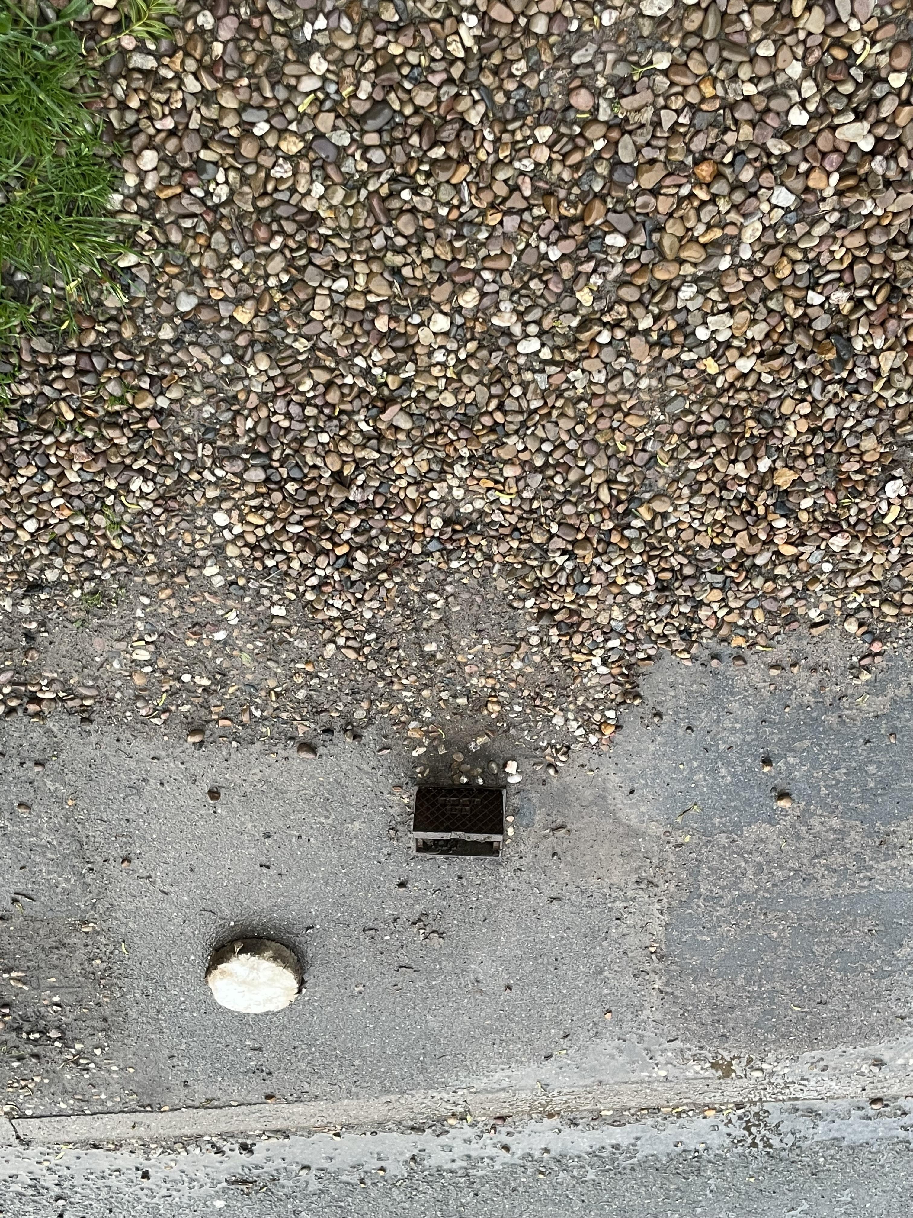

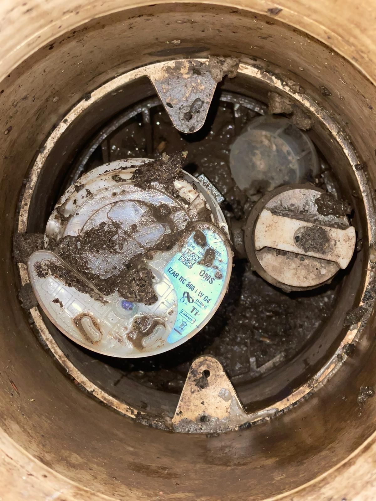

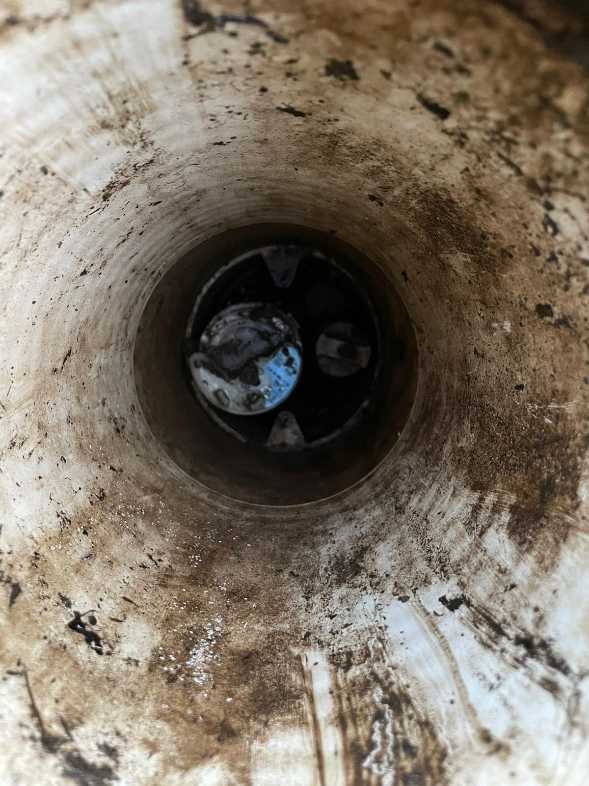

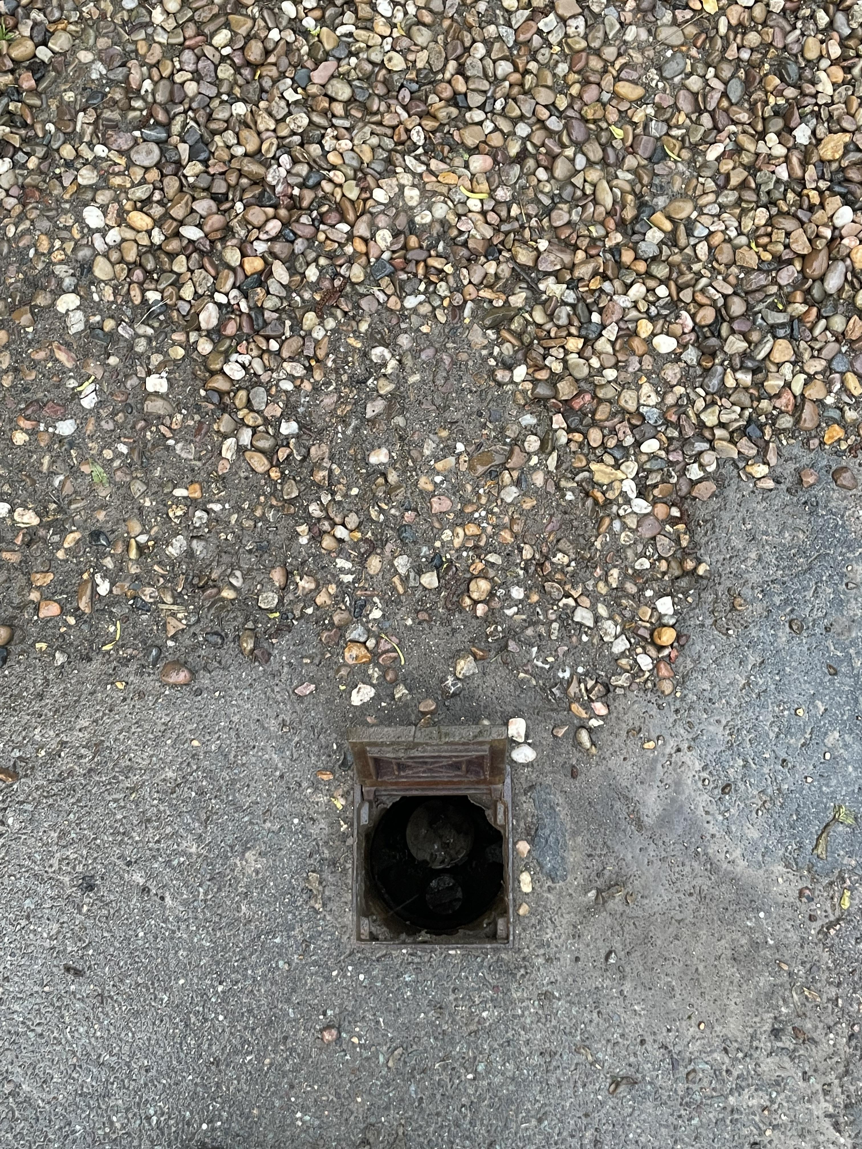

richo106 Posted May 10, 2023 Posted May 10, 2023 Hi all I need to increase the water pipe size that goes into my property, currently there is a 15mm copper pipe into my house My plan is to excavate back to the main water valve which is located in the pavement, I have attached a couple of photos of the stop valve (not the best photos) and my plumber seems to think it looks quite new-ish and they might of replaced a small section onto my land so I could join onto that. Is there anyway of finding this out through Severn Trent at all? What is the likely material of the pipe coming off the valve? And what is the best way off trying to locate the pipe just on my property? Should I be able to tell which way the pipe leaves the valve? And if i need to dig up the pavement to get onto the valve, do i need to contact the local council or anything? Any advice or any information would be much appreciated Many Thanks
ProDave Posted May 10, 2023 Posted May 10, 2023 The pipe will leave in line with the valve and water meter so just about horizontal in the first picture. I would expect it to be 25mm mdpe Dig down on that line at the edge of your property and hopefully you will find mdpe. Worst case there is a joint to something smaller under the pavement. If you do need to dig up the pavement you need a road opening licence from your council and you must employ a contractor with a minor streetworks permit. Dig in your own garden as close to the pavement as possible to see what you have. 1

PeterW Posted May 10, 2023 Posted May 10, 2023 48 minutes ago, richo106 said: there is a 15mm copper pipe into my house 15mm copper will be connected to something else as it’s not used underground. Where does it appear ..? 26 minutes ago, ProDave said: Dig down on that line at the edge of your property and hopefully you will find mdpe. That’s what you need to do - carefully..!
richo106 Posted May 10, 2023 Author Posted May 10, 2023 32 minutes ago, PeterW said: 15mm copper will be connected to something else as it’s not used underground. Where does it appear ..? That’s what you need to do - carefully..! It appeared through old concrete kitchen floor, I have now moved it on to the outside on the property so can be used by the builders etc I have traced it back 2 feet from the house and still in copper. I don't know if its worth tracing a bit more back (25m back to the stop valve) or just try and find it at the land boundary and excavate a new trench for some new mdpe Can I lay mdpe directly in a trench or is best to cover in sand etc? Many Thanks

Conor Posted May 10, 2023 Posted May 10, 2023 I worked on various projects over the years involving mains replacement, new meter connections. I'm 99% sure there will be a 25mm MDPE tail coming off that meter box and connect to your private supply within about 500-1000mm of the box. 1
richo106 Posted May 10, 2023 Author Posted May 10, 2023 Thank you all for the comments, I might go for the ducting option. I will ensure it is at least 750mm deep My civils guy can dig the trench one day, Ill lay the ducting and install the MDPE and then he can back fill and tidy all up the day after
richo106 Posted May 10, 2023 Author Posted May 10, 2023 This is the location of the meter in relation to my boundary/drive I will start to excavate about 700mm away from the valve to see if I can locate it

jayc89 Posted May 15, 2023 Posted May 15, 2023 On 10/05/2023 at 21:31, richo106 said: Looks similar to mine, dig down to ~ 800mm on your side, find your existing supply and follow it back. I found it easiest to rake out with the end of a crow bar, kept the opening pretty small.
