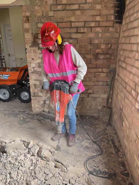

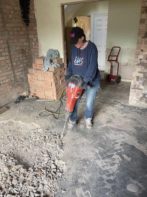

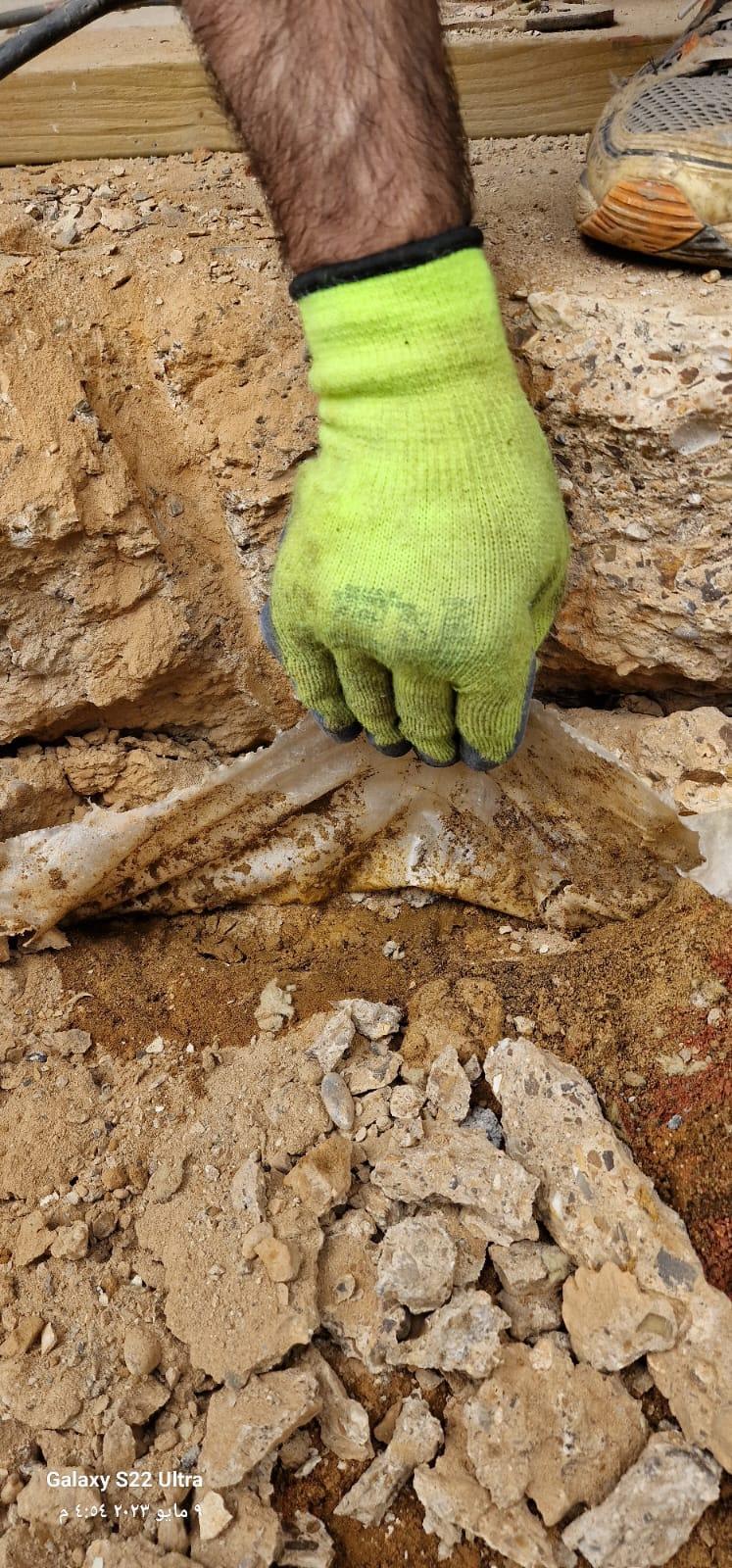

Olf Posted May 7, 2023 Share Posted May 7, 2023 Very doable, but watch for: - what is your current floor construction? Make a test dig in a place you can easily fill in if you decide not to progress. I made 20x20cm hole under fireplace hearth and got good idea of the scale of a challenge - BC: agree what floor buildup is acceptable so you know exactly how deep you have to dig. I ended up with 150mm hardcore+50mm lean concrete blinding (what BC reqested and pi$$ed me off)+150mm PIR+100mm slab with rebar and UFH: total of 450mm meaning digging 350mm below existing slab. Don't think about reducing insulation thickness to save digging: it is not a passivhouse, your floor temperature will be at least 30°C and the last thing you want to do is to send too much heat into the ground. - test hole should also give you idea about soil condition: some are easier to excavate, some (clay...) are proper pain. - it can be done by hand, great exercise for back muscles - plan timing: do it after the extension is done and the area leading to entrance should be the last and done like F1 pitstop, otherwise life is challenging for few days 1 Link to comment Share on other sites More sharing options...
Kai casswell Posted May 7, 2023 Share Posted May 7, 2023 I've done it as well, but we weren't living in the house and we could get a micro digger in for bits. We also hire a little motorised dumper. We kept all the waste and crushed it down to hardcore. I also forced my family to help: 1 2 Link to comment Share on other sites More sharing options...

Sophiae Posted May 9, 2023 Author Share Posted May 9, 2023 (edited) @Olf Thank you so much. I can see it all clearly now. Yes, I am very much counting on BC to visit ASAP and help me figure out the final verdict on the floor for the original build. I feel excited knowing this is doable, and seeing your pictures makes it all coming true for me soon too. @jayc89 Thank you for the video. The space is massive compared to mine, but I see what you mean. I will definitely try as much as I can to reuse everything I dig out, if not for the base, the for the garden like you suggested. I have a slope which I am not happy about in the front and in the garden so will use to level both if possible. Edited May 9, 2023 by Sophiae Link to comment Share on other sites More sharing options...

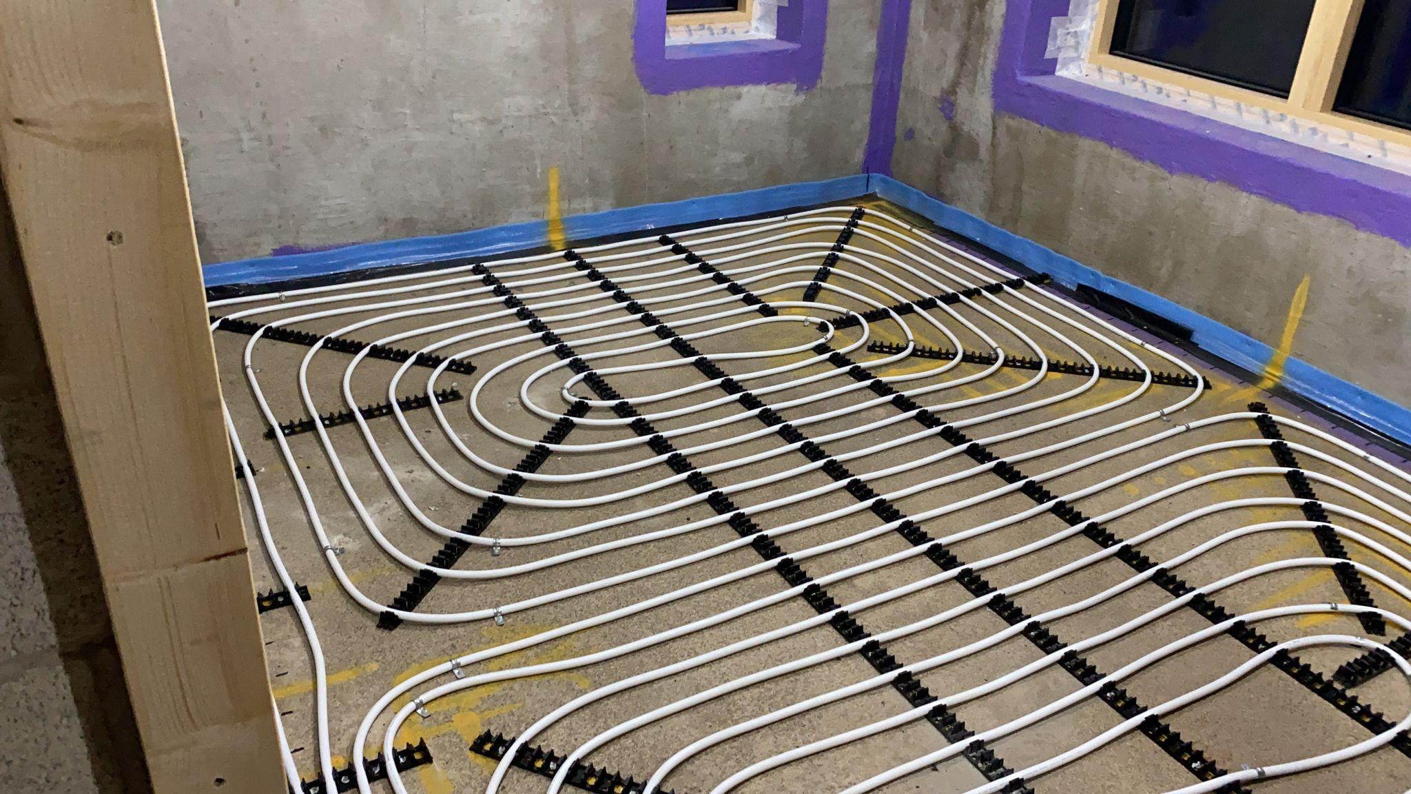

Sophiae Posted May 9, 2023 Author Share Posted May 9, 2023 Another follow up question if I may. Do I need a screed on top of the Concrete or 150mm of concrete (skipping the whole screed layer) would be enough? PIR insulation boards above or below concrete work better when using UFH? Link to comment Share on other sites More sharing options...
Dave Jones Posted May 9, 2023 Share Posted May 9, 2023 150mm hardcore (100 absolute minimum), 100mm celotex or 150mm EPS (cheaper), 75mm screed. Link to comment Share on other sites More sharing options...

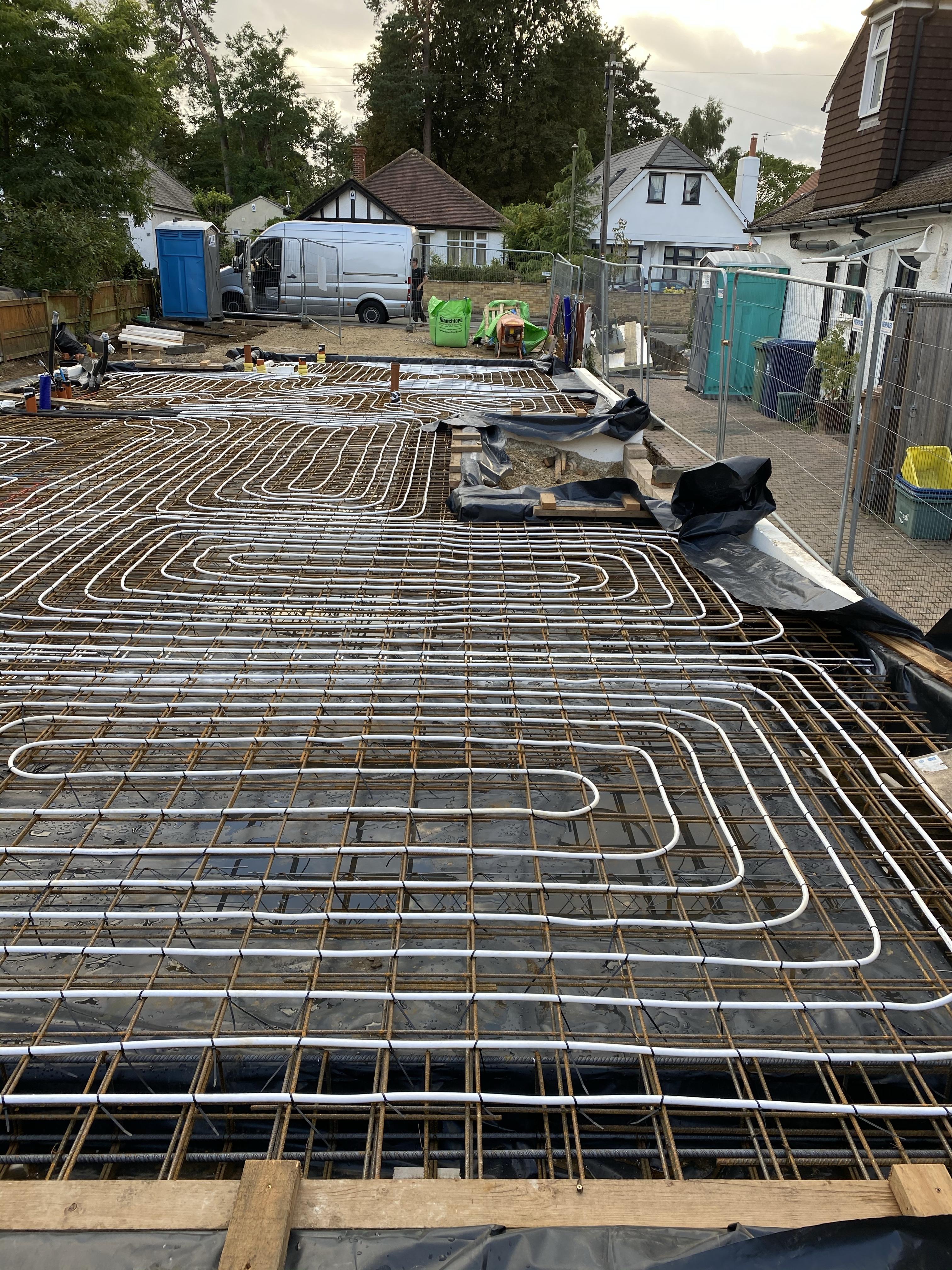

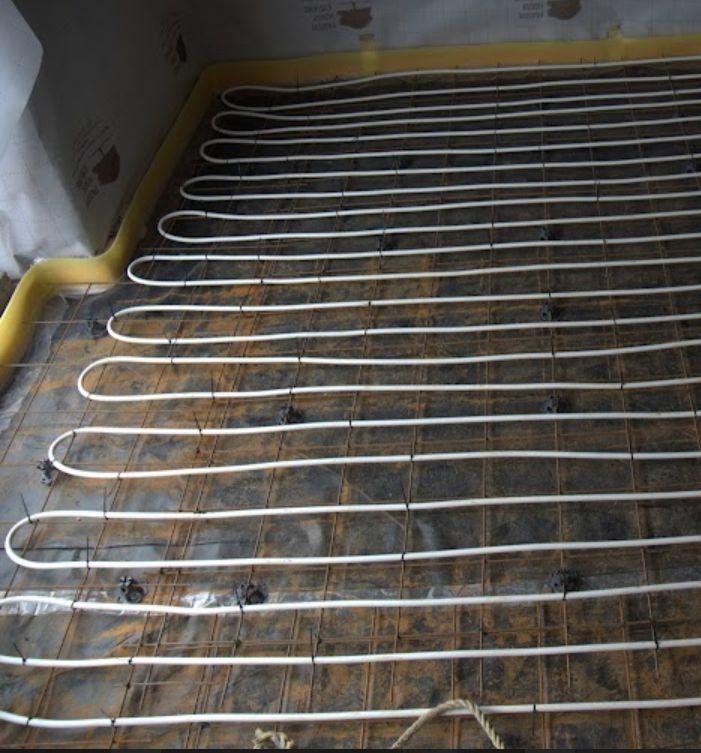

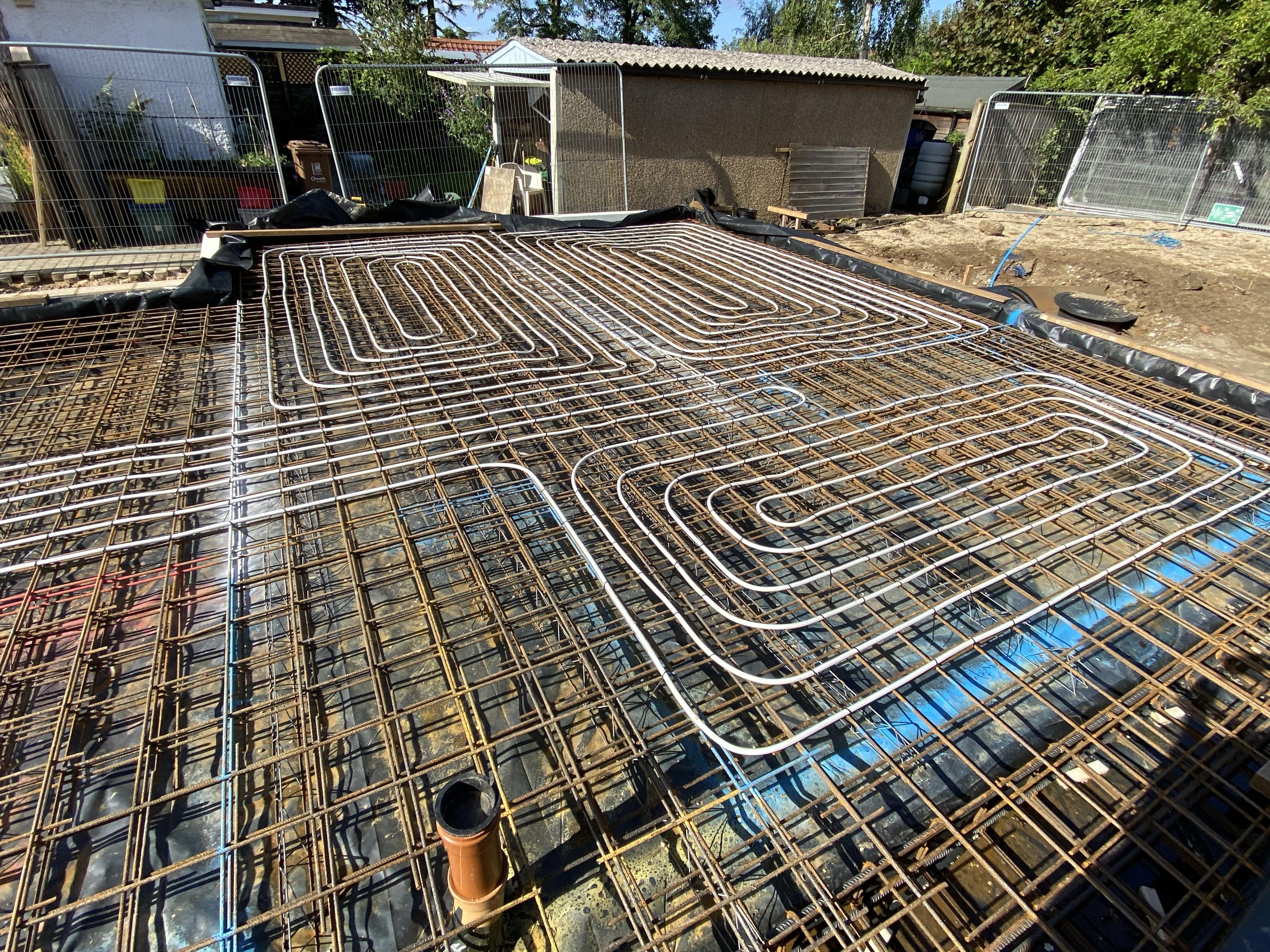

Nickfromwales Posted May 9, 2023 Share Posted May 9, 2023 On 08/05/2023 at 10:19, Sophiae said: Would it be possible to send me some pictures of your UFH? I am interested in seeing how you fit it in. The 1st 2 images are pipes in the concrete slab, cable tied to the steel mesh, and the 3rd image is of pipes laid on a slab which then got screeded over. 1 Link to comment Share on other sites More sharing options...

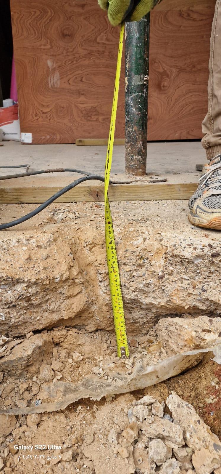

Sophiae Posted May 27, 2023 Author Share Posted May 27, 2023 Good evening everyone I pray you are all having a good weekend. I’ve been trying to get more information on my existing floors and just found out that the property was built between 1965-1972 and the solid floors (concrete) are assumed to have zero insulation. Now, how would I know what is the depth of that concrete slab other than dig lol ;0) If I dig, it would be placing 150mm rigid PIR then UFH and 65-75 screed. Would that be reasonable? What do I do about the DPM? Link to comment Share on other sites More sharing options...
Olf Posted June 9, 2023 Share Posted June 9, 2023 On 27/05/2023 at 22:54, Sophiae said: the property was built between 1965-1972 and the solid floors (concrete) are assumed to have zero insulation. Now, how would I know what is the depth of that concrete slab other than dig It is probably 100mm, but that does not change you situation a lot: you need to dig up enough for the new structure to finish at existing floor level. On 27/05/2023 at 22:54, Sophiae said: If I dig, it would be placing 150mm rigid PIR then UFH and 65-75 screed over 100-150mm slab over 50mm blinding over 100-150mm compacted hardcore. This much digging is necessary. By the way, using PIR is typically the most cost effective way, as offets cost of digging and disposing against more expensive insulation. However, there are cases (soil easy to work with, can be used locally eg to level the outside) where using EPS (even though 250-300mm needed) is better choice. Unlikely here, but do your maths. On 27/05/2023 at 22:54, Sophiae said: What do I do about the DPM? Over the blinding layer (under insulation), binded to the existing DPC. That is likely some bitumen stuff, so Synthaprufe/Black Jack type of liquid membrane to link old and new together. Also another layer (not DPM as such, can be thinner, but also can use leftovers of DPM if enough left) over the insulation so screed does not flow through any missed gaps and reduces to 0 risk of any chemical reaction with aluminium film. 1 Link to comment Share on other sites More sharing options...
Sophiae Posted June 11, 2023 Author Share Posted June 11, 2023 On 09/06/2023 at 09:06, Olf said: It is probably 100mm, but that does not change you situation a lot: you need to dig up enough for the new structure to finish at existing floor level. over 100-150mm slab over 50mm blinding over 100-150mm compacted hardcore. This much digging is necessary. By the way, using PIR is typically the most cost effective way, as offets cost of digging and disposing against more expensive insulation. However, there are cases (soil easy to work with, can be used locally eg to level the outside) where using EPS (even though 250-300mm needed) is better choice. Unlikely here, but do your maths. Over the blinding layer (under insulation), binded to the existing DPC. That is likely some bitumen stuff, so Synthaprufe/Black Jack type of liquid membrane to link old and new together. Also another layer (not DPM as such, can be thinner, but also can use leftovers of DPM if enough left) over the insulation so screed does not flow through any missed gaps and reduces to 0 risk of any chemical reaction with aluminium film. Thank you so much @Olf. I am starting with the extension first as I need a place to sort of use whilst I embark on the rest of the property. I very likely will need to go as deep as I need to get it all level with the extension and guarantee the 150mm insulation. The plan is to also hire a crusher so that I can recycle everything that comes out from the concrete and add extras rather than use skips and buy all new. If you don’t mind I will keep writing here seeking further advice as I start. Link to comment Share on other sites More sharing options...
