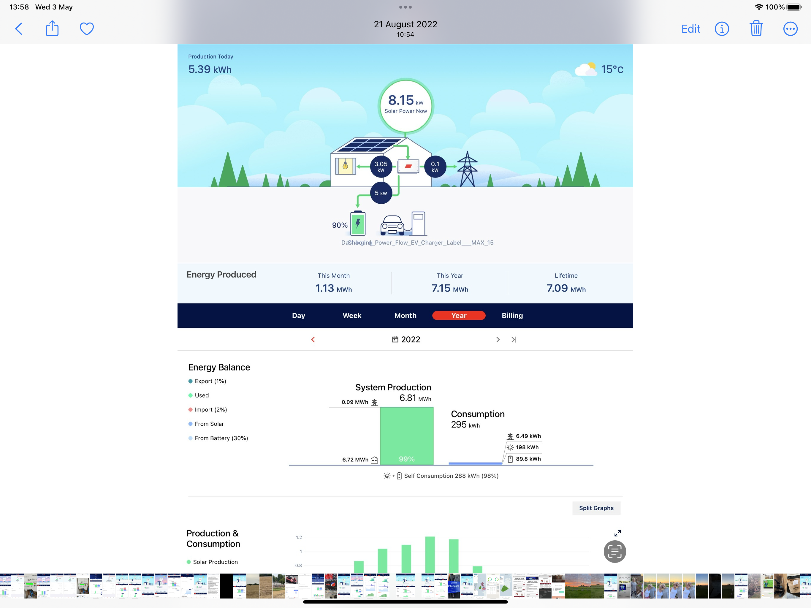

Johnnyt Posted May 2, 2023 Posted May 2, 2023 I at times export at nearly 252 volts causing my neighbours EV charger to trip out for overvoltage. The transformer is 150m away with only 2 properties fed of a 185mm cable . My array is 10kWp via a 6kW inverter. I remember when looking at PV several installers tried to sell me "witchcraft" voltage optimisers. Could these be not used to regulate voltage for export? 2
SteamyTea Posted May 3, 2023 Posted May 3, 2023 17 hours ago, Johnnyt said: I at times export at nearly 252 volts causing my neighbours EV charger to trip out for overvoltage. The transformer is 150m away with only 2 properties fed of a 185mm cable . My array is 10kWp via a 6kW inverter. Not surprising that it hits the upper voltage limit when the modules and inverter are that mismatched.
Carrerahill Posted May 3, 2023 Posted May 3, 2023 (edited) 17 hours ago, Johnnyt said: My array is 10kWp via a 6kW inverter. I can see the benefits of this in the winter, but it seems quite a mismatch at about 66% over, typically PV oversizing is usually about 20% - this is not an industry standard but a common figure quoted in the industry. I would expect on a good sunny day you will be clipping a lot (lots of heat in the inverter - not good for it) and wasting a load of generated power. I think I would be upgrading your inverter to about an 8kW unit - get one with a reasonably low start voltage and you won't lose out on much on a grey day. Edited May 3, 2023 by Carrerahill
Johnnyt Posted May 3, 2023 Posted May 3, 2023 It’s solar edge dc coupled to 10kWh battery soon to be 20kWh. Excess PV goes uninverted direct to battery. SE allow 200% oversize with battery. I’ve seen the array generate 8kW with 5kW going to battery and balance to serve house load. I also have dhw divert This is from last August. Quite a handy feature of dc coupling. 1
Dillsue Posted May 7, 2023 Posted May 7, 2023 On 03/05/2023 at 13:30, Carrerahill said: I can see the benefits of this in the winter, but it seems quite a mismatch at about 66% over, typically PV oversizing is usually about 20% - this is not an industry standard but a common figure quoted in the industry. Solaredge allow significantly more oversizing than 20% with a 3.6kw SE3680H accepting up to 5.7kw DC input which is 55% oversizing. Split the panels over differing compass points and you can have much more.
