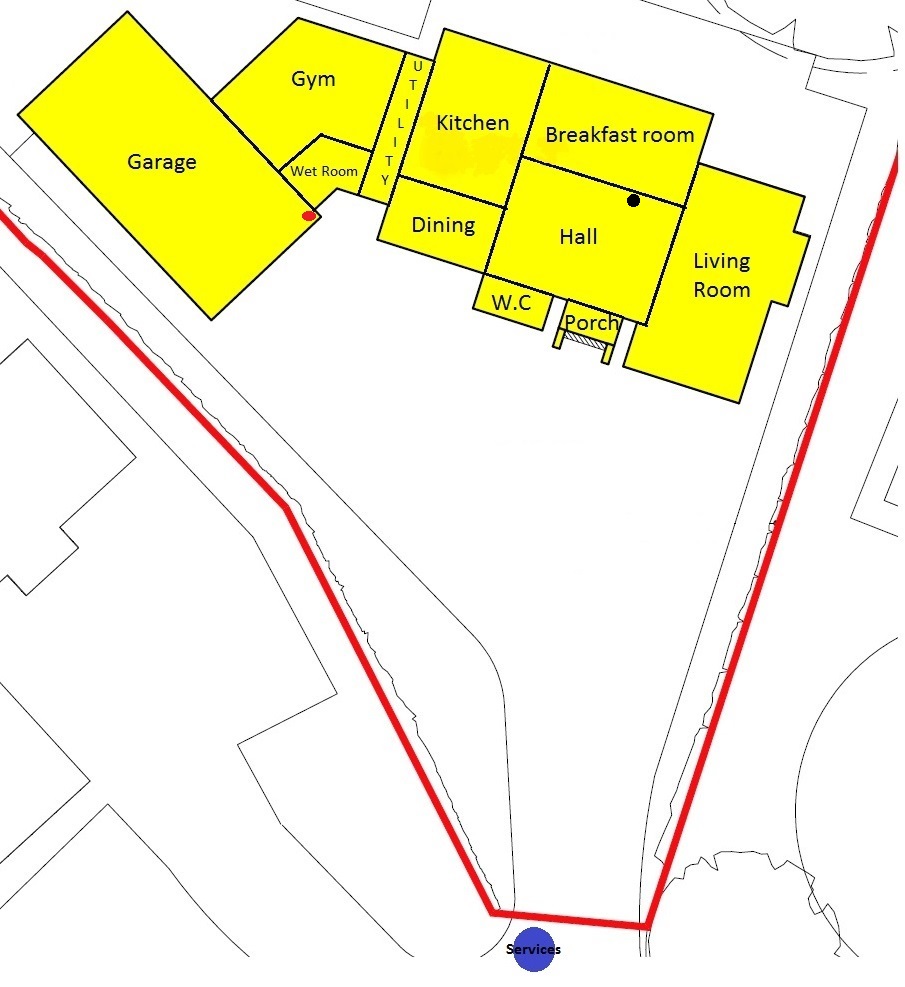

Vijay Posted August 5, 2017 Share Posted August 5, 2017 Afternoon, Will be at the stage of digging the drainage and service pipework this week and still haven't got it clear in my head where to run the services too. I hate the outside meter boxes, so I believe I am allowed to have the electricity meter internally, as long as it's on an external wall. I'm thinking of putting it in the garage where the red dot is on the attached layout. I could also put it in the porch if needs be but I think they're a bit of an eye sore. I have yet to confirm where I can fit the gas connection (they have been a nightmare getting back to me), but I'm hoping I will be able to fit it internally (especially with smart meters). I though of running the water pipe to either the garage or the utility room? Where would I run the BT ducting to?? The distance from the service point (blue dot) to the garage is approx 34m and to the front of the house if approx 25m, so would it be OK to have direct pipe runs? I will also have an understair area of approx 1.2m wide by 2m long with a good head height (black dot in hall) where I thought of putting the UFH manifolds, so maybe meters or CU boxes could be in there? Anything else I've not thought of? Link to comment Share on other sites More sharing options...
Ferdinand Posted August 5, 2017 Share Posted August 5, 2017 (edited) You do not want to run anything where you will need to dig up your drive or 50k landscaped garden for any reason. I have just just negotiated an easement for a landlocked property and we put it approx 300mm in from the fence along the obvious location at the back of a wide flower border. And you you want a spare duct or two, for obvious reasons. F Edited August 5, 2017 by Ferdinand Link to comment Share on other sites More sharing options...
RichS Posted August 5, 2017 Share Posted August 5, 2017 Could you not build a "cupboard" and put all the meters in remote cabinets just inside the boundary. You can then run the cabling/gas pipe to where it suits best. Where I am the meters have got to be able to be accessed without entry to the dwelling, so certainly no inside meters, may well be different for your area though. Link to comment Share on other sites More sharing options...
Vijay Posted August 5, 2017 Author Share Posted August 5, 2017 But what's the realism of having to dig up the drive as long as drawstrings are left in? For what reason would it need to be done? Gonna run an extra 2 or 3 ducts for electric cable/lighting/intercom for front gate Not overly keen on an external cupboard but certainly better than meter boxes! 1 Link to comment Share on other sites More sharing options...
Ferdinand Posted August 5, 2017 Share Posted August 5, 2017 No idea what the reason might be :-), but I sure that one will turn up eventually if we don't consider it . Spare ducts is a good mitigation strategy. I think I am in favour of putting services under loose laid paved paths on gravel trenches. For me it is probably paramount to be able to get to everything without disturbing too much else. In our last house we had a whole area .. perhaps 250 sqm (out a of about 2acres) ... of our garden that was saturated for years, and the corner of the next field was the same. We eventually sold off the neighbouring bungalow, and the Fred Dibnah style chap who bought it dug the deep foundations and sunken floor for a gargantuan engine shed in that same area with his JCB, which then filled up with water too like a lake or Texan swimming pool. Eventually he excavated the post war sweep driveway at the front, which was about 400mm of washboard concrete, and found no fewer than THREE leaks in the water pipe the supplier side of the meter that we measured at several litres per minute, and had been running like that for over a decade. God knows what the bills would have been if it were on the house side of the meter and Severn Trent had no leak liability capping scheme. Ferdinand Link to comment Share on other sites More sharing options...

Vijay Posted August 5, 2017 Author Share Posted August 5, 2017 So any suggestions where water and BT should be ducted to? I assume BT would be the hallway and water could be kitchen/utility or garage? Link to comment Share on other sites More sharing options...
PeterW Posted August 5, 2017 Share Posted August 5, 2017 BT will run to your master socket - beware that this can sometimes mean they terminate at a point and you need to put the ADSL filters at every location past that point. I think @Bitpipe had a similar issue and resolved it quite neatly. Link to comment Share on other sites More sharing options...

Jeremy Harris Posted August 6, 2017 Share Posted August 6, 2017 9 hours ago, PeterW said: BT will run to your master socket - beware that this can sometimes mean they terminate at a point and you need to put the ADSL filters at every location past that point. I think @Bitpipe had a similar issue and resolved it quite neatly. The new master sockets get around the need for ADSL filters, but do mean that your modem or modem/router has to be co-located with the master socket (it's good practice to do this anyway). Just make sure that the guys install a MkIII master socket, as that has a built in VDSL/ADSL filter, so all the extensions are free of the broadband signal. In our case (we have fibre to the cabinet, FTTC, broadband) I fitted the OpenReach VDSL modem on the wall next to the master socket, and powered it using power over Ethernet (PoE), so no power supply was required for it at the master socket end. I ran Cat 6 cable to a point next to the master socket, with that cable running back to the PoE injector and the WiFi router. The router connects to a switch that then runs all the other wired network connections in the house. Worth thinking about where you are going to have network connections in the house, and where you want to put the modem/router, as that can have a bearing on where you put the master socket. Link to comment Share on other sites More sharing options...
Oz07 Posted August 6, 2017 Share Posted August 6, 2017 Don't want a boundary box with gas if you can avoid. The governor after the meter restricts the flow or pressure I believe which means big pipe size to appliances if far away (could be wrong here @Nickfromwales). Also that flexible gas pipe costs a fortune! Far better to get it as close to house and appliances as poss using the 41m or so that national grid provide at subsidised rate. Link to comment Share on other sites More sharing options...

Vijay Posted August 6, 2017 Author Share Posted August 6, 2017 So JSHarris has has BT master socket in the utility room (which I never though of). Did you just run the ducting to there and in through the floor or did BT have any say in the matter? Link to comment Share on other sites More sharing options...
Jeremy Harris Posted August 6, 2017 Share Posted August 6, 2017 4 minutes ago, Vijay said: So JSHarris has has BT master socket in the utility room (which I never though of). Did you just run the ducting to there and in through the floor or did BT have any say in the matter? Yes, I ran the ducting in there, as it seemed an out of the way place to stick all the odds and ends that I didn't want on show in the main part of the house. On that bit of wall there is the power for the ASHP, the ASHP command unit and the thermostat receivers for the wireless thermostats. Underneath the work surface that's below that photo is the UFH manifolds and controls, with a space for dirty boots and shoes in front of it (this is right by the back door). Link to comment Share on other sites More sharing options...
PeterW Posted August 6, 2017 Share Posted August 6, 2017 1 minute ago, JSHarris said: Yes, I ran the ducting in there, as it seemed an out of the way place to stick all the odds and ends that I didn't want on show in the main part of the house. @JSHarris out of curiosity what ducting did you use ..?? I'm considering that I could get a duct to my comms room relatively easily from the external wall so BT would just need to pull his cable through. Link to comment Share on other sites More sharing options...
Jeremy Harris Posted August 6, 2017 Share Posted August 6, 2017 5 minutes ago, PeterW said: @JSHarris out of curiosity what ducting did you use ..?? I'm considering that I could get a duct to my comms room relatively easily from the external wall so BT would just need to pull his cable through. My very helpful local OpenReach engineer supplied a load of free Duct56, hockey stick bends, cast iron boxes etc. This was just cast into the slab alongside all the other stuff, you can just see all the ducts coming up at the far corner of the slab: Link to comment Share on other sites More sharing options...
PeterW Posted August 6, 2017 Share Posted August 6, 2017 I was thinking about running 25mm black duct for him to run the cable in, and then terminating it at a closed round box or similar at either end. I do want to drill the wall where it goes though - the one monkey I'm not looking forward to is the Sky engineer ....... Link to comment Share on other sites More sharing options...
