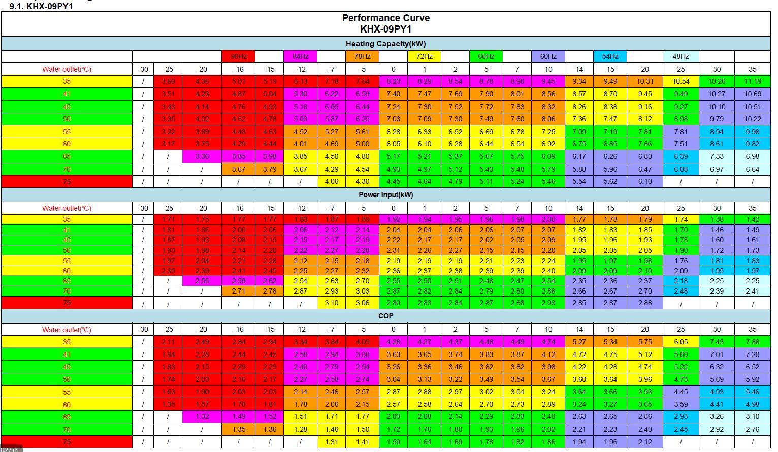

ZoomIRE Posted November 2, 2023 Share Posted November 2, 2023 (edited) On 01/10/2023 at 12:51, sharpener said: They don't seem to have any representation in the UK atm https://kaisai.com/where-to-buy. There is a Company in Ireland that sells the Cooper and Hunter version same heat pump. They also sell into UK market if you want there details PM me. I have a 9kw running for the last year being working 100% Edited November 2, 2023 by ZoomIRE Add Youtube 1 Link to comment Share on other sites More sharing options...
ZoomIRE Posted November 2, 2023 Share Posted November 2, 2023 Here is the performance details it maybe of help Link to comment Share on other sites More sharing options...
Dan F Posted November 2, 2023 Share Posted November 2, 2023 3 hours ago, ZoomIRE said: Here is the performance details it maybe of help Need my sunglasses to read that!! Link to comment Share on other sites More sharing options...
ZoomIRE Posted November 2, 2023 Share Posted November 2, 2023 2 hours ago, Dan F said: Need my sunglasses to read that!! Sorry for the colours just trying to help thats the way the manufacture present it I agree colourful 🙂 1 Link to comment Share on other sites More sharing options...
sharpener Posted November 3, 2023 Author Share Posted November 3, 2023 On 02/11/2023 at 09:50, ZoomIRE said: There is a Company in Ireland that sells the Cooper and Hunter version same heat pump. They also sell into UK market if you want there details PM me. I have a 9kw running for the last year being working 100% Thanks for following that up! Performance looks useful too. Surprising there is no effective representation in the UK though. But after all the aggravation I think I will stick with Vaillant now they have agreed with my proposed scheme. Link to comment Share on other sites More sharing options...
