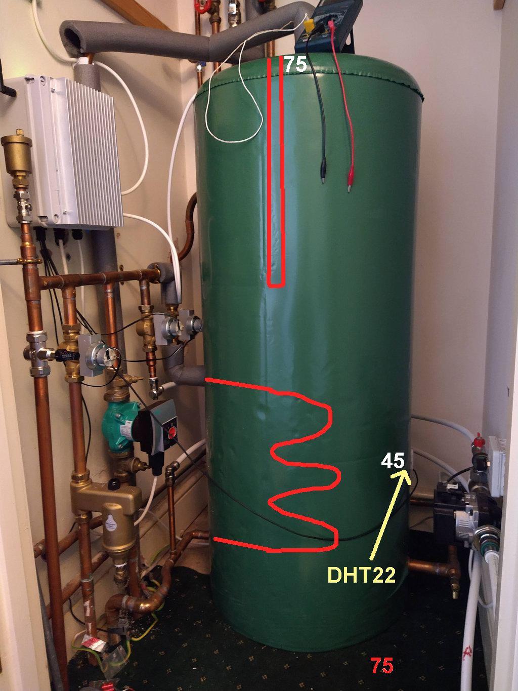

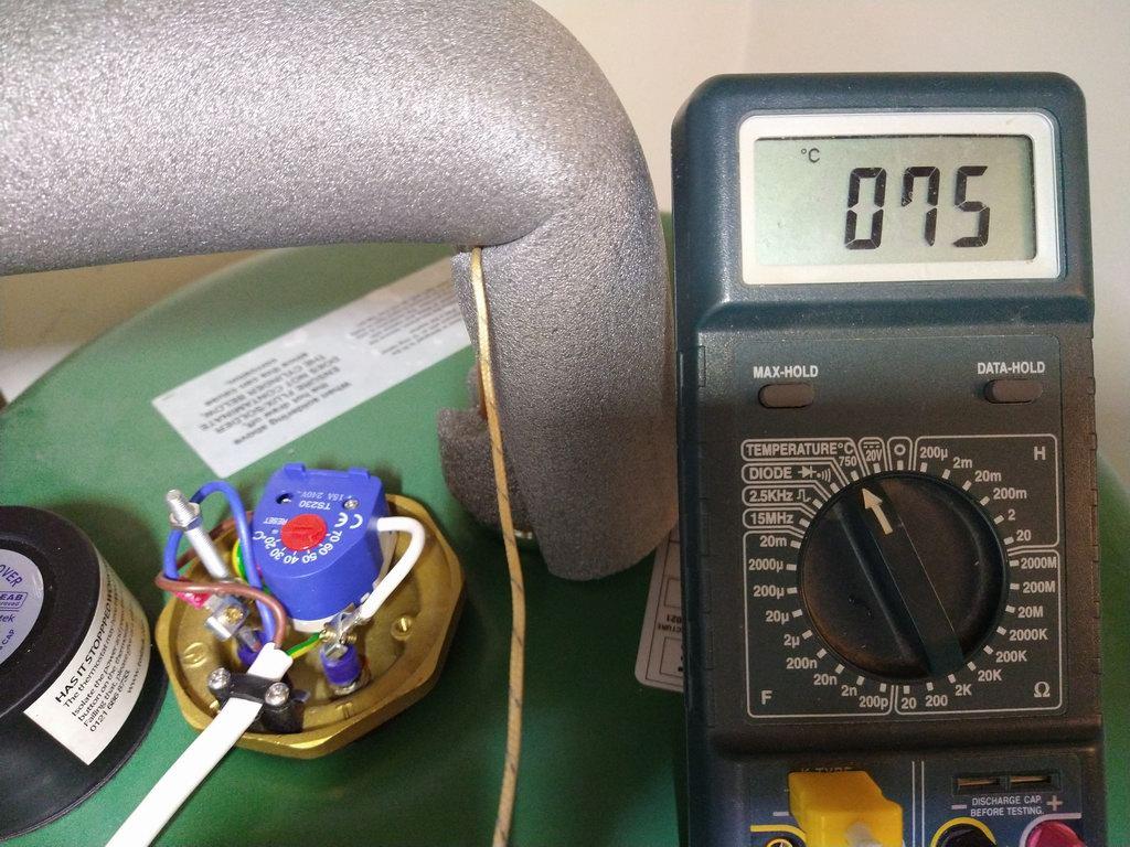

Radian Posted April 19, 2023 Share Posted April 19, 2023 In a another recent thread I noted how I'd corrected the calibration of my immersion thermostat to store more energy using my DIY PV diverter as the factory setting was quite a bit out and switched off the immersion well before reaching the temperature setpoint. It now max's out at 75oC as promised on the dial. But I'm still very unhappy with the results I'm getting. Evidently due to stratification, the water leaving the top of the cylinder can be as high as 75oC while the point where my DHT22 tank sensor is located is at 45oC. This is a much greater difference than I anticipated. I confess to being totally inexperienced about this issue and it has really made all the effort of building the diverter somewhat pointless as I can only get about 3kWh into the tank at a time. Since getting 3.2kWp of solar PV on the roof late last year, this is the first time I've seen more than 20kWh generated in one day and more than half of that is now pointlessly going out to the grid. Even this whopping 30oC difference is being measured statically (when everything has settled for an hour or two). When I draw off water, it continues to come out at a constant 75oC for quite some time (while being pushed up by the cold feed) which rapidly trips the tank sensor turning on the gas boiler and I don't want that! Here's how it looks: briefly drawing off HW, the lower part of the tank got down to 28oC even though the water at the top was still coming out at 75oC (not plotted - the HW trace is the output from the DHT22, I don't have a permanent sensor at the top) The fact that the water coming off the top remains pretty constant at the same high temperature suggests an even slug of water to the depth of the immersion that gradually gets pushed up by the cold, like so: I get that a de-stratification pump would help but it'd be quite a bit of effort to implement and I'm not so sure the outcome would be worth it. I went blindly into building the diverter in the first place. I don't want to put even more effort into the project only to be disappointed once more. Link to comment Share on other sites More sharing options...
ProDave Posted April 19, 2023 Share Posted April 19, 2023 The issue is you have a top mounted immersion heater. I would never choose a cylinder with that configuration (I suspect you did not choose it) My own (Telford stainless unvented heat pump cylinder) has the immersion entering from the side near the bottom and does what you want, heats the whole tank quite evenly and sinks all the surplus PV we have ever had. Link to comment Share on other sites More sharing options...
Radian Posted April 19, 2023 Author Share Posted April 19, 2023 1 minute ago, ProDave said: The issue is you have a top mounted immersion heater. I would never choose a cylinder with that configuration (I suspect you did not choose it) My own (Telford stainless unvented heat pump cylinder) has the immersion entering from the side near the bottom and does what you want, heats the whole tank quite evenly and sinks all the surplus PV we have ever had. That's the really frustrating bit. I replaced our old cylinder with this one just a couple of years ago. Hadn't even heard of PV diversion back then and didn't even bother to fit an immersion until this year. Huh. Reading around other forums I see it's not even straightforward fitting a destratification pump as non-return valves don't seem to work well in gravity fed systems. They seem to double-up as check valves to prevent thermosyphoning and as such need a substantial forward flow. Plus the pumps are more expensive than regular CH circulation pumps as they have to deal with a constant supply of fresh hard-water. Link to comment Share on other sites More sharing options...

jack Posted April 19, 2023 Share Posted April 19, 2023 Look into Willis heaters. They take cold water from low down, heat it, and return it to the top of the tank. Do you have access to any sort of connector lower down in the tank? You might even get away with breaking into the cold feed where it comes into the tank. Then you just need a return connection at the top of the tank. I don't know whether there's such a thing as an adaptor that would allow you to blank off the immersion heater boss and provide a connector you can connect to the hot water output of the Willis heater. Link to comment Share on other sites More sharing options...

jack Posted April 19, 2023 Share Posted April 19, 2023 45 minutes ago, Radian said: Yes I'm aware of their use for giving a boost to HW flow but plumbing one in doesn't really get me much further than using the internal one I've already got. I disagree. Your current immersion is unable to heat more than the top of the tank because of its position. Putting a Willis heater low down would allow much more of the tank to be heated. 47 minutes ago, Radian said: The same tap points top and bottom would be required, but I guess thermosyphoning might eliminate the need for a circulating pump? Exactly. You were complaining about the complexity of a destratification pump. This is a potential solution. I don't actually know whether a Willis heater addresses all of your problems, but I can't see why you wouldn't at least look into it further. They're pretty cheap and there isn't much plumbing involved. 1 Link to comment Share on other sites More sharing options...
dpmiller Posted April 20, 2023 Share Posted April 20, 2023 thermosyphoning is exactly how a Willis works. It's why we love'em here in NI- piping-hot water to the top of the tank in minutes for a quick basin of dishes, or a whole tankful for a bath in an hour. You don't need the stat set too high to get the flow going either, so I'd opine it would match a diverter well. 1 Link to comment Share on other sites More sharing options...
Miek Posted April 20, 2023 Share Posted April 20, 2023 8 hours ago, jack said: I disagree. Your current immersion is unable to heat more than the top of the tank because of its position. Putting a Willis heater low down would allow much more of the tank to be heated. Exactly. You were complaining about the complexity of a destratification pump. This is a potential solution. I don't actually know whether a Willis heater addresses all of your problems, but I can't see why you wouldn't at least look into it further. They're pretty cheap and there isn't much plumbing involved. I think this is probably your best solution to heat the whole tank. Also has no moving parts so no pump needed. Often used to retrofit solar thermal heating to an old tank, so it's a proven solution. As with anything relying on convection use big bore pipes and swept bends to reduce pipe friction hindering the circulation 1 Link to comment Share on other sites More sharing options...

Radian Posted April 20, 2023 Author Share Posted April 20, 2023 11 hours ago, jack said: I disagree. Your current immersion is unable to heat more than the top of the tank because of its position. Putting a Willis heater low down would allow much more of the tank to be heated. Bear with. I'm trying to get my head around this. Like this? So the cold water entering the bottom of the Willis heater will 'float' up once heated due to it's lower density (the basic principle of thermosyphoning). But will this continue to displace the hot water at the top of the HW cylinder until it's all 'pushed down'? I'm not finding it easy to picture the equilibrium point of the whole system. Link to comment Share on other sites More sharing options...
dpmiller Posted April 20, 2023 Share Posted April 20, 2023 ^ yes. whenever the water entering the willis from the bottom of the tank is hot enough to trip the stat, the whole tank is hot and no more energy will be requested. Link to comment Share on other sites More sharing options...
Radian Posted April 20, 2023 Author Share Posted April 20, 2023 (edited) 1 hour ago, dpmiller said: ^ yes. whenever the water entering the willis from the bottom of the tank is hot enough to trip the stat, the whole tank is hot and no more energy will be requested. So it can't get 'plugged' with a buoyant slug of hot water at the top of the cylinder like in the picture I posted above? Hopefully then it sinks ending up like this... Edited April 20, 2023 by Radian Link to comment Share on other sites More sharing options...

dpmiller Posted April 20, 2023 Share Posted April 20, 2023 no it can't get plugged. the tank would need to be hotter than the output of the willis for that to happen aside/ you can however if you're careful use the willis as an instantaneous- once it's on for a minute or two, opening a hot tap gently will take the flow *through* the heater... Link to comment Share on other sites More sharing options...

jack Posted April 20, 2023 Share Posted April 20, 2023 33 minutes ago, Radian said: So it can't get 'plugged' with a buoyant slug of hot water at the top of the cylinder like in the picture I posted above? Hopefully then it sinks ending up like this... Ignore the fact that the Willis heater is external - the two situations are almost exactly the same (albeit there might be slightly more stratification in the Willis heater example due to how/where it introduces the heated water to the tank - an internal immersion is more likely to cause some turbulence/mixing). In both cases, buoyancy causes hot water to rise and displace cold water downwards, and also in both cases, the distance that the cold water will be pushed down is limited by the vertical position of the heater. 1 Link to comment Share on other sites More sharing options...
