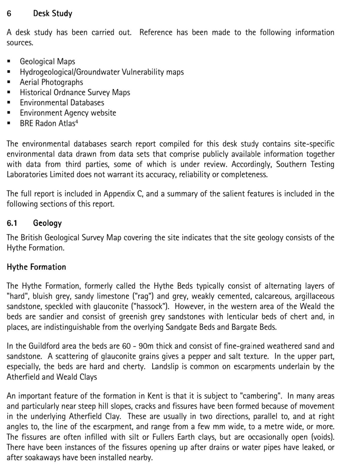

saveasteading Posted April 23, 2023 Share Posted April 23, 2023 3 hours ago, Katie AG said: these stresses are avoidable with good research and use of a fixed price option? Yes you can pay people to take your stress, but they are taking on your risks and will charge tidily for it. Costs rise from the lowest level at skilful self build, increasing every time the responsibility is handed over to consultants and contractors. Highest cost for complete turnkey with project manager and a single main contractor on a fixed price. Could double the cost. But probably a better job. On second thoughts, the highest cost will be with an overconfident, non-skilled self builder who has to do things twice, and has chosen the wrong contractors. 1 Link to comment Share on other sites More sharing options...
saveasteading Posted April 23, 2023 Share Posted April 23, 2023 5 hours ago, Katie AG said: Thanks for advice. I had definitely thought about contingency. Is the amount lessened when dealing with a fixed price main contractor or turnkey service? tree is a sycamore and it’s sandstone Contingency decreases but price increases. Sycamore is a big, thirsty tree which requires deeper foundations if in clay. But sandstone is not affected in the slghtest. How deep to the stone? Link to comment Share on other sites More sharing options...
Iceverge Posted April 23, 2023 Share Posted April 23, 2023 4 hours ago, Katie AG said: I really wonder how much of these stresses are avoidable with good research and use of a fixed price option? What we really need is an option like buying a toaster. Pay one person, get one product. If you could find a good company this is a good route. Not terribly entertaining for someone like me who wants to get stuck in however. Link to comment Share on other sites More sharing options...
Bournbrook Posted April 23, 2023 Author Share Posted April 23, 2023 2 hours ago, saveasteading said: Contingency decreases but price increases. Sycamore is a big, thirsty tree which requires deeper foundations if in clay. But sandstone is not affected in the slghtest. How deep to the stone? I don’t think we have any clay round here. I have the results of a desk study for a development opposite our house. Photo attached. Seems to indicate 60-90cm to bed? Although we are about 15 miles from Guildford. Link to comment Share on other sites More sharing options...
Bournbrook Posted April 23, 2023 Author Share Posted April 23, 2023 1 hour ago, Iceverge said: What we really need is an option like buying a toaster. Pay one person, get one product. If you could find a good company this is a good route. Not terribly entertaining for someone like me who wants to get stuck in however. Unfortunately we don’t have the luxury of excitement and getting really involved, but would love to! we know we will be paying a premium, but willing to factor that in and still feel the gains are worthwhile for us (based on what we know so far) 1 Link to comment Share on other sites More sharing options...
saveasteading Posted April 23, 2023 Share Posted April 23, 2023 8 minutes ago, Katie AG said: Seems to indicate 60-90cm to bed? That is good then. Standard footings. Also helps when a building can be simple construction, as no fancy Engineering is needed, and normal builders can build it. Next risky things....can the drains simply be coonected to the main sewers, and can mains supplies come straight from the rosdside? Then choose a nice standard house design. Link to comment Share on other sites More sharing options...

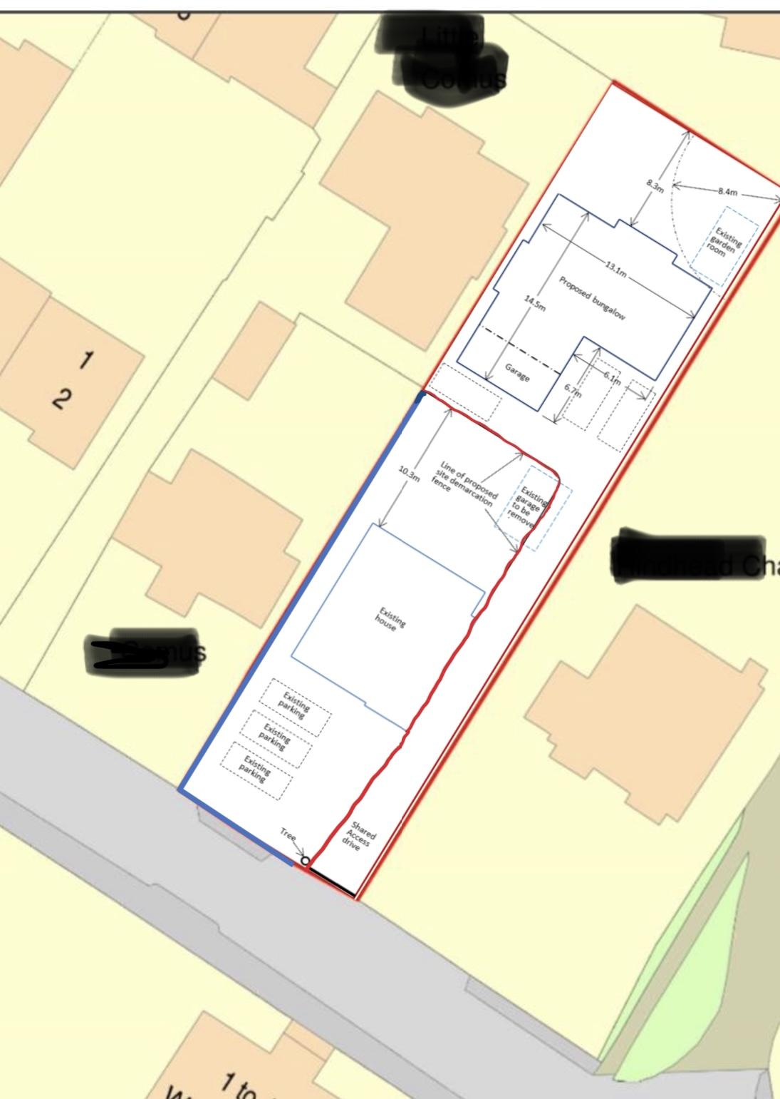

SteamyTea Posted April 23, 2023 Share Posted April 23, 2023 @Katie AG Might be worth doing a scaled sketch of what you currently have, putting in the position of the current services, road access etc. There are a multitude of rules and I doubt 1 person knows them all. Why a community like Buildhub is useful. Link to comment Share on other sites More sharing options...
Bournbrook Posted April 23, 2023 Author Share Posted April 23, 2023 7 minutes ago, SteamyTea said: @Katie AG Might be worth doing a scaled sketch of what you currently have, putting in the position of the current services, road access etc. There are a multitude of rules and I doubt 1 person knows them all. Why a community like Buildhub is useful. I genuinely don’t know where any services are! I just know water is by drive and sewer in front of garage. See attached plan. Link to comment Share on other sites More sharing options...
SteamyTea Posted April 23, 2023 Share Posted April 23, 2023 3 minutes ago, Katie AG said: genuinely don’t know where any services are Get the metal detector out. Though some misguided souls will tell you that divining twigs works, they don't. Link to comment Share on other sites More sharing options...
Nickfromwales Posted April 23, 2023 Share Posted April 23, 2023 2 hours ago, Katie AG said: I genuinely don’t know where any services are! I just know water is by drive and sewer in front of garage. See attached plan. Most don't so do not panic. You just get the groundworkers to dig slowly carefully. Finding "buried treasure" is something you'll factor in and accept as a known eventuality, and you'll deal with a break if and when it happens ( out of your contingent fund ). Link to comment Share on other sites More sharing options...
