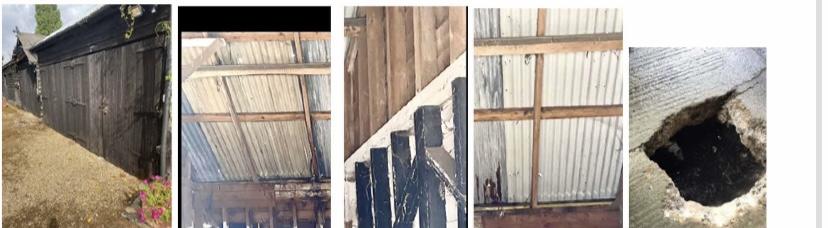

ChrisF8 Posted April 16, 2023 Share Posted April 16, 2023 We need some advice with a piece of land we’re looking to purchase. It has a single storey barn on it with class q approval. On further inspection the barn is sitting on a 200mm concrete slab that I’m presuming wouldn’t pass building regs as suitable foundations…so we would need to underpin it. my question is… is underpinning classified as ‘new foundations’ or it reinforcement of the existing slab? Either way does this invalidate the granted permission as the class q conditions state: The regulations do not allow the introduction of new foundations, loadbearing floor slabs or significant rebuilding works. Link to comment Share on other sites More sharing options...
Jilly Posted April 16, 2023 Share Posted April 16, 2023 Welcome! It's a very steep learning curve. Take a look at the Little Stud Barn Blog, they are doing class Q. i don't think there are many on here who haven't got full planning permission (in the end, that is) Link to comment Share on other sites More sharing options...
IanR Posted April 16, 2023 Share Posted April 16, 2023 (edited) 1 hour ago, ChrisF8 said: We need some advice with a piece of land we’re looking to purchase. It has a single storey barn on it with class q approval. On further inspection the barn is sitting on a 200mm concrete slab that I’m presuming wouldn’t pass building regs as suitable foundations…so we would need to underpin it Is it a reinforced slab. At 200mm thick it may well be able to take a timber frame construction on it. Building Control will be happy if the Structural Engineer signs it off. But to your question... Replacing or reinforcing existing foundations remains a controversial area for Class Q (to coin Martin Goodall's phrase). Some LPA's are happy to Approve a Class Q conversion that will replace walls, floors and roofs putting additional loads into the existing structure, without any evidence that the existing foundations are strong enough to support the conversion. Once Approved, the LPA will not be coming along to inspect the works that are undertaken, unless perhaps there is a complaint from a neighbour that suggests some wrong doing. Other LPA's, that are still resisting Class Q's, appear to be asking for SE calcs that determine the new loads into the existing structure and the SE's opinion on whether the existing structure can withstand those loads. Within his blog it was Martin Goodall's stated view that although controversial, "up to a point, new foundations and/or underpinning may be acceptable". Since you haven't yet purchased the property, it may not be worth taking the risk, without an SE confirming the existing slab can take the loads of the conversion. Or, you could submit for a Certificate of Lawful Development and set out the works you intend to do and ask the LPA if they agree it is within the planning Approval. The existing owner may not appreciate this route as a negative response from the LPA could nullify the planning approval. Another option maybe to informally approach the LPA on the merit of a full planning application for a Change of Use conversion that uses the existing Class Q Approval as a back stop. This is the optimum scenario, and one that is now supported by successful Appeals. Are you sure the existing barn structure sits on the slab? It's typical of a modern, portal frame structure to have individual foundation pads under each column, and maybe the slab is poured above this level with external walls, between the columns, sitting on that slab. Quote The regulations do not allow the introduction of new foundations, loadbearing floor slabs or significant rebuilding works. I think this must be a 3rd party's view on the legislation since it is not stated in the legislation that "the introduction of new foundations, loadbearing floor slabs or significant rebuilding works." are not allowed. I would not agree with this view. Edited April 16, 2023 by IanR Link to comment Share on other sites More sharing options...
saveasteading Posted April 16, 2023 Share Posted April 16, 2023 A 200mm slab is very thick and unusual on a farm building. Has this been checked in the middle. The edges will be deeper perhaps giving the impression that the slab is thick. Unless this is a pole barn, the columns will have concrete footings, tho unlikely to be to domestic standards. Link to comment Share on other sites More sharing options...
ChrisF8 Posted April 17, 2023 Author Share Posted April 17, 2023 I’ve re-read the report and it states: The building is constructed of wooden frames which are secured in a concrete floor which showed no signs of cracking. I was presented with a trial hole which concluded that the existing floor is approx 200mm of reinforced concrete. The building consists of internal bays which vary in width. The roof is corrugated sheet metal and the surrounding sides are all black shiplap wooden boards. On inspection the wooden frames are secured by concrete footings and cross members are treated timber and in good order. These showed no signs of deterioration and in my opinion will be sufficient to carry the weight of the proposed new alterations for a single storey conversion as shown in the sketched drawings. I’m not totally convinced but the report as the company seems to no longer exist so I think I’ll get a second opinion. We’re likely to go for full planning anyway but only once we know we have the fallback position of Class Q so we can purchase the land. The barn is over 150 years old, I’m not sure on the construction type so have uploaded pics of the internal beams. Thanks everyone for your input Link to comment Share on other sites More sharing options...

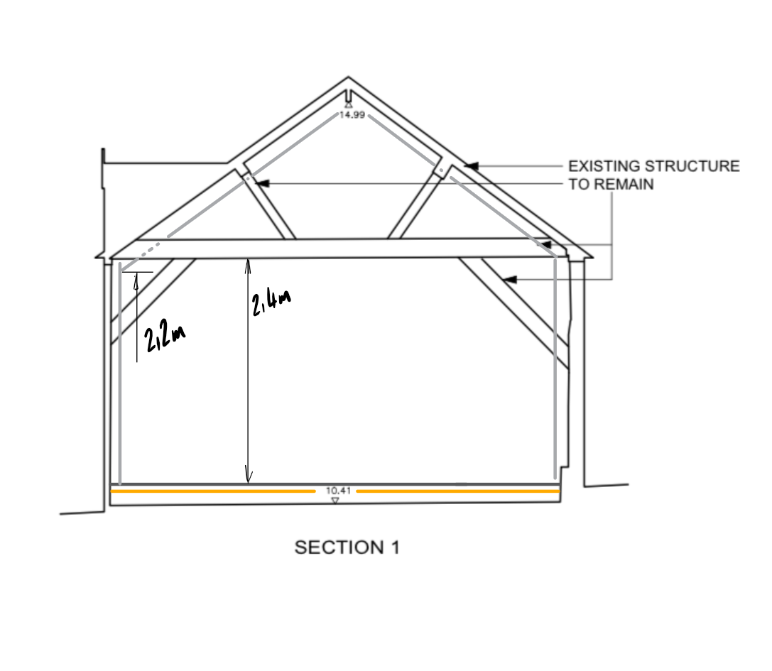

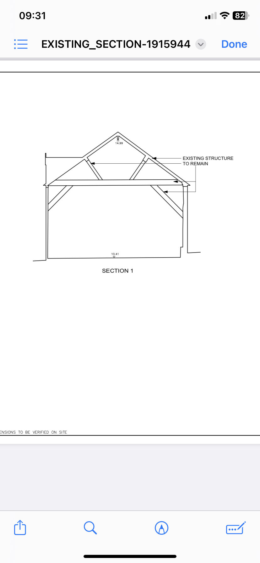

ChrisF8 Posted April 17, 2023 Author Share Posted April 17, 2023 (edited) Yes the main barn is over 4 metered high high so plenty of headroom, cross section attached Edited April 17, 2023 by ChrisF8 Link to comment Share on other sites More sharing options...
IanR Posted April 17, 2023 Share Posted April 17, 2023 29 minutes ago, ChrisF8 said: Yes the main barn is over 4 metered high high so plenty of headroom, cross section attached It does look like you can squeeze in 2.4m to the bottom chord, but it needs some detailing around the eaves to squeeze out as much height as possible for the structure around window and door openings. Ball park it looks as though structural openings could be around 2.2m, which is enough, but if another 100mm was lost in levelling the existing floor and estimating heights from a jpeg image then the sight lines through the window glass could start to be a little compromised. This also only accounts for approx. building regs floor insulation, you may want the FFL a little higher if you plan a higher energy performance than building regs. Link to comment Share on other sites More sharing options...

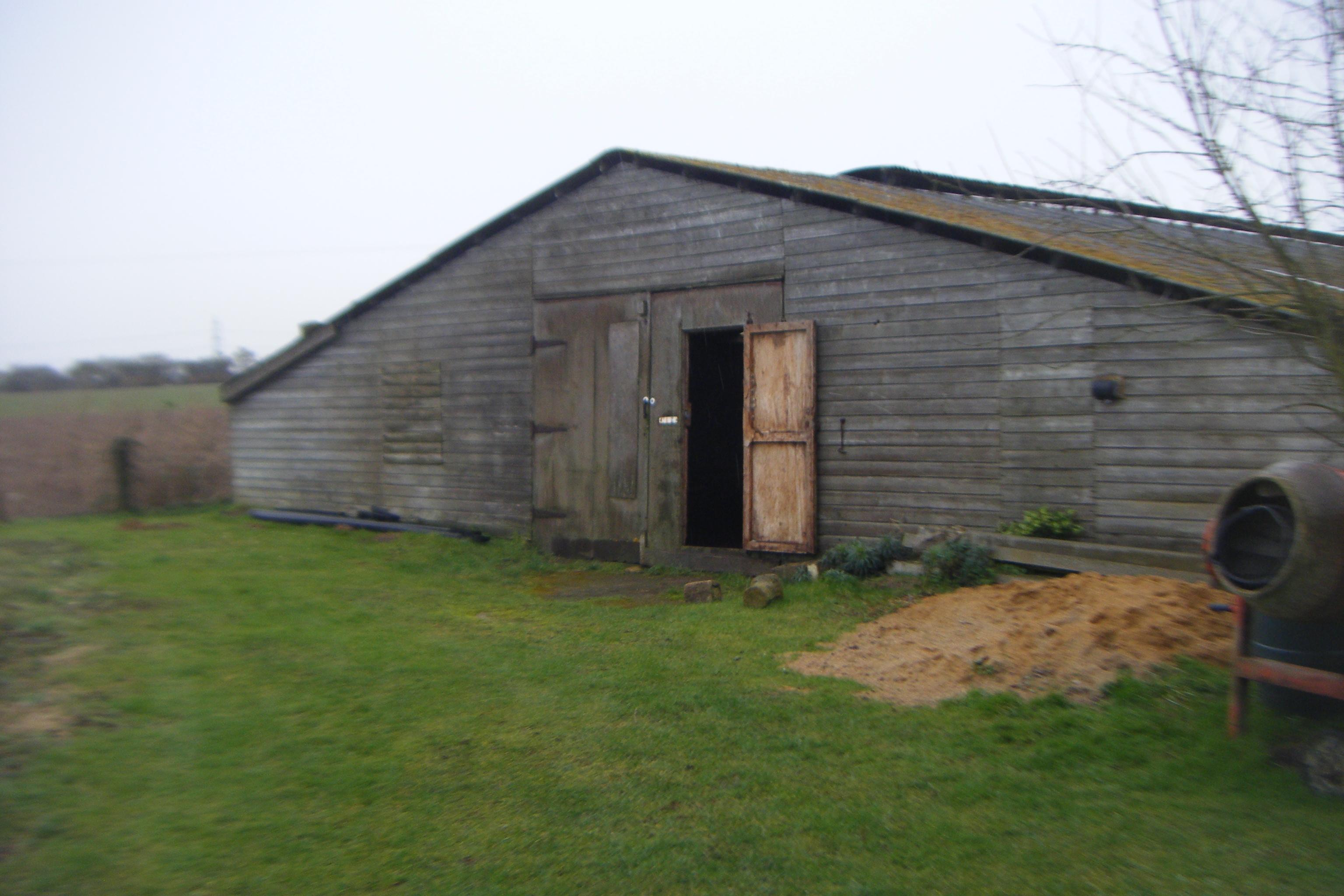

kandgmitchell Posted April 21, 2023 Share Posted April 21, 2023 Well George, got this one through as a Part Q. Remember, works inside a building are not development for the purposes of the Town and Country Planning Act....... Link to comment Share on other sites More sharing options...
Temp Posted April 21, 2023 Share Posted April 21, 2023 Might be hard to underpin from the inside though 🙂 Link to comment Share on other sites More sharing options...
IanR Posted April 21, 2023 Share Posted April 21, 2023 9 minutes ago, kandgmitchell said: Well George, got this one through as a Part Q. Is it a poultry shed? What's the plan for the last few metres either side, where the headroom is a little restricted? Link to comment Share on other sites More sharing options...
