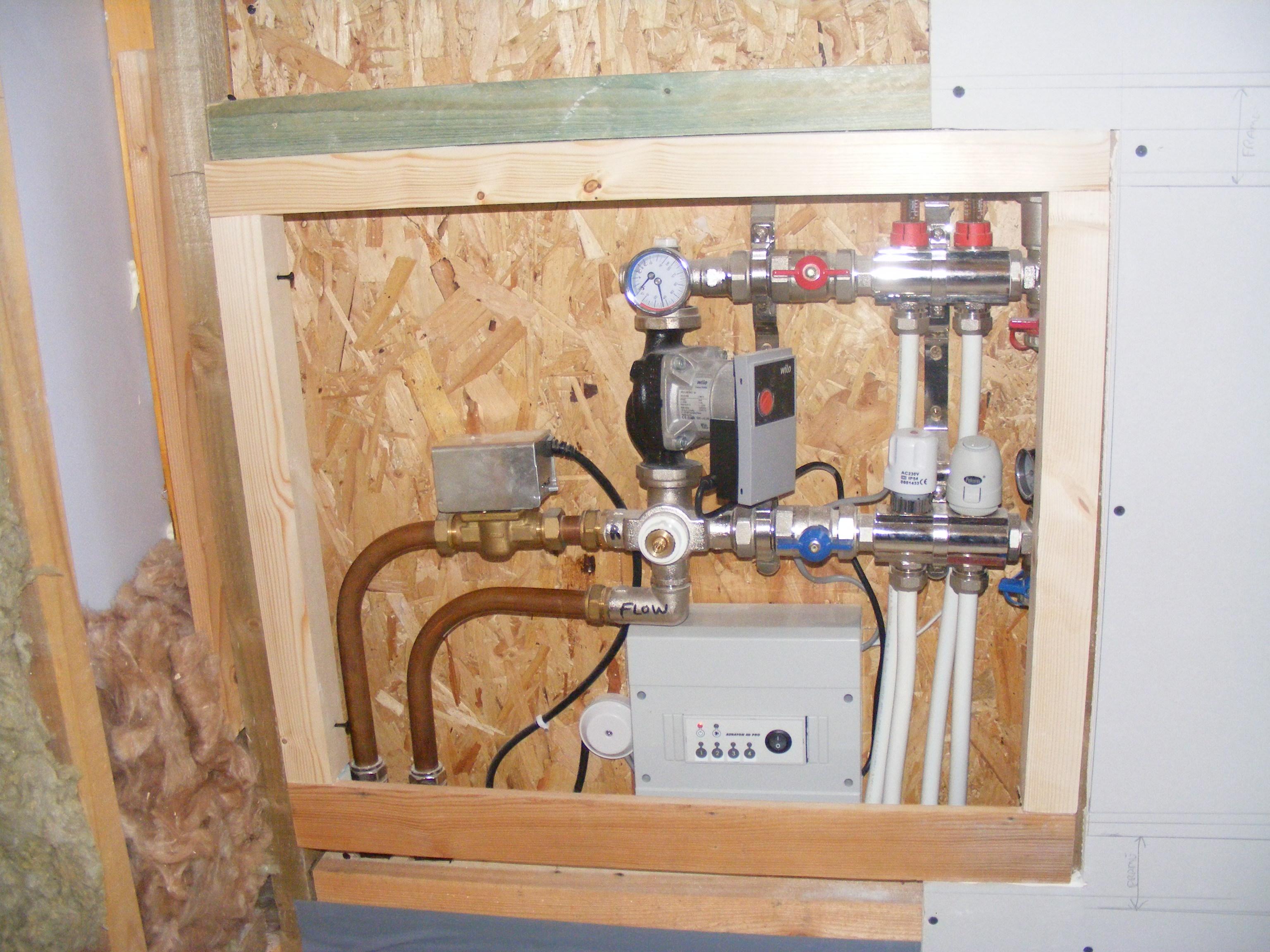

hbooth Posted April 16, 2023 Posted April 16, 2023 Hi all, I'm currently in the process of a new build and I have put plumbing the underfloor heating in on myself however I've never done it before so have loads of questions. The pipework for the ground floor underfloor is in and the screed has been poured. I have to hook up the manifold and run all cables for thermostats etc. Its will be run from a Diakin heat pump. The guys putting the heat pump in said for maximum efficiency to have the whole downstairs which is 9 loops as one temperature zone. So the first question is what else do I need to have in place to make this work? I assume a single zone valve going into the manifold will do the trick bit I have no clue how to wire that up to the heat pump and the thermostat. Next question, is only having one heat zone actually the best way to maximize efficiency? Or will that actually end up costing me a fortune in electricity costs to run? Next question, if I only have one zone will there be an easy way to switch some loops off if needed? I just think that some of the loops that are in small rooms will end up getting too hot if the doors are closed etc. I guess an isolation valve in the loop would do the trick if there's no better way. I will be laying all the first floor pipe work and Installing the manifolds, thermostat etc. Myself. Will it be best to have the upstairs on separate heat zones or will one big zone also do the trick upstairs? Or is this really just a case of personal preference? If I only have one big zone how does that tie in with the heat pump? I would assume it can be the case that if either the downstairs or the upstairs call for heat it will make the heat pump kick in? I know this post is a bit all over the place but I'm really still getting upto speed with the heating so thanks in advance for any help/advice.

ProDave Posted April 16, 2023 Posted April 16, 2023 Single zone or individual room thermostats is a bit of a marmite question, very much a personal preferance. It also depends on what level of build insulation and air tightness you are aiming for. Many on here build passive houses or very close to that, that require very little heating and a single zone works well with that and most find with such a well insulated house there is no need for heating upstairs. but if you are just building to basic building regs values you may well find individual room control is better. To give you some idea of what we are talking about, this is a picture of my little upstairs manifold, just 2 loops for the 2 bathroom floors. A more typical larger manifold is just longer and has more pipe loops and actuators. A proper manifold should have a circulating pump, and temperature blending valve and then the manifold rails in this case with the actuators on the bottom and flow meters on the top rail. the grey box underneath is the controller, a cheap generic no name one from ebay. If you choose to go single zone you don't need the grey box (under £100) and you don't need the actuators on the bottom rail (about £15 each) If you go single zone it is much more important so spend time balancing the flow between the loops by adjusting the flow meters, so that each room heats up at the same rate.
