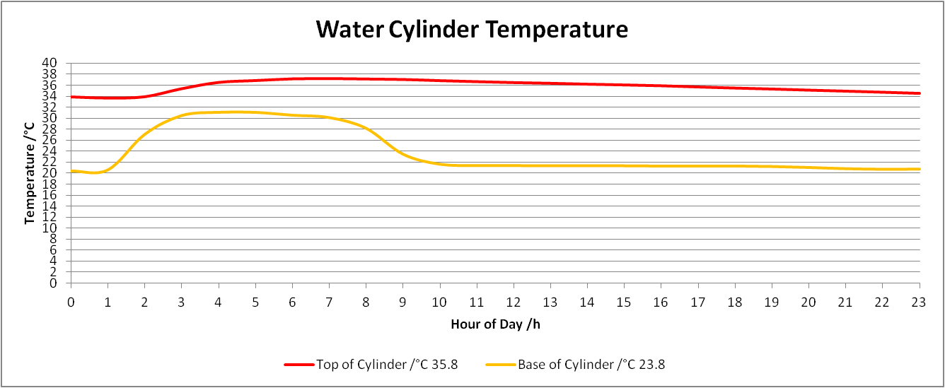

SteamyTea Posted April 13, 2023 Share Posted April 13, 2023 Here is some time series data from my E7 heated cylinder. Link to comment Share on other sites More sharing options...
