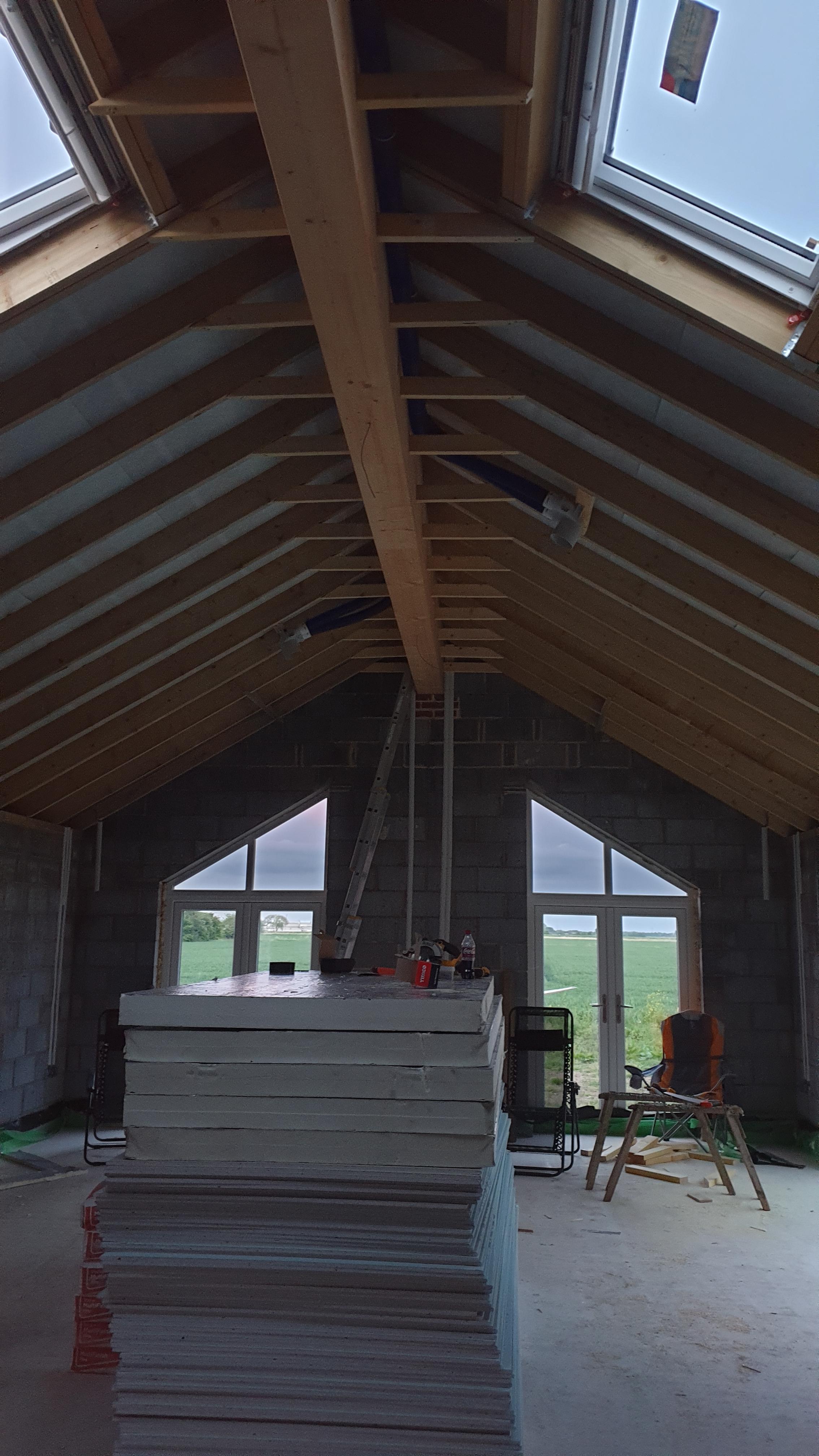

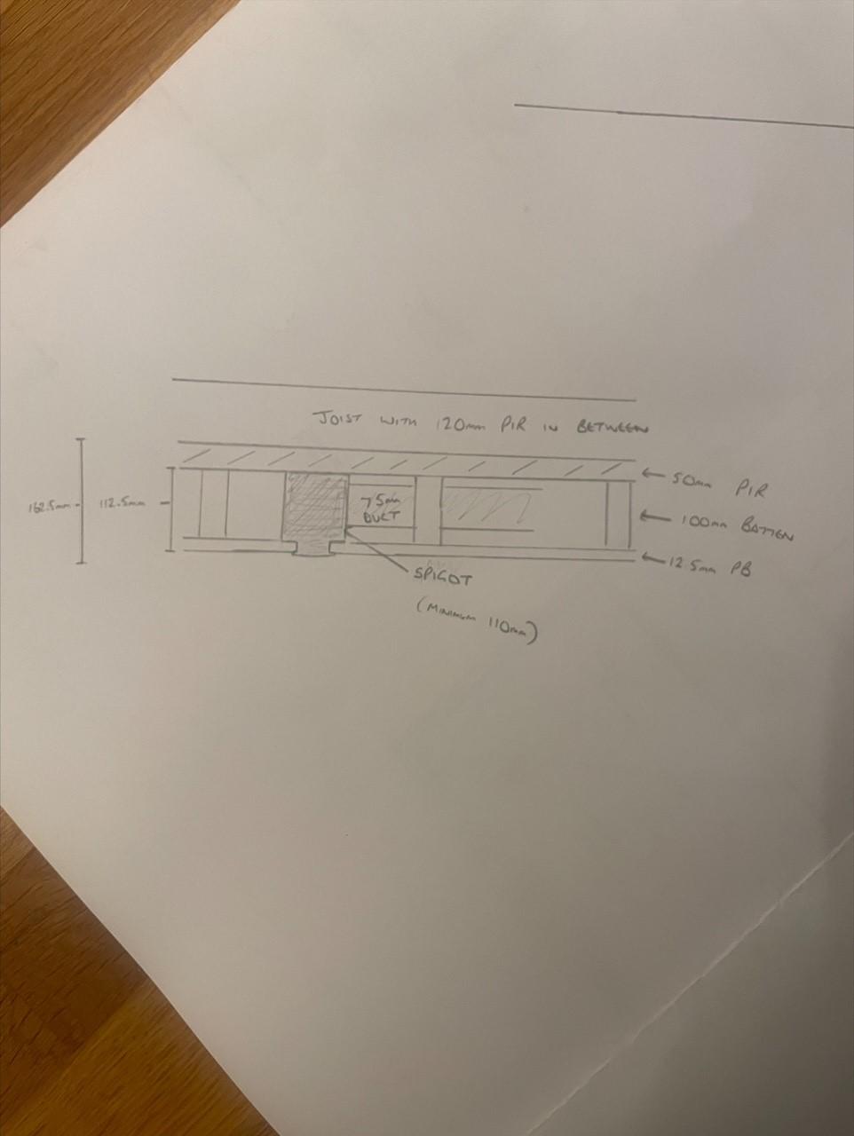

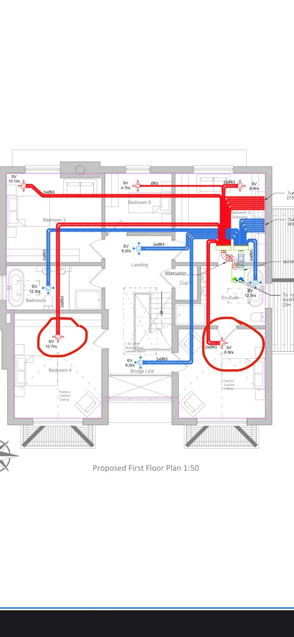

richo106 Posted April 13, 2023 Posted April 13, 2023 Hi All We are having MVHR installed in our new house (well I am installing it) and we are having vaulted ceilings in 2 of the bedrooms I have attached my very dodgy drawing of my first idea of how to install them with battens etc Is this a suitable way of doing it? Or is there another/better way to do this? Could I potentially wall mount the valve? Any advice very much appreciated
richo106 Posted April 13, 2023 Author Posted April 13, 2023 Just to add, the ceiling rafters are now up and the builder recommended installing the 120mm PIR from above while I can Many Thanks
richo106 Posted April 13, 2023 Author Posted April 13, 2023 Just thinking, when I 'flat' off the vaulted ceiling I could run the ducting through that and mount the spigot so the valve is in the flat bit of the ceiling Many Thanks

JohnMo Posted April 13, 2023 Posted April 13, 2023 Keep it simple don't put them in the ceiling. Use coanda effect nozzles and put them in the wall. The coanda effect will cause the air to travel across the room. 1

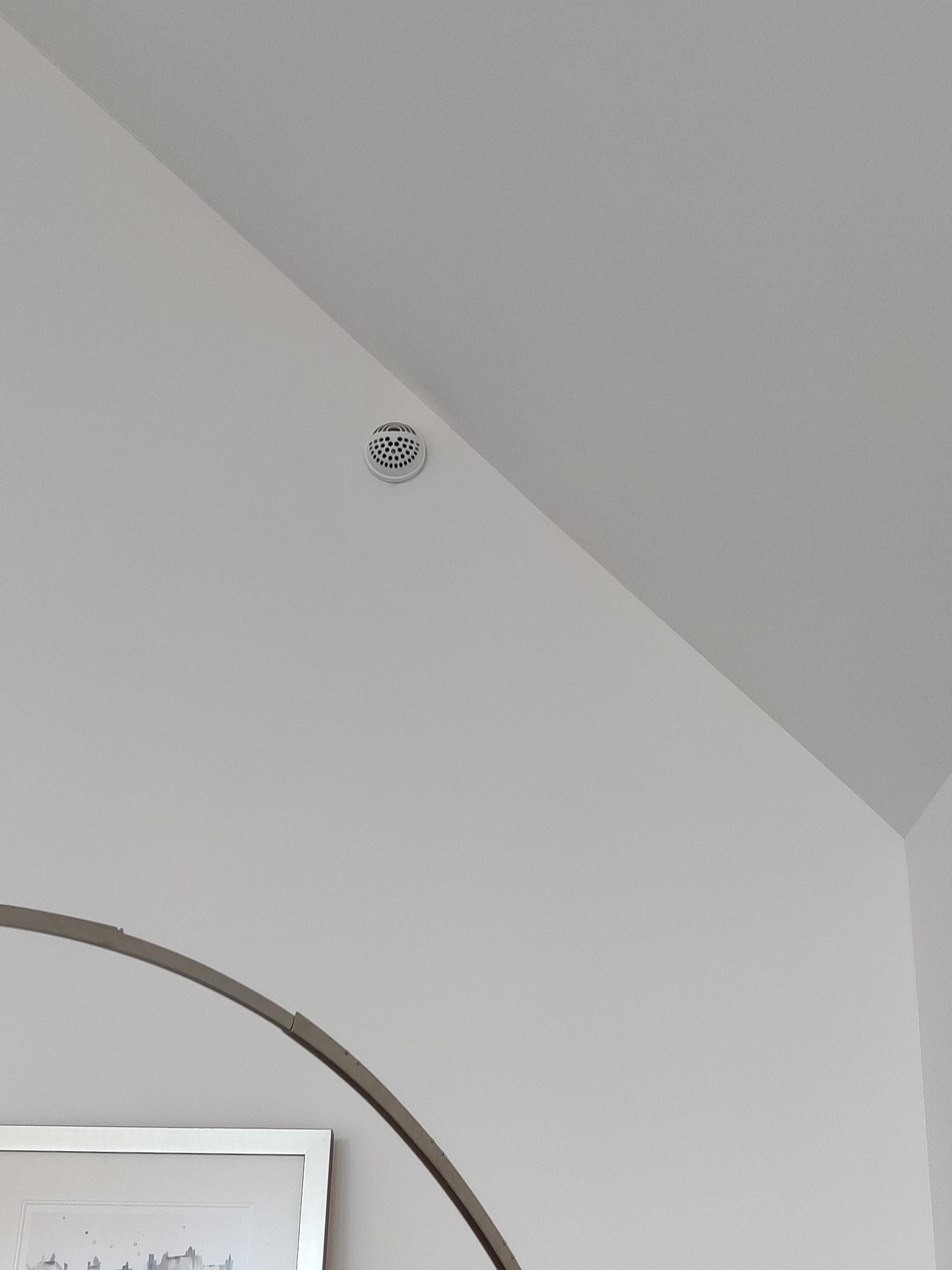

Buzz Posted April 13, 2023 Posted April 13, 2023 23 minutes ago, richo106 said: I don't suppose you have a picture of it at all if you wouldn't mind sharing it (just to show the mrs) Many Thanks We did something similar to @Becksidefor our vaulted room .
Chablais Posted April 13, 2023 Posted April 13, 2023 I fitted studding across the apex to create a void for the ducting and a flat surface for the valve to fit to. Very simple. I used 90mm dia semi rigid ducts so needed the appropriate space to install them.

Conor Posted April 14, 2023 Posted April 14, 2023 On 13/04/2023 at 10:28, richo106 said: Just thinking, when I 'flat' off the vaulted ceiling I could run the ducting through that and mount the spigot so the valve is in the flat bit of the ceiling Many Thanks That's exactly what we did. Formed a small flat ceiling at the ridge that left enough room for the plenums. With 3.5m ceilings it hardly feels oppressive.

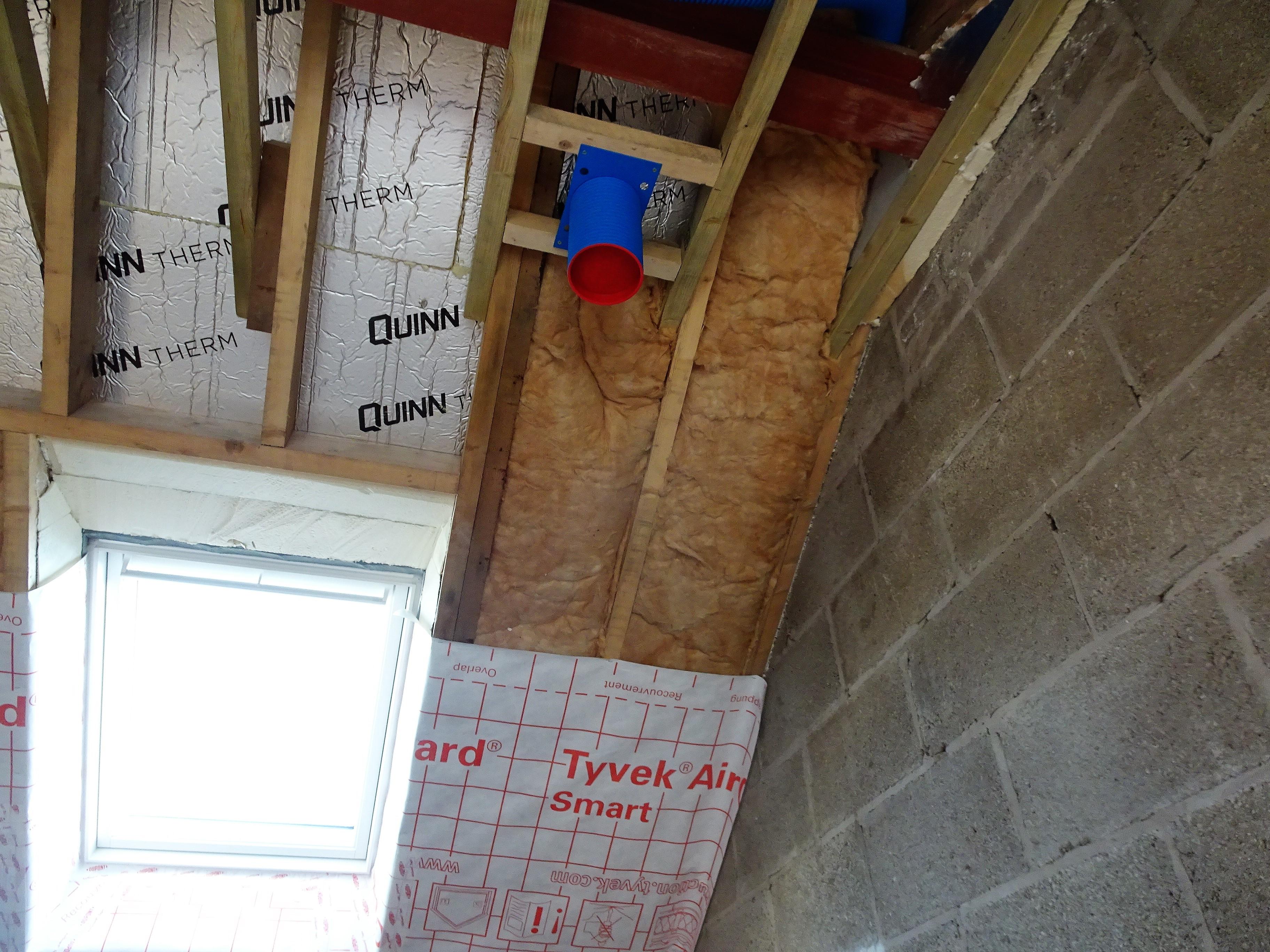

cwr Posted April 14, 2023 Posted April 14, 2023 Here's what I did. 125mm of pir was then fitted between the rafters and 60mm under, then the airtight membrane then battens and counter battens (each 22mm). The duct ended mostly 'in' the 60mm pir, on the outside of the membrane.
