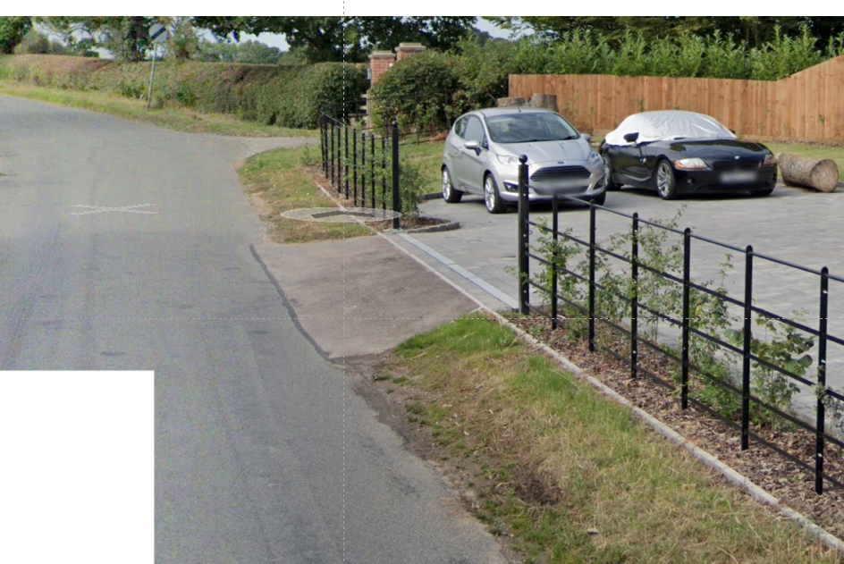

Blooda Posted April 20, 2023 Posted April 20, 2023 2 hours ago, Kelvin said: We’re both perfectly chilled (well I am) Just sharing experience. 😉 I am now, but wasn't when I got my quote From what I remember - with WPD [now NG] we could have accepted the quote, and delayed the start. 1 hour ago, Adsibob said: But not as ridiculous as our application to the council for a dropped kerb. Completely shafted by the local council and their so called "approved contractor" for almost £8k. My "dropped kerb", which was not a dropped kerb as there no kerb to drop. It is just a few edgings and a trapezoid shaped bit of asphalt. Cost around £1500 for the council to do with their own people. It's pretty poor quality, and if we'd done it ourselves they'd have made us do it again. Also the main Open Reach Fibre to the whole of the village, cable runs underneath there in a duct so we would not have been popular if we'd have damaged that.
