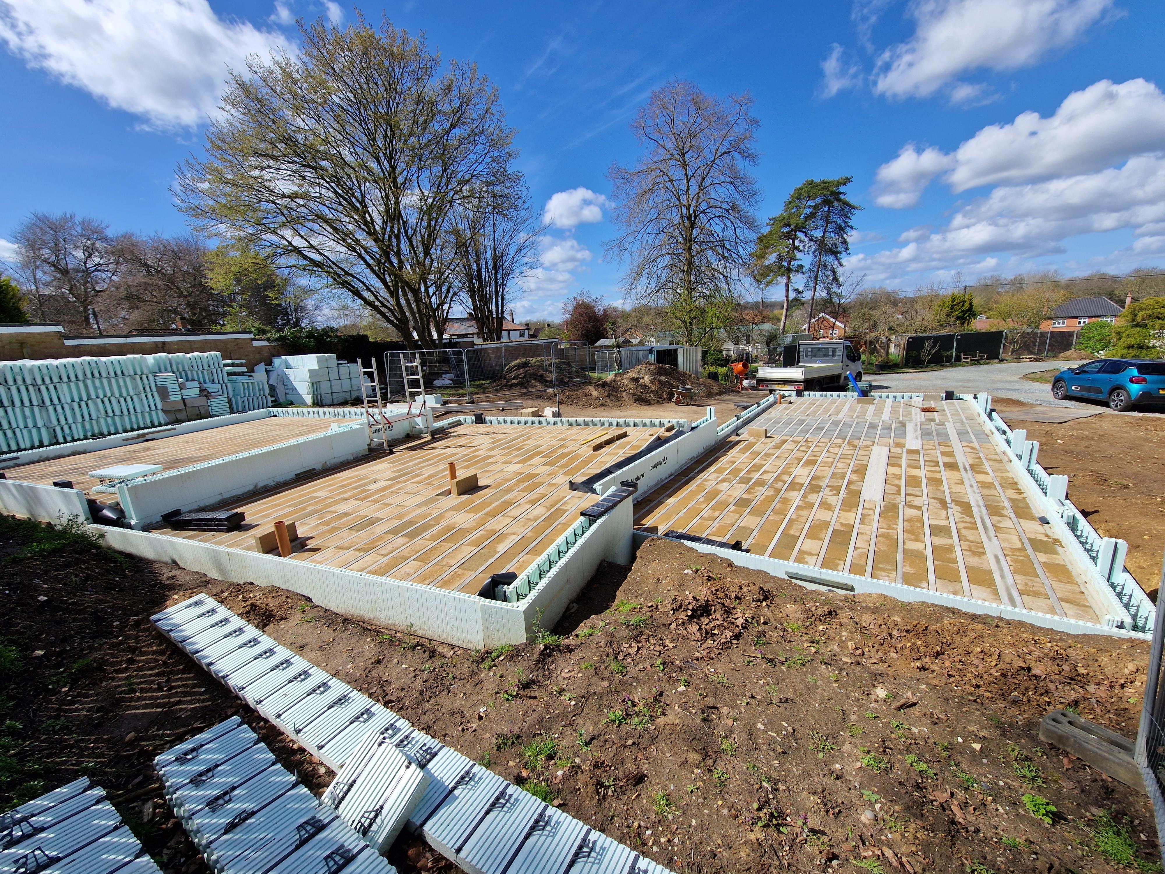

Mulberry View Posted April 11, 2023 Posted April 11, 2023 I know there are loads of different approaches to grouting Beam & Block. The one I like the most uses a strong but custard-like pourable consistency mixture of around 2:1 Sand/Cement squeegeed/brushed in. But where to start with sand and cement quantities?! I've got about 110m2 of floor area to do, with the fortunate benefit of them being in 3 distinct and separate zones. To note - the infill is all done, including the double/triple beams, so this is purely for grout.
Temp Posted April 11, 2023 Posted April 11, 2023 Perhaps make up a small batch from bagged materials and see how much area it covers, then you know how much to order for the rest. 1
nod Posted April 11, 2023 Posted April 11, 2023 A tone of sharp sand Though if it’s going up in block Your Brickies will do it for free 1 1
Mr Punter Posted April 11, 2023 Posted April 11, 2023 Sharp sand makes the job hard work. Building sand:cement 3:1 with plasticiser and sloppy. It wont take that much. It is easier when the blocks are wet. 1

Mr Punter Posted April 11, 2023 Posted April 11, 2023 9 minutes ago, Dave Jones said: never bother grouting. cant see point of it. It locks the floor components together and allows them to work together as a diaphragm. Apparently.
Mulberry View Posted April 11, 2023 Author Posted April 11, 2023 1 hour ago, Dave Jones said: never bother grouting. cant see point of it. See, I feel like it'd be worthwhile to fix everything in place. There is no detectable movement in my floor, but some of the blocks still wriggle a bit. Grouting will stop all movement, won't it?
Big Jimbo Posted April 11, 2023 Posted April 11, 2023 5 minutes ago, Mulberry View said: See, I feel like it'd be worthwhile to fix everything in place. There is no detectable movement in my floor, but some of the blocks still wriggle a bit. Grouting will stop all movement, won't it? Should do, as long as it's nice and wet.
Buzz Posted April 11, 2023 Posted April 11, 2023 42 minutes ago, Mulberry View said: See, I feel like it'd be worthwhile to fix everything in place. There is no detectable movement in my floor, but some of the blocks still wriggle a bit. Grouting will stop all movement, won't it? As others have said above my builders just used whatever was leftover at the end of the day, watered it down chucked it on the floor and brushed it across the blocks (FOC). Many months later I needed to move a soil pipe only a couple of blocks across from where it was originally placed , ended up having to destroy the blocks with a kango and lump hammer to get them out . 1
