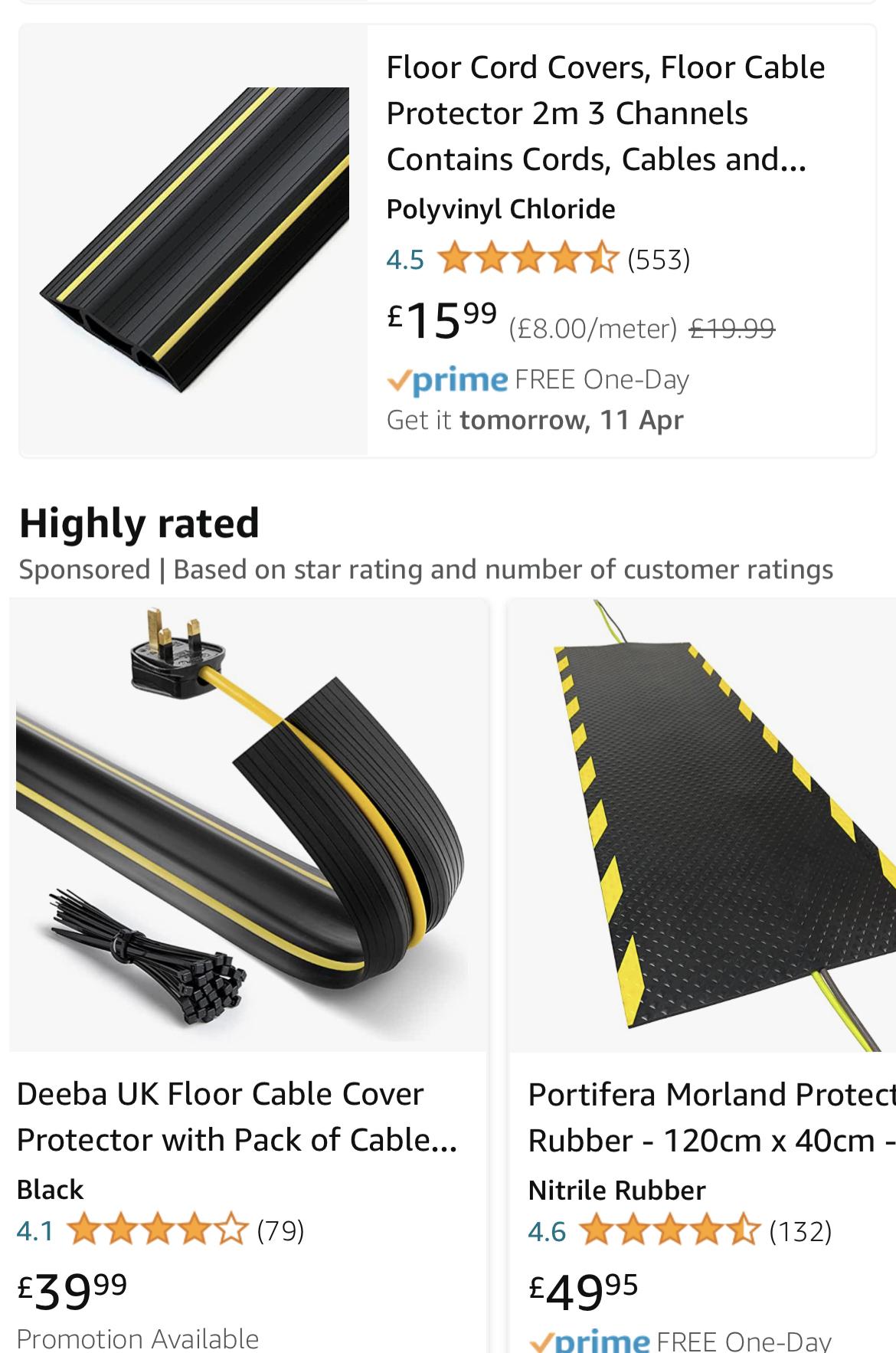

Adsibob Posted April 10, 2023 Author Posted April 10, 2023 17 minutes ago, Onoff said: Yes. No. But it’s made in Japan, the pioneers of advanced electronic engineering. My options are: 1) try my luck with this weird Japanese invention (Link above); 2) go for safer option of rigging up a PoE supply and then find a floor lamp that can be powered by PoE (I expect that finding something that will match our interiors and lighting scheme in PoE will be nigh on impossible; or 3) accept that the bump in the floor runner is going to be bumpier than ideal and use one of these under our floor runner: FFS, should have thought ahead and write in a floor socket!
