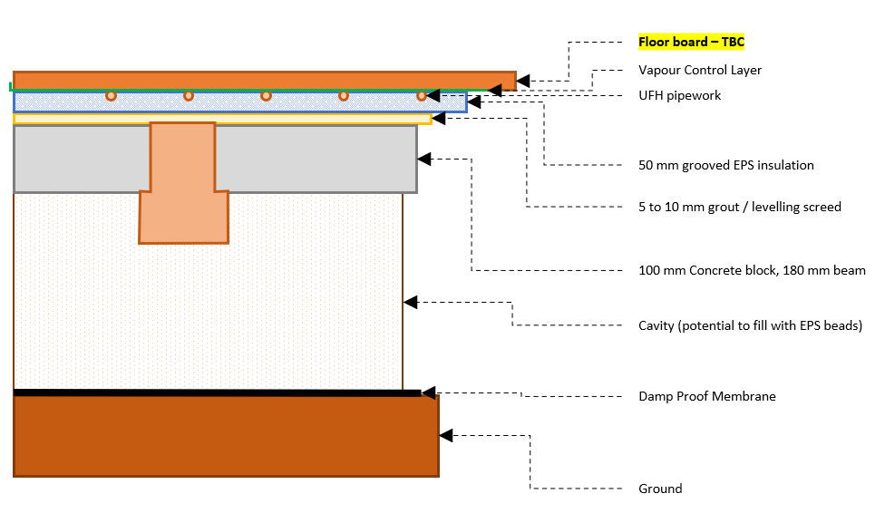

embra Posted April 9, 2023 Posted April 9, 2023 Hi everyone, Looking for some advice on best floorboard to finish our under floor heating system that will be installed across ~70 m2 ground floor. Sketch of floor construction attached. Background: The system is being installed on top of existing beam and block sub floor, constrained to limited stack height. Our property was originally built ~1990 and is located in Edinburgh, Scotland. The UFH will the thermostatically controlled, using hot water generated by air source heat pump & solar thermal panels. Our intention would be to run the system year round, trusting control system to do it’s job. UFH system: https://horstad.com/product-category/ufh-floor-types/eps-overlay-concrete/ The options I am considering: 1) 20 mm Dry Screedboard (e.g. https://www.builderdepot.co.uk/20mm-cellecta-deckfon-screedboard-20-dry-screed-panel-1200mm-x-600mm-4ft-x-2ft) Cost: £37.92 per m2 Thermal resistance: 0.050 m²K/W 2) 18 mm Chipboard (e.g. https://www.builderdepot.co.uk/18mm-p5-moisture-resistant-tongue-groove-chipboard-flooring-2400mm-x-600mm-8ft-x-2ft) Cost: £10.71 per m2 Thermal resistance: 0.105 m²K/W The reasons I’m considering the screed board are: 1) Higher thermal mass, floor would retain heat for longer (and take longer to heat up, but this would be offset by continually running system, and point 2) 2) Lower thermal resistance, spreading heat more consistently and heating up faster when UFH is active. Compared to chipboard, more heat would transfer “up” to the house rather than “down” to the ground in any given time period. Potential concerns: 1) Lower thermal resistance lowers u-value of floor, effectively losing heat faster when UFH is not active. Finished flooring will be as follows: Dining area - LVT Kitchen – LVT (small chance of porcelain tile) Utility – LVT (small chance of porcelain tile) Living room - Carpet Bathroom – Porcelain tile Hallway – LVT Interested to hear experience and advice from anyone who has installed or considered similar. Thanks in advance!
ProDave Posted April 9, 2023 Posted April 9, 2023 STOP right there. 50mm EPS is nowhere near enough insulation under UFH. 100mm absolute minimum, 150mm much better. 1
JohnMo Posted April 9, 2023 Posted April 9, 2023 My summer house has 50mm grooved EPS, but also has another 150mm of EPS below it. This is ground bearing so will only see around 6 degs below it. With block and beam if it's -5 outside your floor will see -5, as it's ventilated. Your heat pump will have to run a very high temperatures to cope with heating the house and the downward heat loss. You will be spending a small fortune to run the heating, as @ProDave stop and think about this. 50mm (in fact only 34mm below the UFH pipes) is madness. Not sure I would trust the heating to look after itself, it will kick in cost you money then switch off again as soon as the sun comes out. I would be switching the heating off at some date and back on at the start of the heating season.
Iceverge Posted April 9, 2023 Posted April 9, 2023 I would consider some PIR, or even phenolic . As much as you can fit. Then layers of OSB staggered, glued and screwed for the floor. With your proposal and carpet especially it's unfortunately unlightly you would get any heating effect at all from the UFH in colder months. Use large radiator's for the heating instead. Alternatively cut out the block and beam with a concrete saw and put 300mm of EPS and 100mm of fiber reinforced concrete in instead with UFH. That would work well. 1
embra Posted April 9, 2023 Author Posted April 9, 2023 @ProDave, @JohnMo, @Iceverge I share your concern about the heat loss through the beam and block / uninsulated cavity. I have opened a separate thread specifically for that topic, and would appreciate your thoughts and advice there. I've added the link below. Due to constraints internally, I cannot install any greater than 50 mm insulation on top of the beam and block sub-floor. I could install e.g. 25 mm Kingspan K103 along with 25 mm grooved EPS, to increase the u-value with same stack height. Setting aside the concern on heat loss into the beam and block / cavity for one moment, do you have any opinions on the floorboard specification for this UFH arrangement?

Temp Posted April 9, 2023 Posted April 9, 2023 (edited) 7 hours ago, embra said: UFH system: https://horstad.com/product-category/ufh-floor-types/eps-overlay-concrete/ We have a system that is similar but we put it on top of an extra layer of insulation making 80mm in total. On top of that we have 21mm Engineered Oak. Works OK but only if we have a flow temperature of 50-55C. Would be no good for an ASHP system. I can't imagine what 18mm chipboard and carpet would be like on top of this system. We only have carpet in areas with ufh in screed. If building again I would fit even more insulation under the UFH. Edited April 9, 2023 by Temp
embra Posted April 9, 2023 Author Posted April 9, 2023 8 minutes ago, Temp said: We have a system that is similar but we put it on top of an extra layer of insulation making 80mm in total. On top of that we have 21mm Engineered Oak. Works OK but only if we have a flow temperature of 50-55C. Would be no good for an ASHP system. I can't imagine what 18mm chipboard and carpet would be like on top of this system. We only have carpet in areas with ufh in screed. If building again I would fit even more insulation under the UFH. Thanks for the insight, do you mind sharing the build up of your system? Is the engineered oak laid directly on top of the insulation board and UFH pipes? You've summarised the reasons why I'm thinking that a dry screed board may be a better option, since it offers a lower thermal resistance.
Temp Posted April 9, 2023 Posted April 9, 2023 25 minutes ago, embra said: Thanks for the insight, do you mind sharing the build up of your system? Is the engineered oak laid directly on top of the insulation board and UFH pipes? You've summarised the reasons why I'm thinking that a dry screed board may be a better option, since it offers a lower thermal resistance. We fixed down 80mm deep battens to our B&B floor. Then between theses battens we fitted insulation and the UFH in its foiled insulation which also totalled 80mm deep. Then the Engineered Oak was secret nailed and glued to the battens. Use lots of glue in the T&G. ,I believe wood flooring should be at least 18mm thick to meet building regs. We went for a 21mm thick 200mm wide board. PS In the past I have heard of problems with thin chipboard over regular EPS without battens. Under load the boards bend and compress the EPS eventually leading to the EPS crumbling. Some manufacturers recommend battens in high traffic areas like doorways. Not sure how real this problem is these days.
embra Posted April 10, 2023 Author Posted April 10, 2023 7 hours ago, Temp said: We fixed down 80mm deep battens to our B&B floor. Then between theses battens we fitted insulation and the UFH in its foiled insulation which also totalled 80mm deep. Then the Engineered Oak was secret nailed and glued to the battens. Use lots of glue in the T&G. ,I believe wood flooring should be at least 18mm thick to meet building regs. We went for a 21mm thick 200mm wide board. PS In the past I have heard of problems with thin chipboard over regular EPS without battens. Under load the boards bend and compress the EPS eventually leading to the EPS crumbling. Some manufacturers recommend battens in high traffic areas like doorways. Not sure how real this problem is these days. Thanks for sharing! At what centres did you place the battens? Has the floor felt solid underfoot? At the moment we're planning to fit battens around the perimeter of the room, in doorways, underneath kitcehn units etc.
JohnMo Posted April 10, 2023 Posted April 10, 2023 I also used battens in our garden room floor buildup is as follows Concrete slabs 50mm EPS 70 DPM 100mm EPS 70 70x50mm battens at 400mm centres Centres filled with 50mm EPS UFH moulds with aluminium foil. Pipes on 125mm centres 2 layers of 9mm OSB on staggered joint lines glued to each other and screwed to battens. Floor finish will be 10mm interlocking wooden floor. 1
Temp Posted April 10, 2023 Posted April 10, 2023 4 hours ago, embra said: Thanks for sharing! At what centres did you place the battens? Has the floor felt solid underfoot? At the moment we're planning to fit battens around the perimeter of the room, in doorways, underneath kitcehn units etc. I can't quite remember the spacing but it was a match for the width of the UFH panels. Eg we fitted one batten then one ufh panel then the next batten so they were no real gaps or over tight panels. Yes feels pretty solid.
