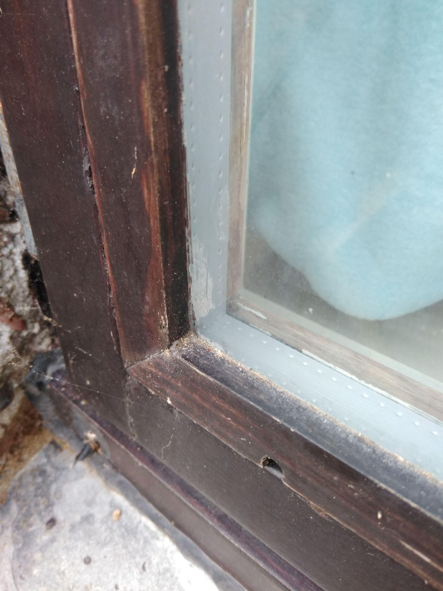

zoothorn Posted April 8, 2023 Share Posted April 8, 2023 Hi chaps, happy Easter weekend to y'all. (DG = Double Glazed) I've replaced typical 28mm upvc DG units before, removing beads etc.. but my old folks have (most shot/ fogged) older -thinner- DG pane units, set in timber frames. Now, I can't see any way to replace the DG panes though. No beads. The only reference I can think of, to determine what thickness the units are, is they look a similar thickness to a cd case. Perhaps 2mm glass, silver 8mm centre strip, 2mm glass ? (No idea, guess figures- I have no way to actually measure). Could anyone help? Thanks, Zoot Link to comment Share on other sites More sharing options...

zoothorn Posted April 8, 2023 Author Share Posted April 8, 2023 3 hours ago, Gone West said: I think there must be, how were the glazing units fitted? Hi chaps, thanks.. @SteamyTea 4-8-4 it surely must be then. Great that's the thickness sorted. As to beading- well all I can see is what lookslike putty, but hardened perhaps by time, outside, holding the DG units in.. instead of beading. Would this be right? Link to comment Share on other sites More sharing options...
Gone West Posted April 9, 2023 Share Posted April 9, 2023 12 hours ago, zoothorn said: Would this be right? I've not seen DG units fitted with putty and I thought the oils in the putty reacted with the seal around the edge of the DG unit. Link to comment Share on other sites More sharing options...
joe90 Posted April 9, 2023 Share Posted April 9, 2023 56 minutes ago, Gone West said: I thought the oils in the putty reacted with the seal around the edge of the DG unit. Which is probably why they have fogged 🤷♂️, I don’t see why (like @SteamyTea) you can’t use a timber quarter moulding as long as there is room! And bed them on glazing silicone. Link to comment Share on other sites More sharing options...

SteamyTea Posted April 10, 2023 Share Posted April 10, 2023 19 hours ago, joe90 said: 20 hours ago, Gone West said: I thought the oils in the putty reacted with the seal around the edge of the DG unit. Which is probably why they have fogged My old ones where puttied in. Siliconed the new ones in, and they have still blown, except for a couple of them. I think I know why. 7 hours ago, Hobbiniho said: glasdickenmesser Measure frame thickness (a), measure one side to the glass (b) measure other side to the glass (c) a - (b + c) = glass thickness Link to comment Share on other sites More sharing options...

zoothorn Posted April 10, 2023 Author Share Posted April 10, 2023 11 hours ago, SteamyTea said: My old ones where puttied in. Siliconed the new ones in, and they have still blown, except for a couple of them. I think I know why. Measure frame thickness (a), measure one side to the glass (b) measure other side to the glass (c) a - (b + c) = glass thickness Of course, logical, thanks ST. As to whether it -is- putty.. well, in my very limited knowledge I can't think of any other material it might be. A pic of the bead side.. if it could give any clue: Link to comment Share on other sites More sharing options...
SteamyTea Posted April 10, 2023 Share Posted April 10, 2023 (edited) 4 minutes ago, zoothorn said: A pic of the bead side.. if it could give any clue: Try culling into it with a sharp knife. Whoops, did I type culling, meant to say cutting. Culling it what need to happen to idiots. Edited April 10, 2023 by SteamyTea Link to comment Share on other sites More sharing options...
craig Posted April 10, 2023 Share Posted April 10, 2023 1 hour ago, zoothorn said: Of course, logical, thanks ST. As to whether it -is- putty.. well, in my very limited knowledge I can't think of any other material it might be. A pic of the bead side.. if it could give any clue: That’s putty, just been painted over. Link to comment Share on other sites More sharing options...
