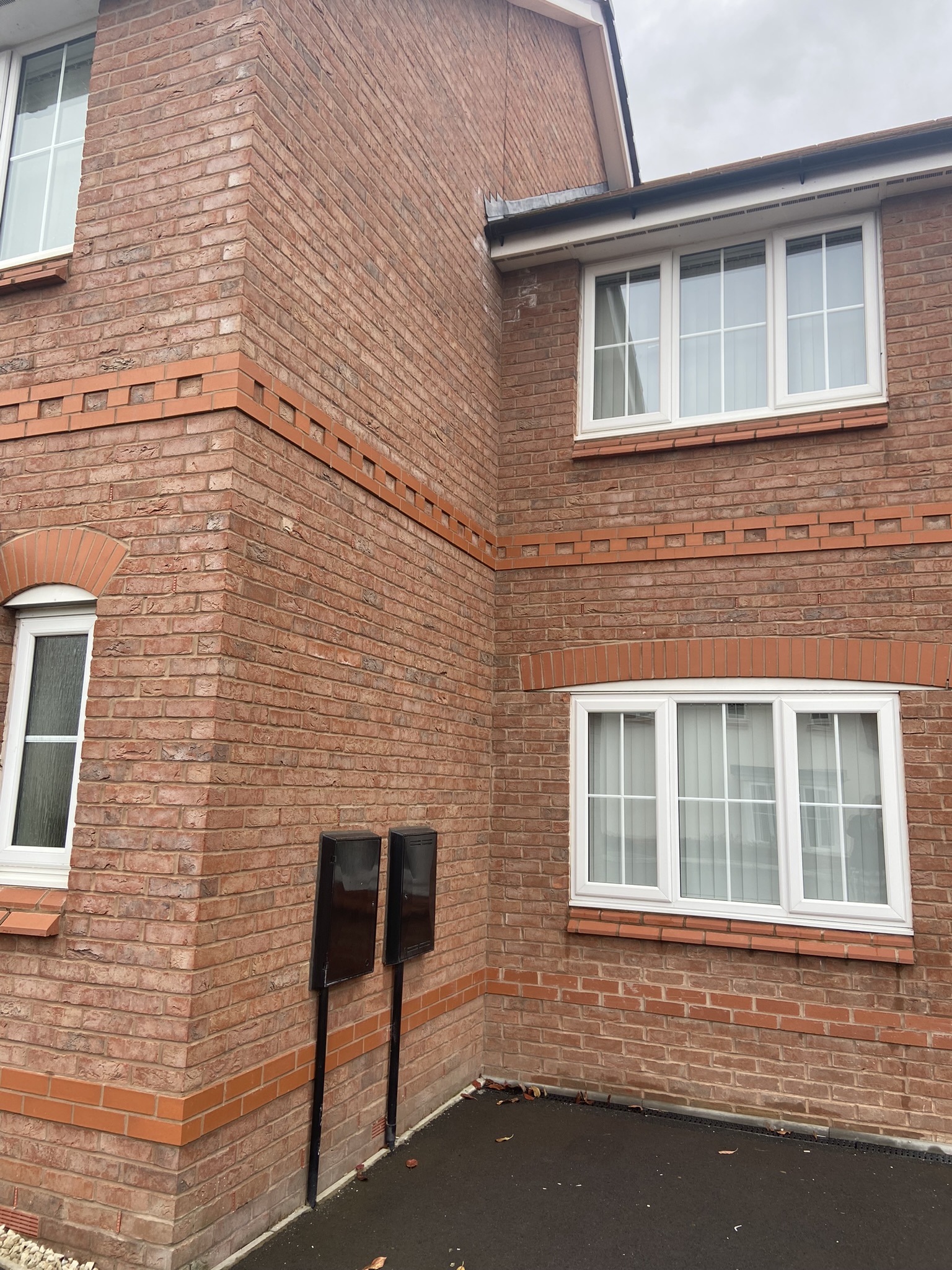

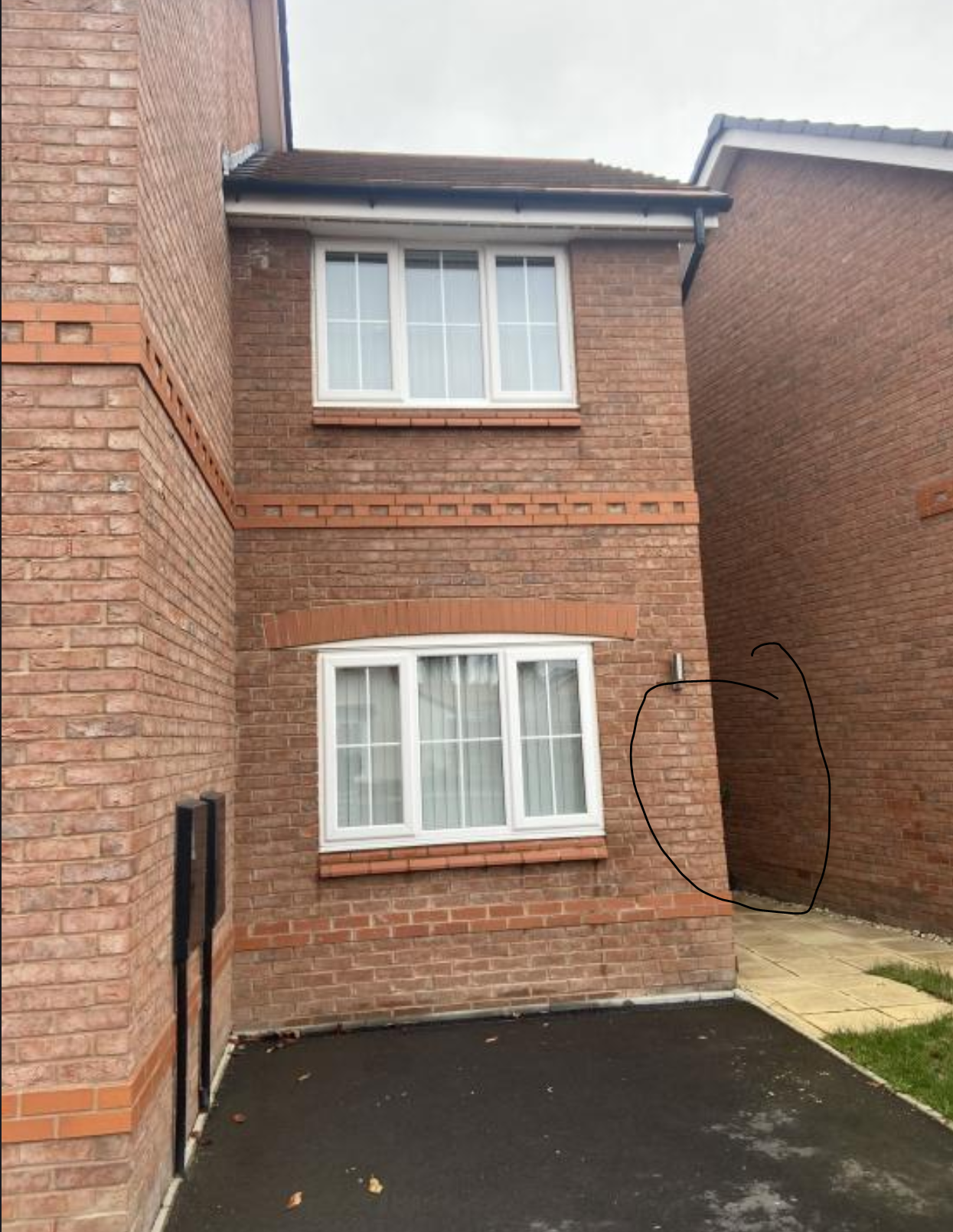

Lal Posted April 1, 2023 Share Posted April 1, 2023 It’s a 4 year old house Link to comment Share on other sites More sharing options...
Onoff Posted April 1, 2023 Share Posted April 1, 2023 Salts coming out? Link to comment Share on other sites More sharing options...
Lal Posted April 1, 2023 Author Share Posted April 1, 2023 1 minute ago, Onoff said: Salts coming out? Is this normal and how long will it last? Link to comment Share on other sites More sharing options...
Canski Posted April 1, 2023 Share Posted April 1, 2023 Efflorescence. And that’s very mild. I’ve seen some shockers in my life. 1 Link to comment Share on other sites More sharing options...

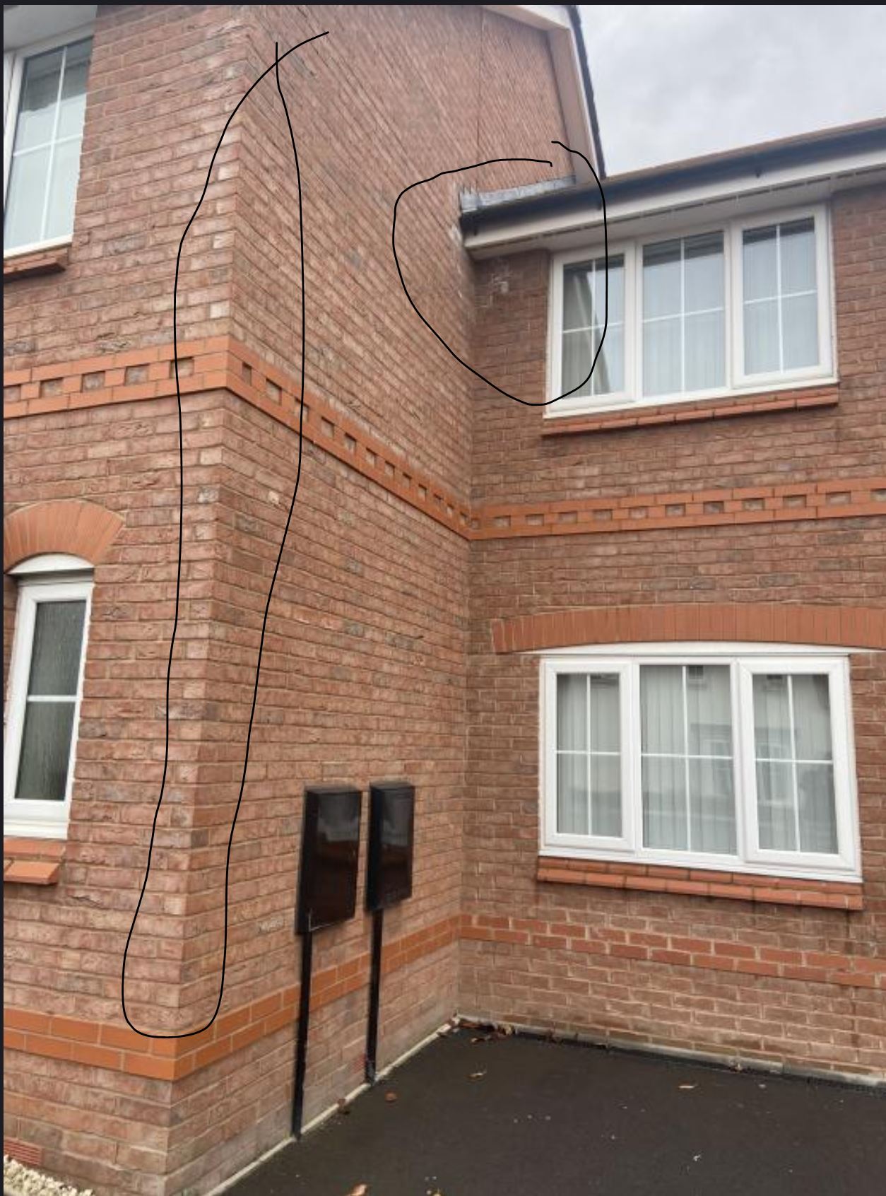

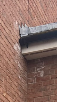

Radian Posted April 1, 2023 Share Posted April 1, 2023 It can mean that water is present there. It looks like the gutter might be overflowing at the end (in the corner). Just under the soffit should be dryer than the rest of the wall but that bit looks like it's getting wetter: If it's not the fault of the gutter, it might be the flashing or possibly the vertical expansion gap. I'd be investigating it if it were mine. 1 Link to comment Share on other sites More sharing options...
Brickie Posted April 2, 2023 Share Posted April 2, 2023 9 hours ago, Radian said: It can mean that water is present there. It looks like the gutter might be overflowing at the end (in the corner). Just under the soffit should be dryer than the rest of the wall but that bit looks like it's getting wetter: If it's not the fault of the gutter, it might be the flashing or possibly the vertical expansion gap. I'd be investigating it if it were mine. As above,worth checking during a downpour,but it could just be that the Dow pipe wasn’t installed immediately during construction,and that zone of brickwork took more than its fair share of rain as a result. Link to comment Share on other sites More sharing options...

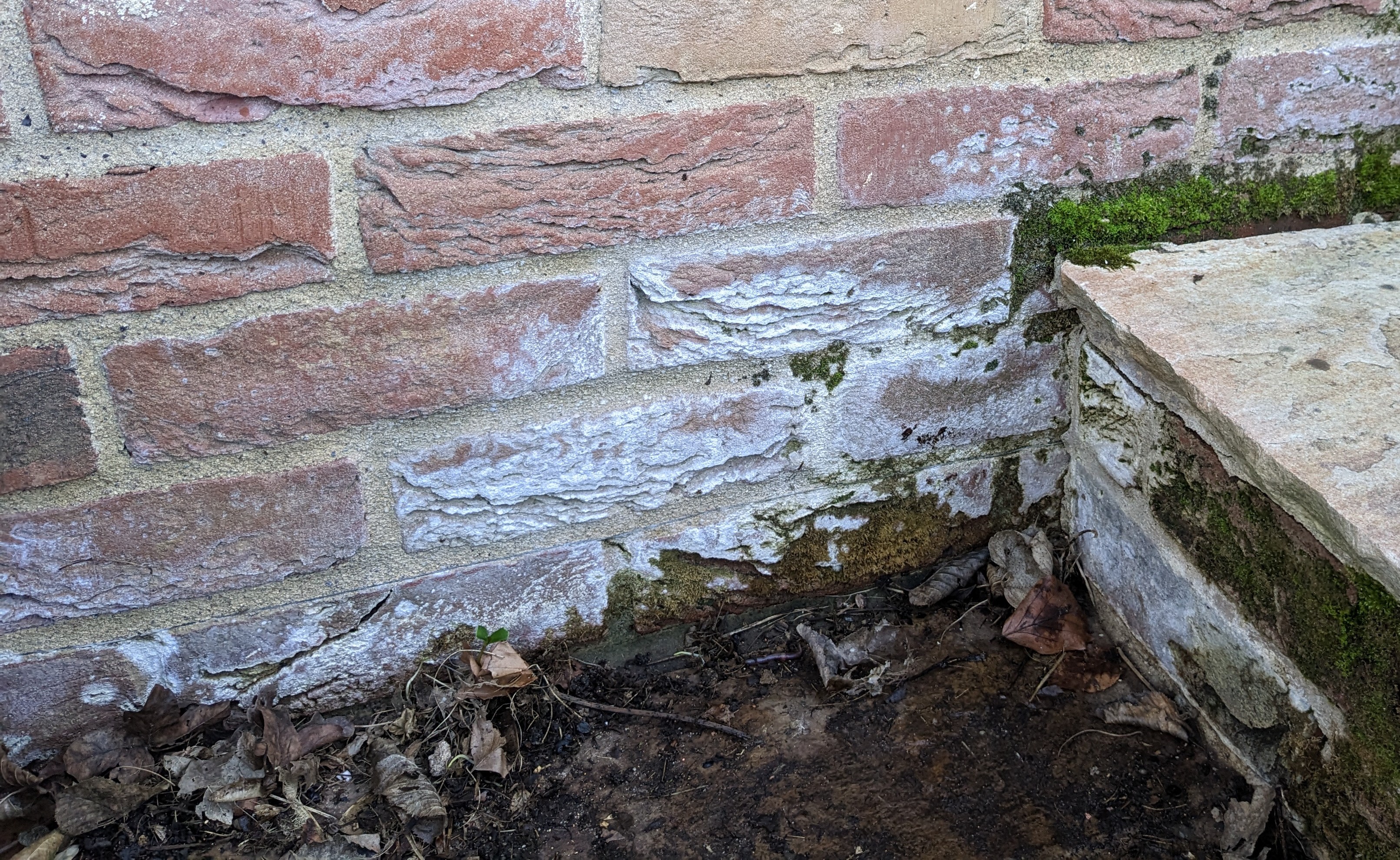

Temp Posted April 2, 2023 Share Posted April 2, 2023 Efflorescence. Usually harmless. Salt coming out of the bricks or mortal. Can sometimes indicate that area is wetter than others for some reason - eg the gutter overflow others mentioned. Might just be recent heavy wind blowing rain into that corner. We have it on our house in a few areas below the damp proof course. Generally it's best left alone. It should eventually stop but can take many years to dissapear. Some people advise to use or not use a pressure washer - they can push more water into the brick and make it reappear worse. Others suggest various products to put on it. A stiff brush can be used but beware of marking up the bricks. A broom might be OK but not a really aggressive wire brush. I would leave it alone unless it really bothers you. Link to comment Share on other sites More sharing options...
Lal Posted April 2, 2023 Author Share Posted April 2, 2023 2 hours ago, Temp said: Efflorescence. Usually harmless. Salt coming out of the bricks or mortal. Can sometimes indicate that area is wetter than others for some reason - eg the gutter overflow others mentioned. Might just be recent heavy wind blowing rain into that corner. We have it on our house in a few areas below the damp proof course. Generally it's best left alone. It should eventually stop but can take many years to dissapear. Some people advise to use or not use a pressure washer - they can push more water into the brick and make it reappear worse. Others suggest various products to put on it. A stiff brush can be used but beware of marking up the bricks. A broom might be OK but not a really aggressive wire brush. I would leave it alone unless it really bothers you. Thank you for your response. Is it normal for bricks to get wet under DPC and have efflorescence as a result? I think ours get worse during the winter times, but not so bad during summer Link to comment Share on other sites More sharing options...
Dave Jones Posted April 2, 2023 Share Posted April 2, 2023 4 minutes ago, Lal said: Thank you for your response. Is it normal for bricks to get wet under DPC and have efflorescence as a result? I think ours get worse during the winter times, but not so bad during summer yep Link to comment Share on other sites More sharing options...
Temp Posted April 2, 2023 Share Posted April 2, 2023 4 hours ago, Lal said: Thank you for your response. Is it normal for bricks to get wet under DPC and have efflorescence as a result? I think ours get worse during the winter times, but not so bad during summer Yes, below DPC they soak up water from the ground. Not all bricks suffer from it. Its actually possible to buy bricks with a low rating for Efflorescence. Just like you can get them with different levels of frost resistance. Just for info, this is our worst patch. Its where water runs down some steps. Me not clearing leaf debris probably doesn't help. Link to comment Share on other sites More sharing options...
Temp Posted April 2, 2023 Share Posted April 2, 2023 Some bricks are remarkably porus. I once filled a round bucket with some of our bricks. I then filled up all the spaces with water from a hose. They fizzed and popped and soaked up all the water leaving just an inch or so in the bottom. Link to comment Share on other sites More sharing options...
saveasteading Posted April 2, 2023 Share Posted April 2, 2023 30 minutes ago, Temp said: Me not clearing leaf debris probably doesn't help. Not only that but it is a damp little corner with reduced air flow. Not a problem. Worth clearing the moss and any soil with it too, as that holds water. The salts might just fall off come the summer, or wash them off then. Link to comment Share on other sites More sharing options...

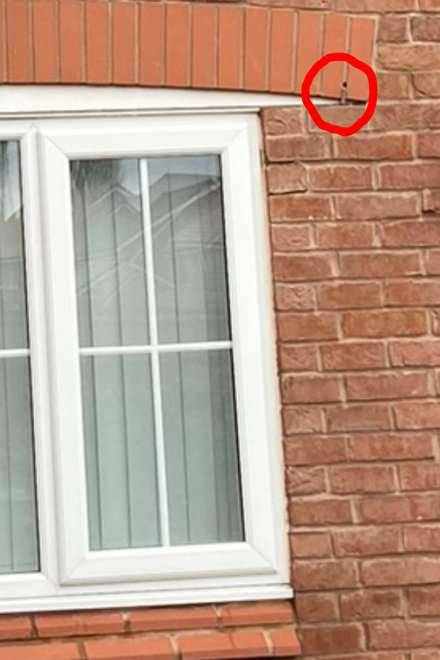

Blooda Posted April 3, 2023 Share Posted April 3, 2023 You have a small bit of mortar slipped here, worth getting it fixed. If those are fabricated arches, it could pop the slips off, worth fixing even if they are real arches. Stitch in time Link to comment Share on other sites More sharing options...

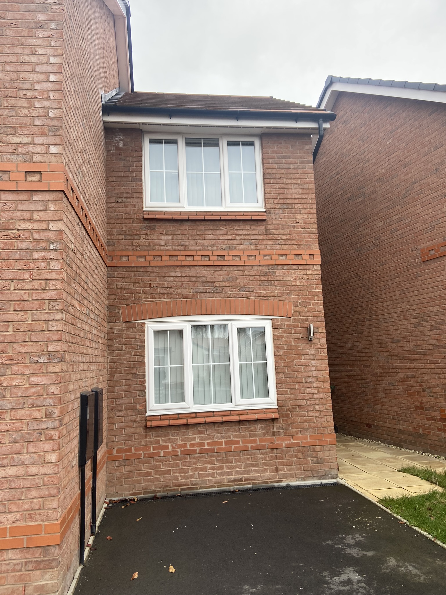

Dave Jones Posted April 3, 2023 Share Posted April 3, 2023 in my experience you only every get persistent effervescence where the brickwork gets wet constantly. You can see this on your photo's, something is causing the corner of the building to get wet by looks, guttering ? Stop dripping/leaking directly onto the brickwork and 99% of it will disappear. 1 Link to comment Share on other sites More sharing options...
saveasteading Posted April 3, 2023 Share Posted April 3, 2023 Lal, im wondering where your dpc is, perhaps too close to the ground. Looking at the pic with tarmac, there is one course of bricks that looks very dark and damp. The next 2 courses have varying wetness too, perhaps splashing up from the tarmac. Link to comment Share on other sites More sharing options...
