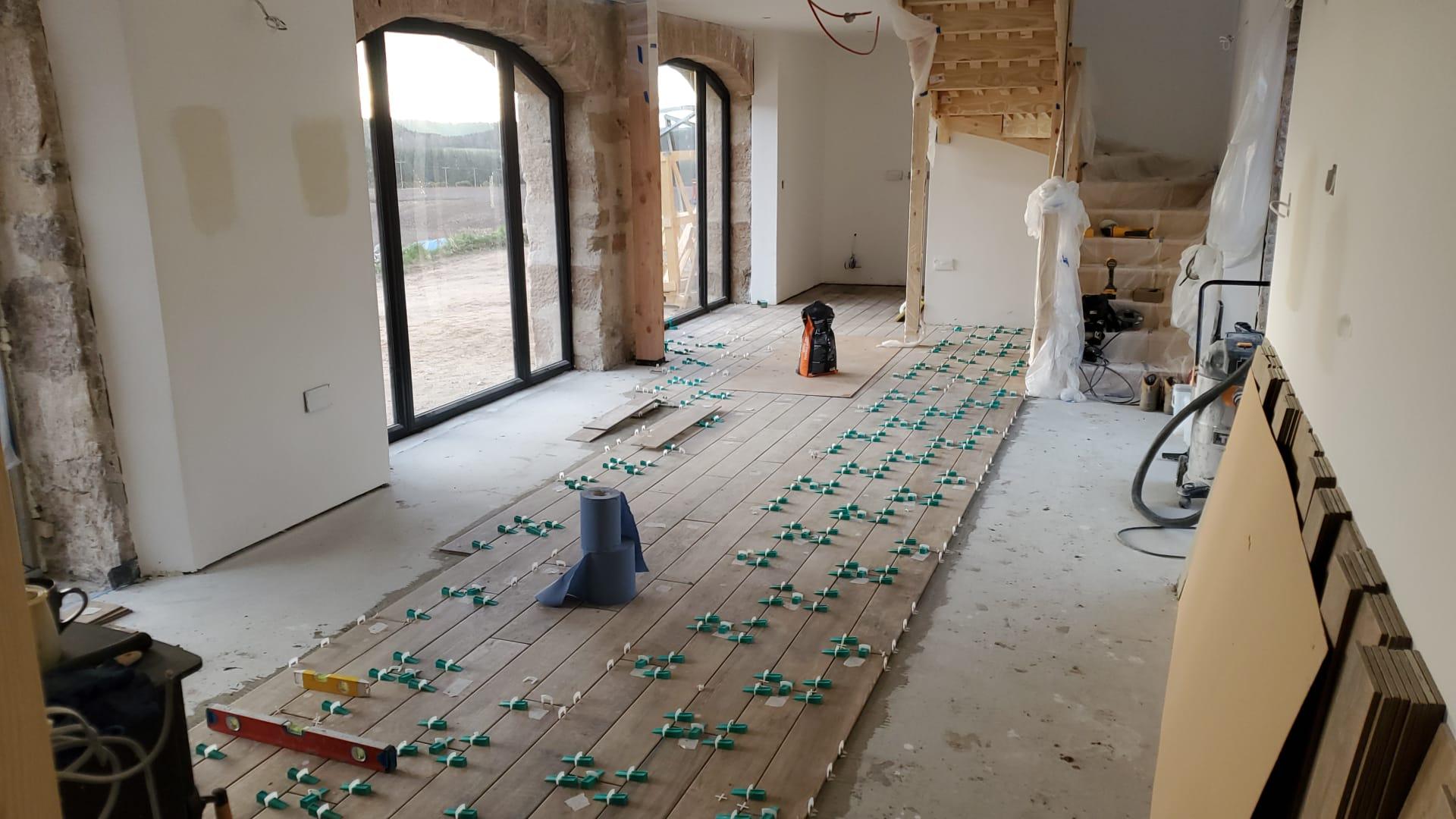

The team were laying more today, and used the system.
It provides a little more smoothness, but they find that the pushing of the wedges shifts the tile and the joint is inconsistent.
But they also say it is going much faster with the levelling system, and perhaps they will find a solution to the joints.

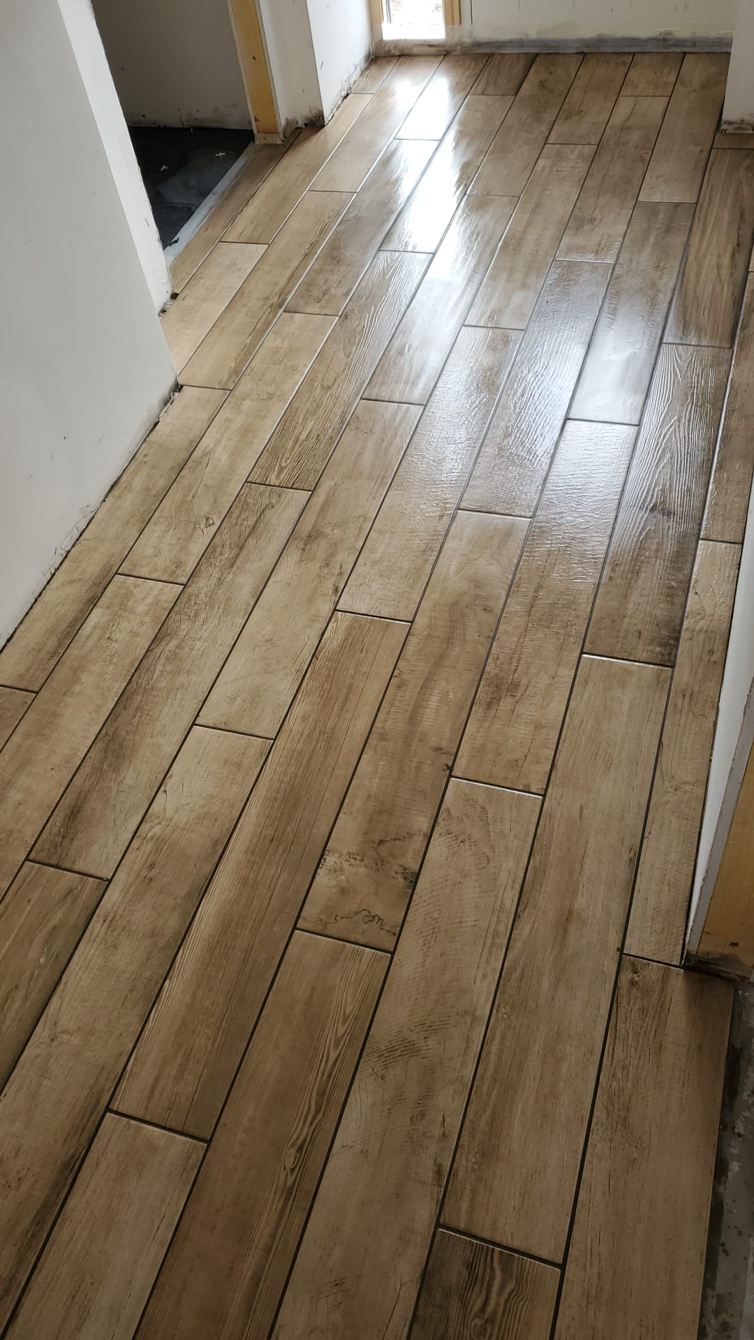

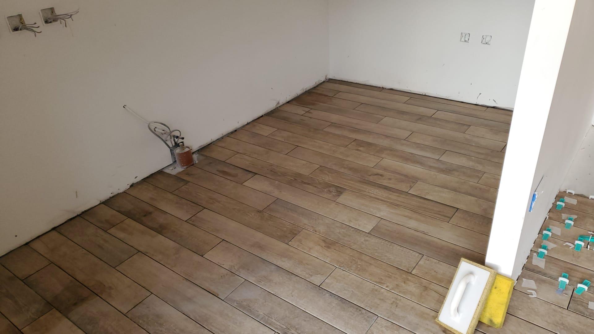

So it is going well with the levelling clamps. Pretty well essential for these 900 x 150 tiles, and quicker than manually minimising the steps.
Achieving about 1m2 per hour with whole tiles, but will prob get faster.
