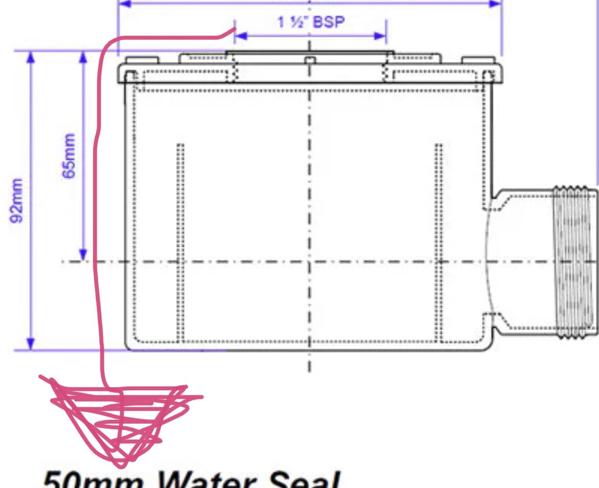

Crunchynut Posted May 28, 2023 Share Posted May 28, 2023 Just as a slight aside in case it helps others. With the original problem of hair/soap blocking the trap exit, I have found the best approach is to remove the dip tube (as you eventually did) and then rather than start pulling strands of hair etc out, instead get some long nose pliers, grip the first strands and start to twizzle the pliers and so wrap the hair etc round them. This way you grow an increasingly strong grip on the offending mass, which could be a good few inches long, which is steadily pulled out. The alternative method of just pulling out what you can reach can result in having no strands left to pull on, but the mass is still there. 1 Link to comment Share on other sites More sharing options...

Adsibob Posted May 28, 2023 Author Share Posted May 28, 2023 Trying to bring the discussion back on topic, I checked the way I had reinserted the drain, and it’s possible I hadn’t replaced Everything exactly at it was; but at most we are talking about 1mm of difference. I pushed the drain piece down by that 1mm and have now been running the shower hose directly into the drain for 5 minutes, to see if I can recreate the leak. Nothing. Very odd. So either that 1mm difference in the position of the second item (the little 9cm tube) made a difference, or the leak is coming from elsewhere. I guess to see if it’s coming from elsewhere, I need to hose the edges of the shower area, and not just run the shower directly into the drain. But I’m too scared! 2 Link to comment Share on other sites More sharing options...

Adsibob Posted May 28, 2023 Author Share Posted May 28, 2023 (edited) Okay, so I did it, only for three minutes, but flow rate is pretty high, so easily 45L or so. No leak. Maybe it was that 1mm difference that caused some water to travel like this: The leak was pretty tiny, we are talking no more than 30 to 50ml of water after a 8 minute shower. Edited May 28, 2023 by Adsibob Link to comment Share on other sites More sharing options...

dpmiller Posted May 29, 2023 Share Posted May 29, 2023 I'd put money on the top weld of the housing having a crack in it Link to comment Share on other sites More sharing options...
Nickfromwales Posted May 29, 2023 Share Posted May 29, 2023 9 hours ago, dpmiller said: I'd put money on the top weld of the housing having a crack in it Would be a good guess, seeing as it took so little to provoke this into leaking. Link to comment Share on other sites More sharing options...
Adsibob Posted May 29, 2023 Author Share Posted May 29, 2023 21 hours ago, Nickfromwales said: Would be a good guess, seeing as it took so little to provoke this into leaking. The leak is back. Will speak to builder about this tomorrow. Worst case scenario, will the wet room need to be broken up and re-tiled, or can it all be redone via cutting into the utility room ceiling? Link to comment Share on other sites More sharing options...
Big Jimbo Posted May 30, 2023 Share Posted May 30, 2023 If it is the water trap then it should be fixable from below. (Hole in the ceiling) Link to comment Share on other sites More sharing options...
Pocster Posted May 30, 2023 Share Posted May 30, 2023 (edited) I wonder if it’s one of these cheap traps . When I installed my shower tray no matter how hard I tried the supplied trap leaked . Ordered a new ‘better’ one and could tell instantly as I installed it what a better fit it was . Not leaked since . All traps are certainly not born equal . Edited May 30, 2023 by pocster Link to comment Share on other sites More sharing options...
Adsibob Posted May 30, 2023 Author Share Posted May 30, 2023 (edited) 10 hours ago, pocster said: I wonder if it’s one of these cheap traps . When I installed my shower tray no matter how hard I tried the supplied trap leaked . Ordered a new ‘better’ one and could tell instantly as I installed it what a better fit it was . Not leaked since . All traps are certainly not born equal . Any recommendations as to what to look for - what makes a trap apparently “better”, as opposed to actually better which would only be determinable after years of leak proof service. Edited May 30, 2023 by Adsibob Link to comment Share on other sites More sharing options...
