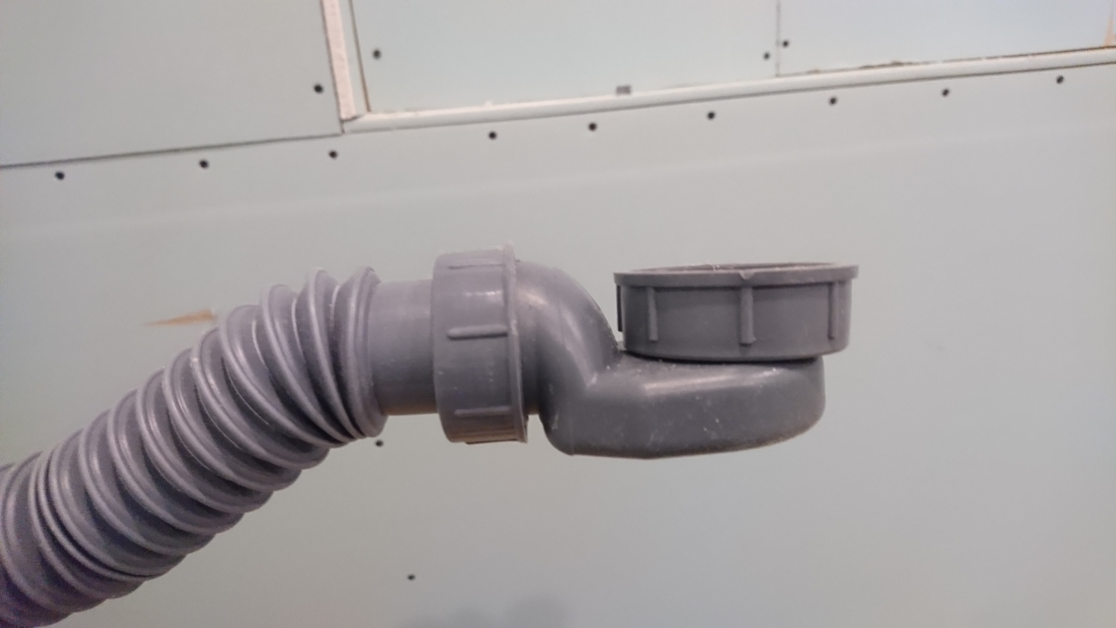

jamiehamy Posted July 31, 2017 Share Posted July 31, 2017 Wondered folks thoughts on this before I go beyond point of no return. Bath is free standing stone, but on a raised area so have room below and arm access to connect. Is this trap going to be up to the job? Or should I fit a conventional one? It'll be a wee bit more tricky but should manage it. This one looks a bit puny and not sure if it'll drain quick enough? If I fit a conventional should it just be a p trap since I won't have access to a bottle? Link to comment Share on other sites More sharing options...
Russell griffiths Posted August 1, 2017 Share Posted August 1, 2017 I have just brought a trap for a shower from a British company called mcalpine have a look on the web, I didn't know so many existed. Have you seen a trap that is fitted from above rather than below? I had one on a previous bath it fits to a flexible pipe like you have you hold it in position on the floor with a bit of tape to hold it in place then put the bath in position and reach through the hole in the bath with a supplied hook thingy lift into position and drop the stainless grill on and put a stainless screw in, it pulls it up tight under the bath so you don't go under it at all. I think they are designed for built in units with no actual access underneath. Link to comment Share on other sites More sharing options...
Nickfromwales Posted August 1, 2017 Share Posted August 1, 2017 If there's room for a full depth trap then I'd swap it out now tbh. That trap is a compact under slung trap for dog leg baths, ( where the pipework can be seen from underneath ), but, iirc, your bath sits flat on the floor ? If so you simply don't need that one and can return it for a credit hopefully. Youll already ( ? ) have the waste outlet I assume so this is only a matter of which trap to fit, so I'd go for a nice robust trap like this one and fit'n'forget . Link to comment Share on other sites More sharing options...
jamiehamy Posted August 1, 2017 Author Share Posted August 1, 2017 All the other traps I have are McAlpine - quality seems very good. If there was a problem I could access by removing a tile but I'll go for something like that - thanks both! Link to comment Share on other sites More sharing options...
ProDave Posted August 1, 2017 Share Posted August 1, 2017 A problem with that trap is it only has a very small seal. You would have to disconnect and block it off to pressure test the pipework. I had this argument with building control on my last house. the final pressure test I could only pump it up to 75mm, not the required 100mm. At that point it started blowing bubbles through the shower traps. BC tried to insist I disconnect and cap off the shower traps for the test but I refused as that would have meant ceiling down. In the end he accepted the test. But that trap looks a lot less than 75mm seal even? Link to comment Share on other sites More sharing options...

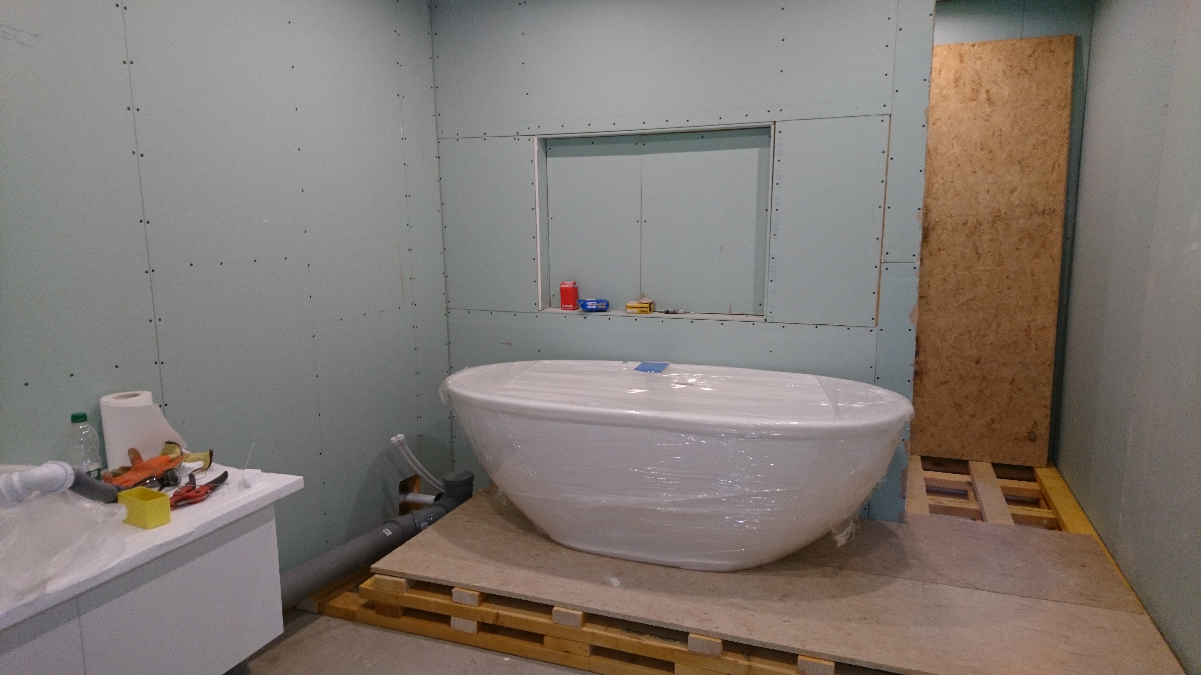

jamiehamy Posted August 1, 2017 Author Share Posted August 1, 2017 Pic of a trial fit. Before you say anything - the inset on wall to be remade to centre on bath! You can see my awkward soil pop-up on left - with AAV this is too high so will be building that bit out to level on basin - no hardship as provides place for Bath smellies etc... Link to comment Share on other sites More sharing options...
