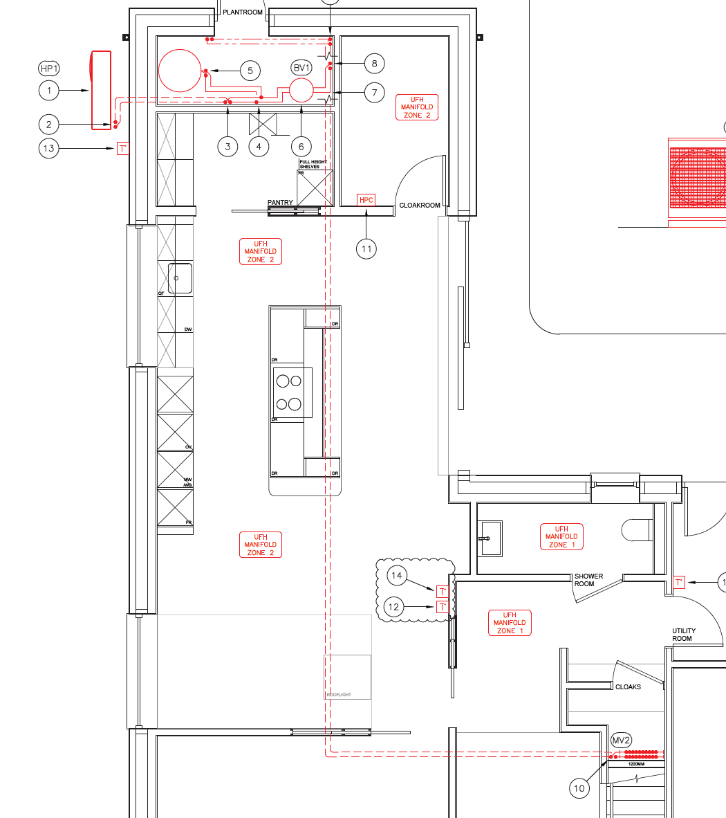

Mr Blobby Posted March 29, 2023 Posted March 29, 2023 (edited) So I'm trying to finalise services through the KORE slab and would like some help on heat pump and manifold connections please. So, for context, the house is masonry (250) cavity on kore slab to passive standard. ASHP will sit outside the plant room at the rear of the property. UVC and buffer tank in plant room. UFH manifold in centre of house under stairs. Two questions: 1. ASHP flow and return, is it: (a) 32mm pre-insulated FR pipe through floor to ASHP. Its rocky at about 400mm and so with the bend radius requiring a deep hole is it worth it? or (b) seperate plastic insulated pipes through a hole in the wall. This seems simpler, but what about airtightness etc? Do I build in a pipe or core drill after? Does that matter? 2. Flow and return to UFH manifold from buffer tank. What pipe specification? Where to run it. Within the floor insulation or under the insulation? Or not in the floor? Please help me decide before I meet the plumber and builder to decide this stuff next week. (who will probably ask me why I'm not installing an oil-fired boiler like everyone else 🙄) Edited March 29, 2023 by Mr Blobby
Nick Laslett Posted March 29, 2023 Posted March 29, 2023 I think with the ASHP being on the same wall as the plant room, a pipe connection through this route would be the more simple option. I have the 32mm insulated pipe under the foundation, and its bend radius makes locating it in the ideal location a real challenge. Air tightness is easily covered. You might even struggle to get the insulated pipe to fit looking at your floor plan. 1 1

markocosic Posted March 29, 2023 Posted March 29, 2023 Through wall in 28 mm copper for <10 kW. You'd core through larger (say 70-80 mm), lag the pipes through the hole with the watertight/airtight lagging, then foam between the lagging and the masonry. 1

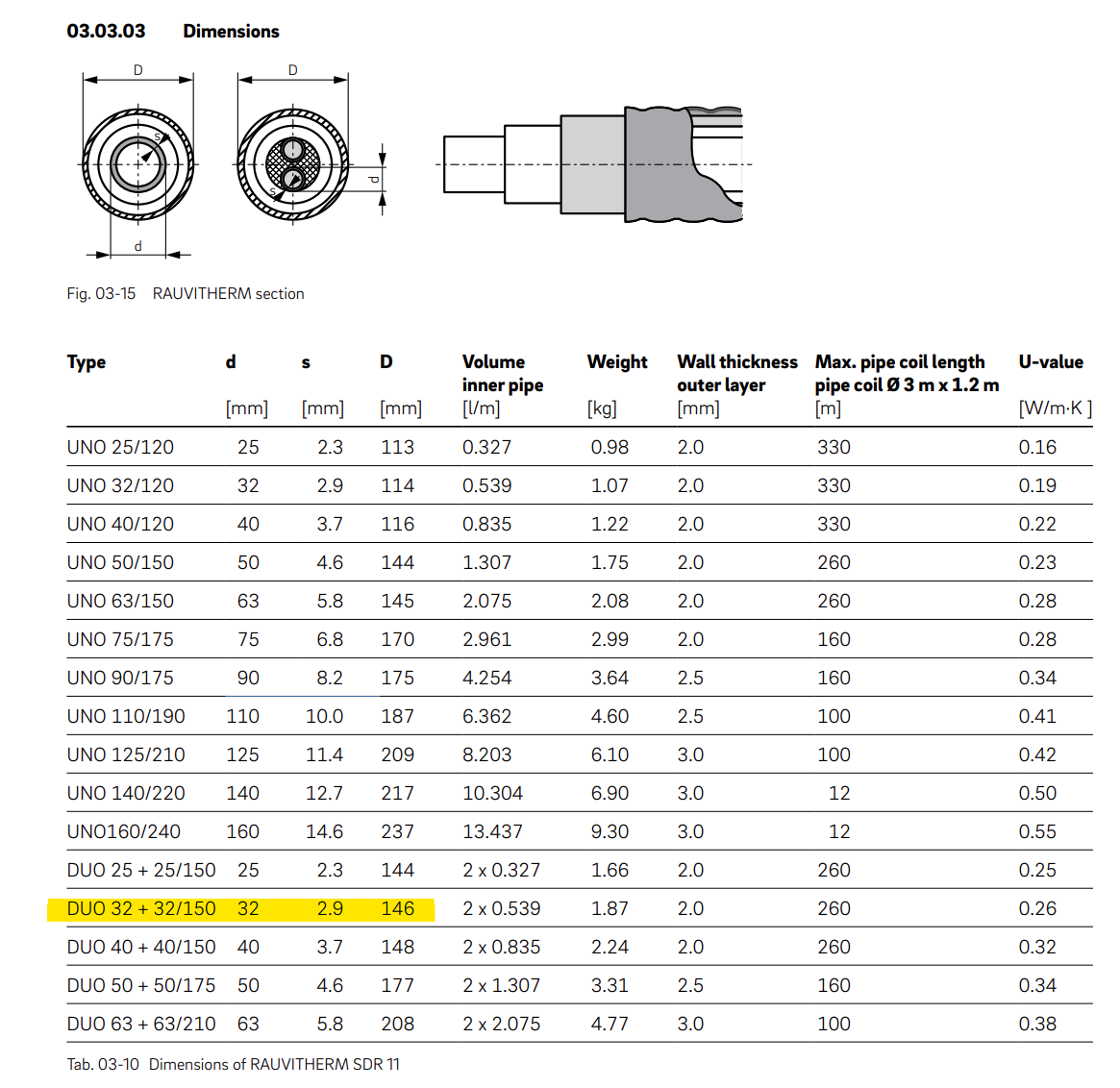

IanR Posted April 13, 2023 Posted April 13, 2023 2 hours ago, Mr Blobby said: The question is then, will the two 28mm pipes, with insualation like armaflex or whatever, fit through a long radius 110 bend ok? Or should I do what the plumber wants and put a 160mm bend in the floor? I used 32/150 Rauvitherm pre-insulated twin duct from Rehau. I don't think you'll get the same performance if you make it up yourself. Ref. https://www.rehau.com/downloads/1042866/district-heating-technical-information.pdf They don't do a Ø28 version though, but the Ø32 connectors/adapters were easy to come by.

PeterW Posted April 13, 2023 Posted April 13, 2023 28x25 Armflex on 28mm PEX is going to give you a 78mm wide pipe that won’t fit side by side with another down a 110mm duct, and will be tight in a 160mm too. Going down to 28x19 is still 66mm, anything less and the heat loss is substantially greater. I’d be going with the pre-insulated stuff and getting it in now as it’s a pain in the arse to get 28mm PEX through ducts at the best of times.
