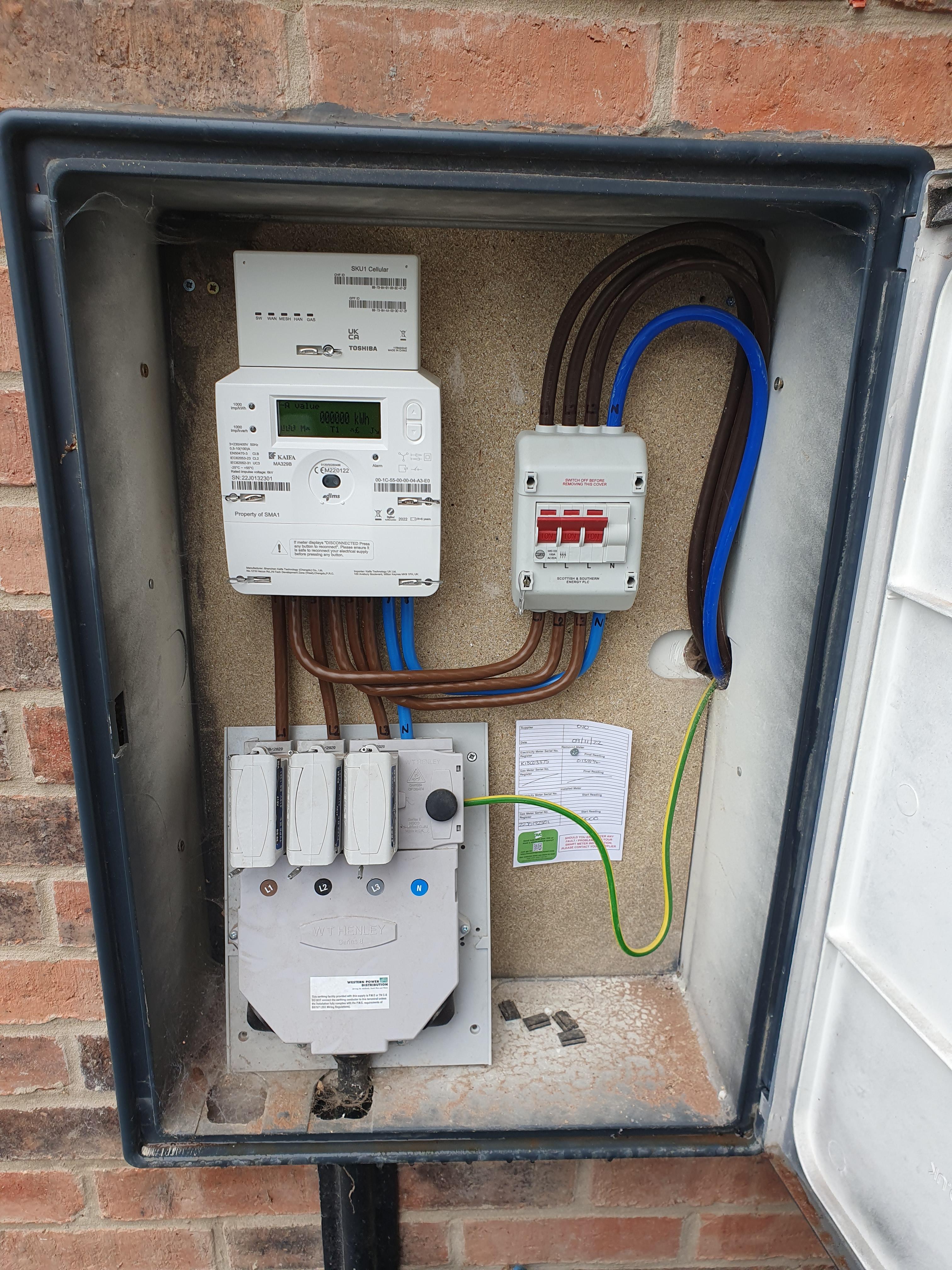

MarkW1979 Posted March 29, 2023 Share Posted March 29, 2023 So I paid for a single phase installation from SPEnergy and put up the appropriate sized meter box for single phase but I have just come back to find that a 3 phase supply has been installed and it occupies quite a lot of the box. My question is whether the meter will now fit in the box and also whether I need to let Octopus know it is 3 phase - who are coming to install the new meter next month? Thanks in advance! Mark Link to comment Share on other sites More sharing options...
crispy_wafer Posted March 29, 2023 Share Posted March 29, 2023 (edited) I'd double check with your DNO that it is actually a 3 ph supply. DNO's tend to install these three phase fuse units and only install a single fuse inside the carrier. If it turns out that it is 3 ph then it's your choice, you can get a 3ph meter, or just get a 1ph meter and ignore the extra phases. Edited March 29, 2023 by crispy_wafer Link to comment Share on other sites More sharing options...
Alan Ambrose Posted March 29, 2023 Share Posted March 29, 2023 I suspect you'll just about have enough room. Link to comment Share on other sites More sharing options...
Nickfromwales Posted March 29, 2023 Share Posted March 29, 2023 I think a lot of DNO's are now fitting 3ph heads regardless, in an attempt to start some smarter thinking / future-proofing. You can have 1, 2 or 3 phases connected, depending upon your connected loads / if you want oodles of PV / rapid 3ph EV charger etc. Link to comment Share on other sites More sharing options...
MarkW1979 Posted March 29, 2023 Author Share Posted March 29, 2023 Thanks guys. I checked with DNO and it is as a couple of you say - a 3 phase head. I'm still not convinced I can get the smart meter in beside it (if it is the same sized smart meter as I have at home - also fitted by Octopus). Possibly if the unit was moved right the bottom left of the box. I'll have to go back and measure it properly... Link to comment Share on other sites More sharing options...
Nickfromwales Posted March 29, 2023 Share Posted March 29, 2023 The 3ph meter box is physically larger than a 1ph one. Which do you have installed? Google will help. Link to comment Share on other sites More sharing options...
shuff27 Posted March 29, 2023 Share Posted March 29, 2023 If it helps, my 3ph box (as supplied by Westen Power) is approx 54x78cm - the one in your photo looks tiny by comparison. Link to comment Share on other sites More sharing options...

MarkW1979 Posted March 29, 2023 Author Share Posted March 29, 2023 1 hour ago, Mr Punter said: Did the meter box come with ready broken hinges? I really hate the poor quality of the things. Haha! Well spotted. No, but I think the workies from SPEnergy left it open and the door blew off but I have no way of proving the fact that I didn't lock it properly myself! My meter box is for a phase 1 supply - 596mm x 420mm - the one recommended by SPEnergy at the outset. Link to comment Share on other sites More sharing options...
Kelvin Posted March 29, 2023 Share Posted March 29, 2023 That does look rather tight. Link to comment Share on other sites More sharing options...

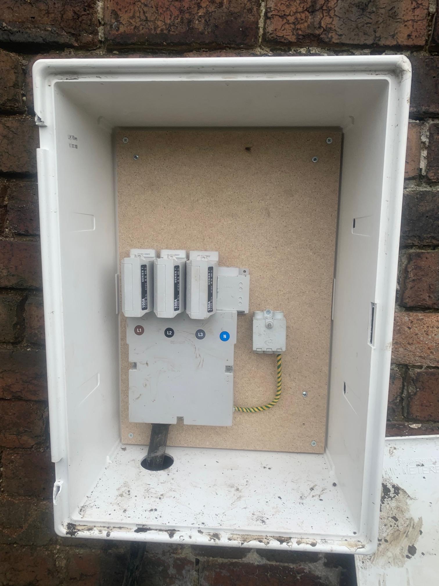

Blooda Posted March 30, 2023 Share Posted March 30, 2023 Looks a bit tight, here's our 3 phase box which is 780mm x 550mm x 225m, with smart meter and various 8 legged creatures. Link to comment Share on other sites More sharing options...
