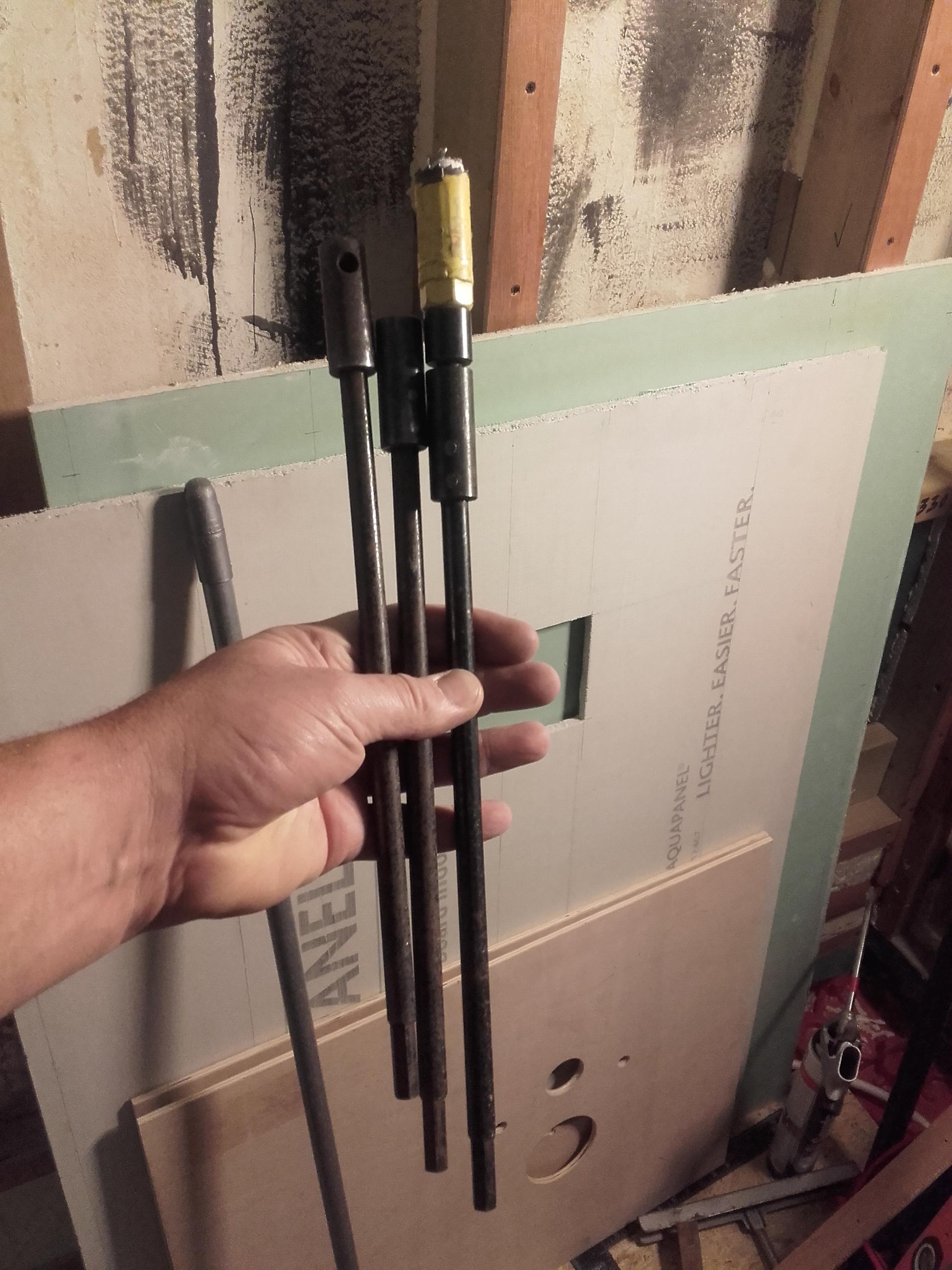

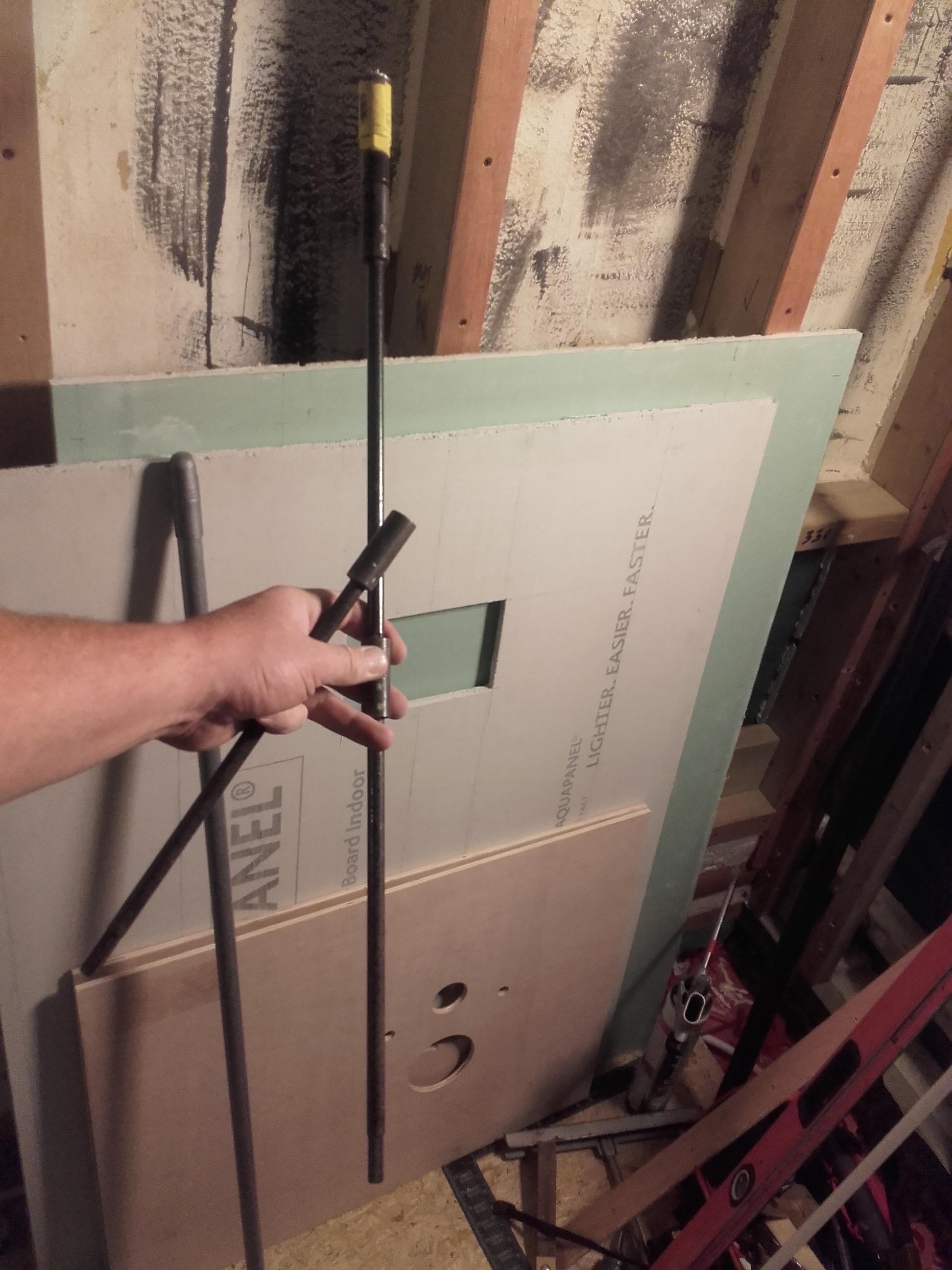

Onoff Posted July 31, 2017 Author Posted July 31, 2017 (edited) On the subject of "reach" and hole saws you can buy these extension bars: I've only got them for the smaller arbour size (11/32" AF). Bloody handy if you want to drill steel a metre away. Bought for a job I can still remember years back and used once or twice since. Of course there's been times I've wished I've had the bars for the bigger 7/16" AF arbours! Another useful one I have is an arbour for the smaller Starretts that fits into ordinary 1/4" bit holders. Edited July 31, 2017 by Onoff

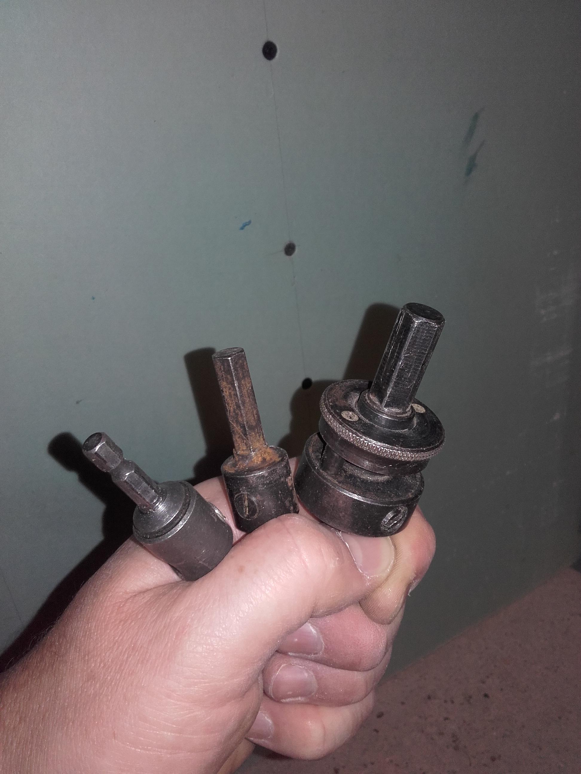

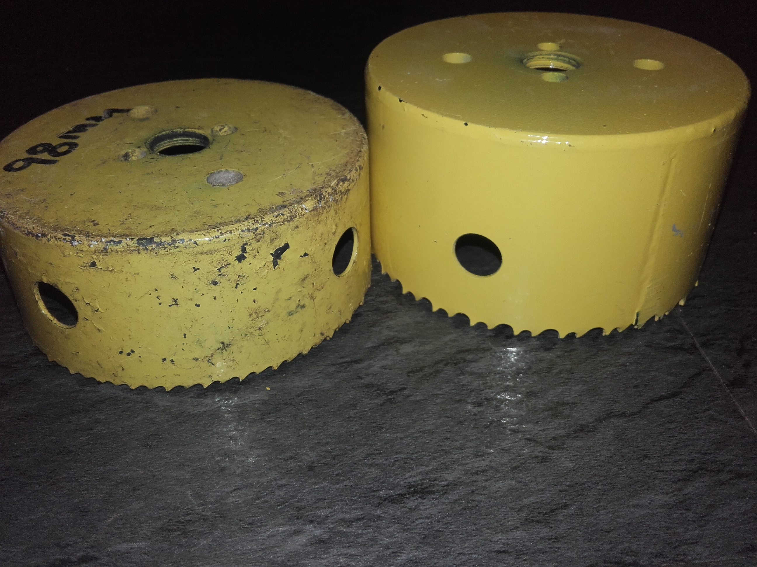

Onoff Posted August 1, 2017 Author Posted August 1, 2017 These look good, to adapt other makes of hole saw for use with the Bosch Progressor arbour. Handy if you've say a 114mm you use for soil etc. https://www.ebay.co.uk/i/181804969464 1
