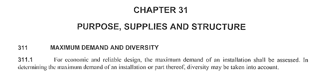

Jeremy Harris Posted July 29, 2017 Share Posted July 29, 2017 Before going too far down the path of looking at massive cables, do a quick diversity calculation. It's very unlikely that you'll be running all the high current loads at the same time, especially if there's only one or two people working in the workshop at any one time. If I add up all the loads in my workshop, and assume they can all be on all the time, I'd need a cable three times bigger than the one I ran down there. Normal diversity rules aren't really suitable for a one-man workshop, so what I did was work out the highest possible load that could be on at the same time. This turned out to be the compressor, a room heater, all the lights, the metal bandsaw (which can be left running when cutting big lumps of stock) and my big pillar drill. The load then came down to around a third of what it would have been with everything on. Even then I think I was pessimistic, as the compressor could only run for a very short time if I was busy cutting and drilling, so I could probably have safely taken a small hit on voltage drop and assumed around 50% of the compressor load. Link to comment Share on other sites More sharing options...

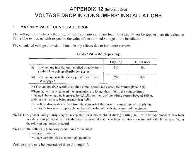

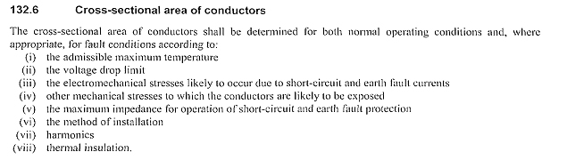

Jeremy Harris Posted July 29, 2017 Share Posted July 29, 2017 (edited) Have a look in the book with regard to cable sizing. There are two main cable sizing criteria, this one (excuse the scan - I only have a paper copy of the 17th Ed): The voltage drop limits are here in the regs: and the diversity guidance, which is non-existent in the regs (but is in additional guidance, but it doesn't really help much for a one-man workshop): There is some older guidance on diversity on the TLC website, here: https://www.tlc-direct.co.uk/Figures/Tab6.2.htm that may be useful, although it relates to the 16th Ed it is still valid, I think. I don't have a copy of the guide on this, maybe one our electricians has an up to date copy. Bear in mind that diversity calcs are often not set in stone in the regs, and the worst consequence of getting them wrong is cable under sizing and nuisance tripping - there isn't a hazard from underestimating the load, as the protective device will be sized to protect the cable, not the load. I opted to do my own diversity calcs based on how I thought I'd use the workshop, with enough of an allowance to be pretty sure that I'd rarely, if ever, get a nuisance trip. One final thing to consider is the effect on earth loop impedance if you are thinking of exporting the PE down the cable. My personal view was that I was happier with my workshop being TT'd, so I didn't export the earth down the long cable from the external CU that supplies it. I fitted a long earth rod through the workshop floor, measured it to make sure it was OK and have used that as the workshop PE. I didn't need to, as the earth loop impedance on the exported earth was within limits, but I felt happier knowing that the concrete workshop floor had a low impedance "connection" to the PE. Edited July 29, 2017 by JSHarris Link to comment Share on other sites More sharing options...

Jeremy Harris Posted July 29, 2017 Share Posted July 29, 2017 (edited) 100m of 50mm² at 100A (absolute max per phase that's allowable by the DNO, I suspect) would give a voltage drop that's OK (3.7%). Not sure where the 70mm² came from, AFAICS 50mm² SWA looks fine, well within spec. Edited July 29, 2017 by JSHarris Link to comment Share on other sites More sharing options...
