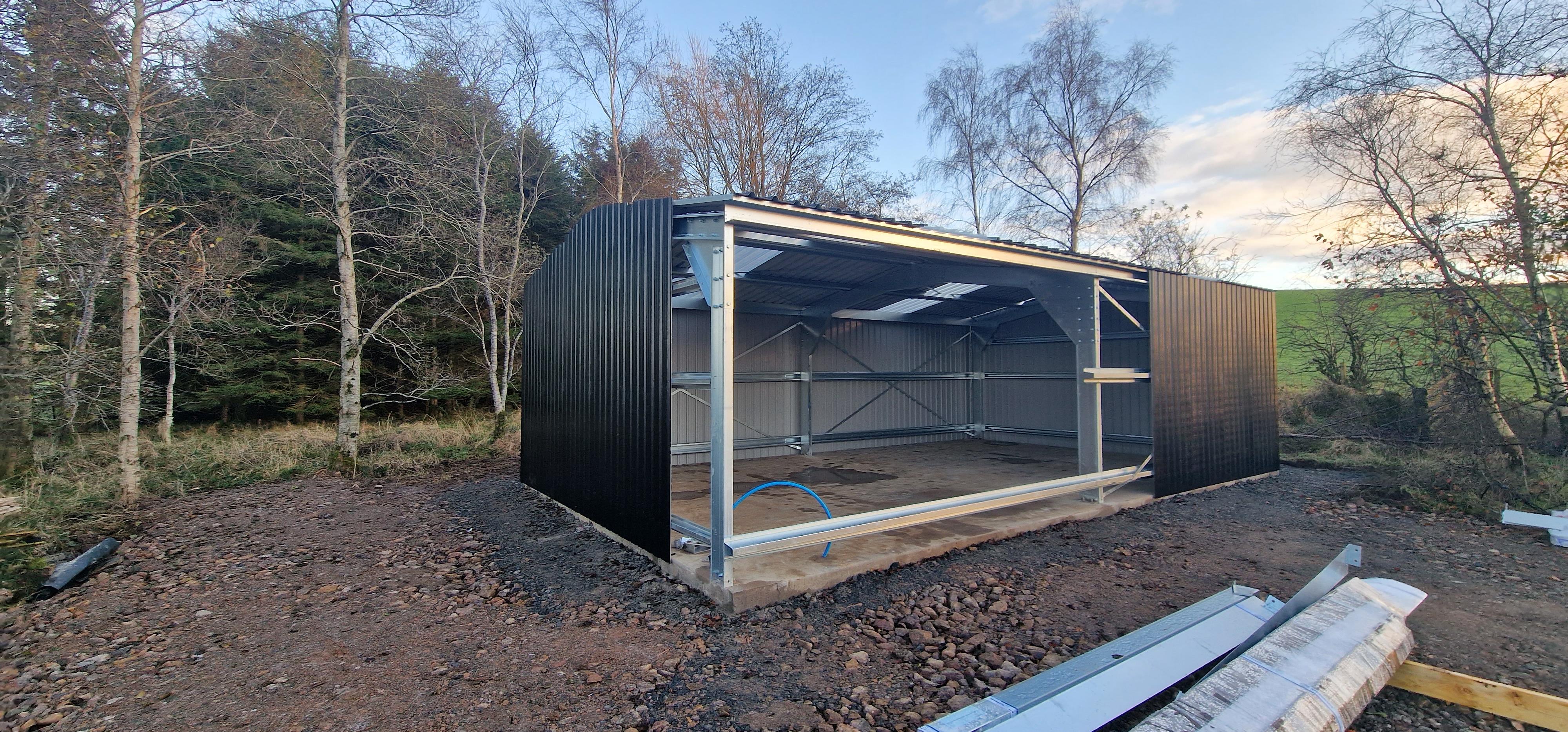

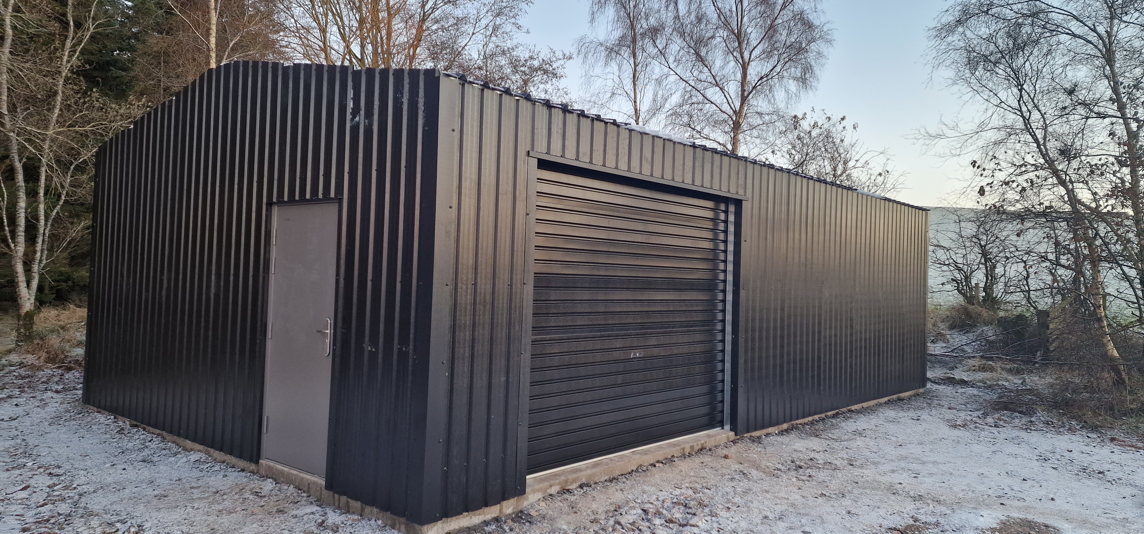

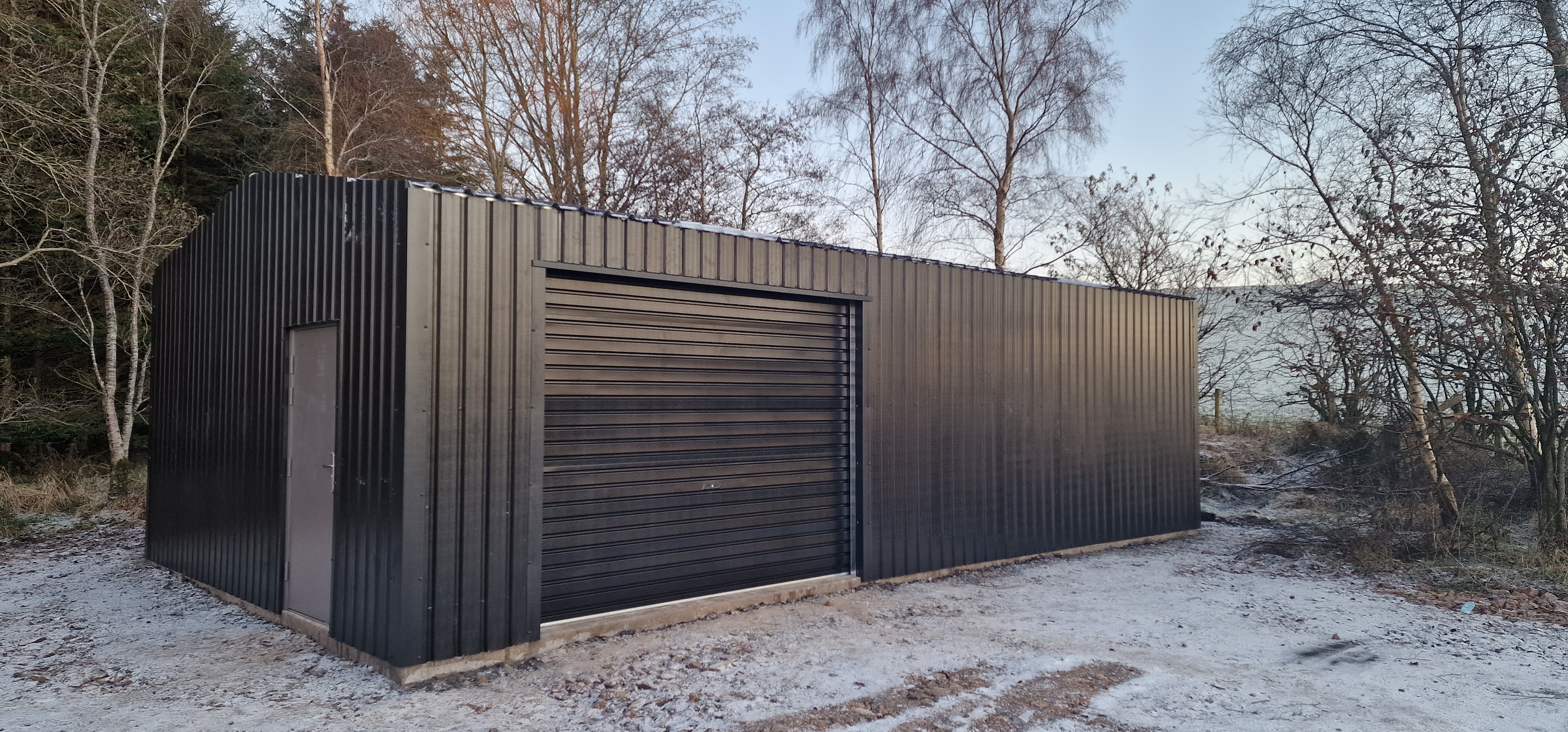

I've got 10m x 6m shed built in December. Murray steel buildings did it...done a great job. A friend did the road and poured the slab.
Mine is the uninsulated version, it's got an anti condensation lining on the roof panels. Works well and I love it.
Less than 4m apex height and 30m2 you don't need planning in Scotland. Mine is less than 4m apex...but the area might be over 30m2......
