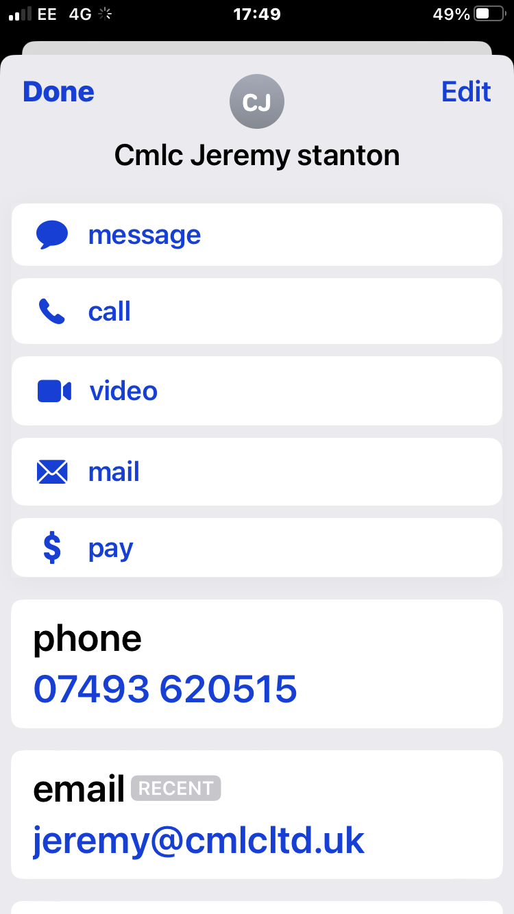

Try Jeremy at CML

Try Jeremy at CML
Thank you! Do you have more information for me to search? When I Googled CML I found a rare type of blood cancer!
It’s CMLC. Very good price for us.
https://www.cmlcltd.uk
