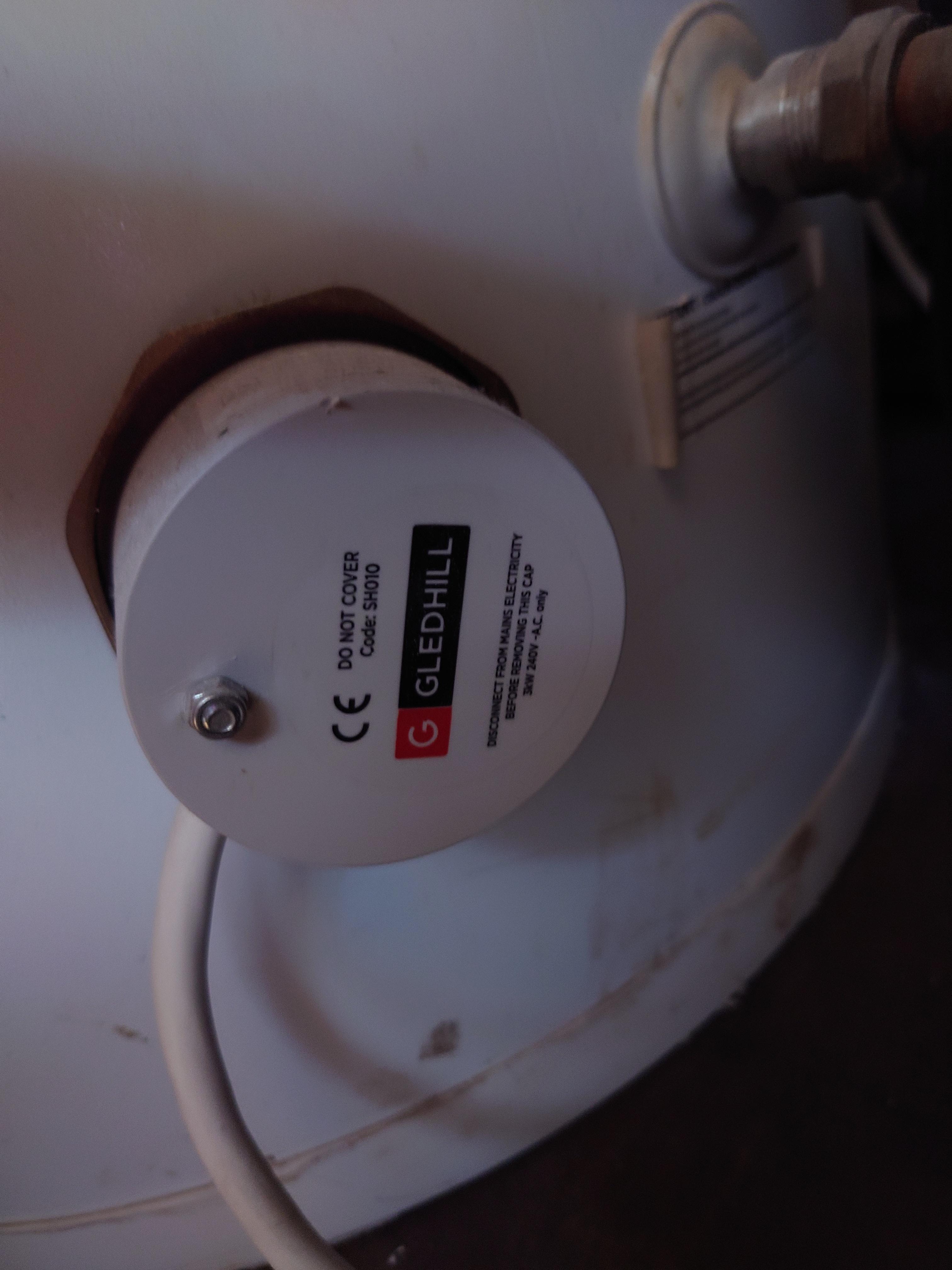

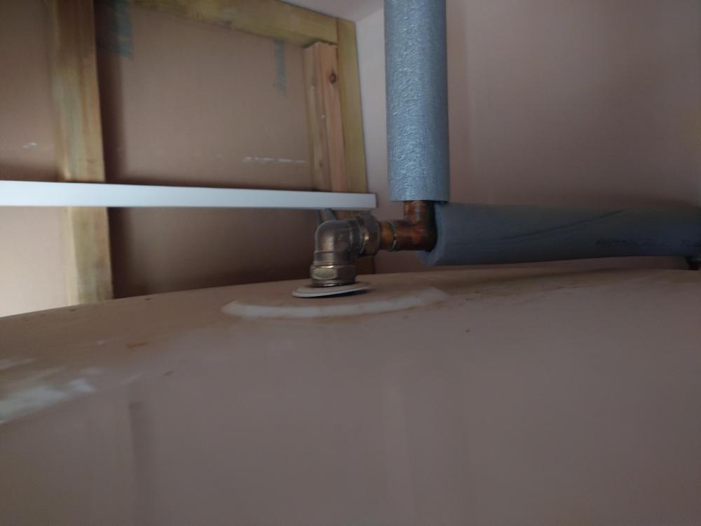

canalsiderenovation Posted May 6, 2023 Author Posted May 6, 2023 On 22/02/2023 at 11:55, Nickfromwales said: Simple. The stat in the immersion reaches the set point, and bingo, no more input goes to the immersion and export kicks back in at full wallop. Shut off the power to the immersion, whip the lid off, and post a pic of the settings on the stat head please. Ok so our export with Octopus goes live on 11th May so I need to turn down the stat in the immersion so we export as soon as the water is at 55 degrees (or maybe lower as that is plenty hot enough)! How do I stop the Solic from diverting when we have reached this temperature? Do you mean the lid of this big tank? How do I get in this? 20230506_141914.mp4

Nickfromwales Posted May 6, 2023 Posted May 6, 2023 7 minutes ago, TonyT said: The lid to the immersion heater The little heater at the bottom with the wire going into it. Isolate the supply at the CU, remove the nut and cover, post a pic of the guts.
canalsiderenovation Posted May 6, 2023 Author Posted May 6, 2023 4 hours ago, Nickfromwales said: The little heater at the bottom with the wire going into it. Isolate the supply at the CU, remove the nut and cover, post a pic of the guts. Please tell me you mean this? If so I'll look at it tomorrow.... If I unscrew it it's not gonna flood the house is it (I realise this is probably a stupid question)!
ProDave Posted May 6, 2023 Posted May 6, 2023 This is the immersion heater. Follow the white cable, it should go to a switch on the wall. Turn that switch off. Then remove the screw that is visible in the picture, that holds the plastic cover on. Post a close up picture of the inside and we will tell you what to adjust. No it won't leak water. Turn the switch back on when done or the immersion heater won't work.
canalsiderenovation Posted May 6, 2023 Author Posted May 6, 2023 56 minutes ago, canalsiderenovation said: Please tell me you mean this? If so I'll look at it tomorrow.... If I unscrew it it's not gonna flood the house is it (I realise this is probably a stupid question)! The pic didn't upload but I think it is this @Nickfromwales. @ProDave is this the same as your pic? Think you guys have solved it. I'll tackle it tomorrow.
ProDave Posted May 6, 2023 Posted May 6, 2023 Yes that's it, turn off the electric undo that nut and remove the plastic cover then post a picture of the inside and someone will tell you which is the thermostat. No water will escape doing that.
canalsiderenovation Posted May 6, 2023 Author Posted May 6, 2023 19 minutes ago, ProDave said: Yes that's it, turn off the electric undo that nut and remove the plastic cover then post a picture of the inside and someone will tell you which is the thermostat. No water will escape doing that. Thank you! Job for tomorrow.

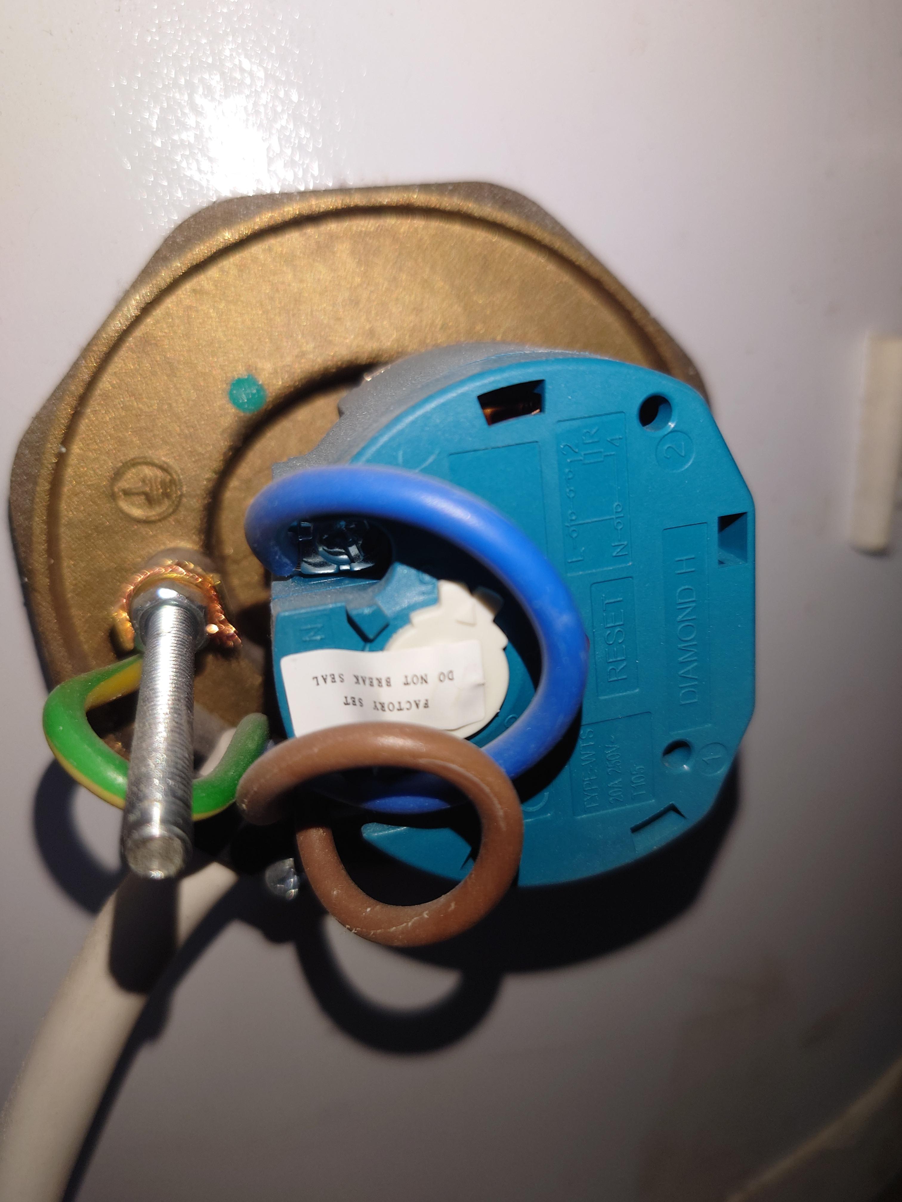

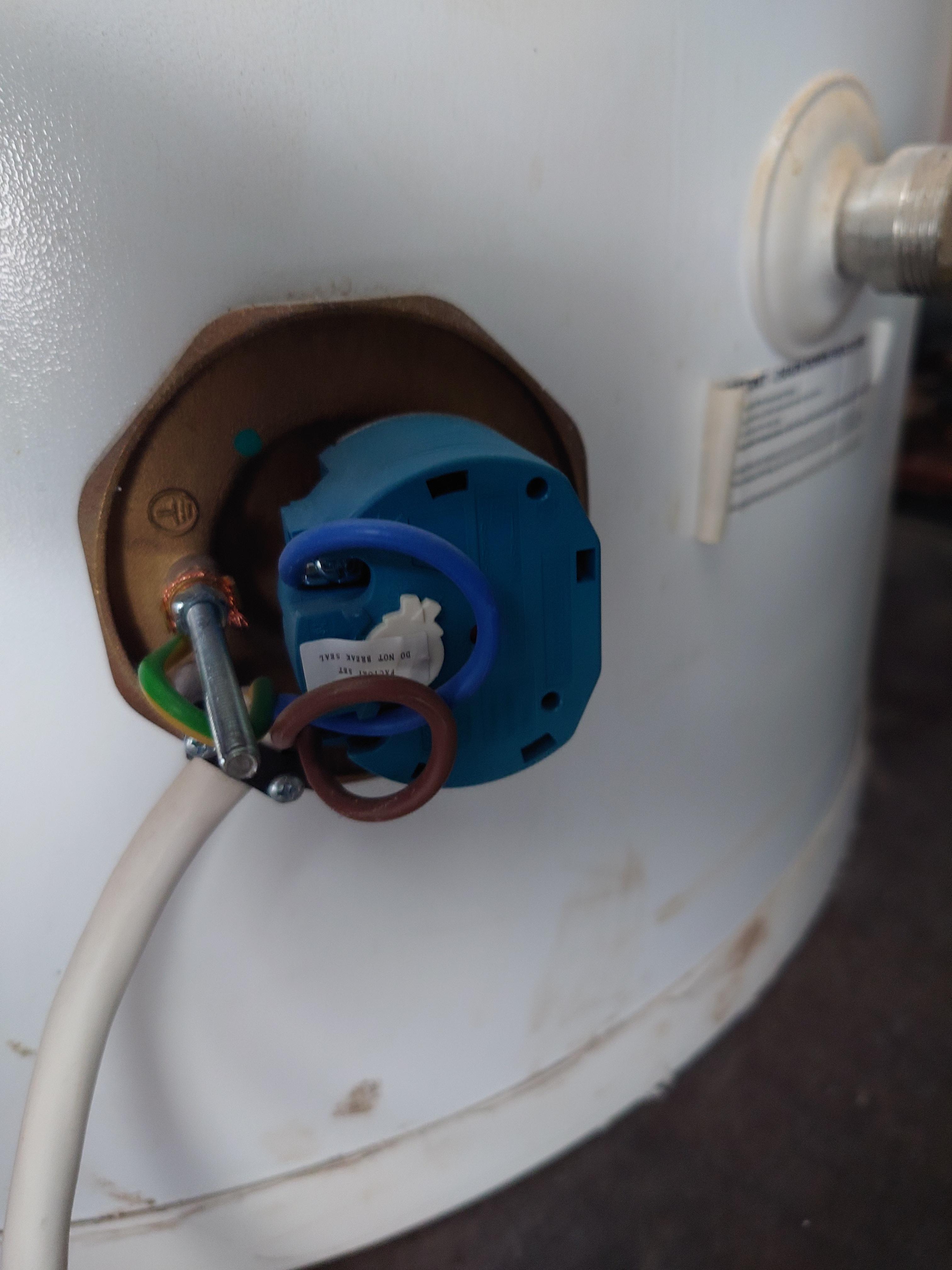

canalsiderenovation Posted May 8, 2023 Author Posted May 8, 2023 Ok here are the pics... @ProDave @Nickfromwales
canalsiderenovation Posted May 8, 2023 Author Posted May 8, 2023 Ah ha, I can see numbers 1-5 under the label which says factory set do not break seal. Question is how do the numbers correspond to temperature of the water. Ideally we don't want the Solic to heat the water beyond 50 degrees (anything that would heat the water beyond this we want to export). And do you have to pic a definite number - can't you have between 3-4 for example. It's between 4 and 5 now which heats to up to 56 degrees.
