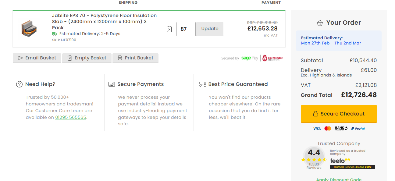

Dave Jones Posted February 22, 2023 Share Posted February 22, 2023 12 hours ago, Chanmenie said: So 2 layers to give 300mm at £30 a sheet is £60 plus the extra muck away won’t be much if any cheaper than 200mm PIR. I used 2 layers of 100mm Celotex so 88 sheets £4500 remember 100/200 mm of celtoex doesn't work brick so you will paying the brick layer for more of his time. 150/300 does. Link to comment Share on other sites More sharing options...

Chanmenie Posted February 22, 2023 Share Posted February 22, 2023 10 hours ago, Nickfromwales said: Can you share where you purchased for the OP, please? And how long ago, of course, as the world's gone entirely tits-up over the last few years. Just checked my invoice 24/06/2022 88 sheets 100mm Celotex £3366 + VAT £573. so total £3939 1 Link to comment Share on other sites More sharing options...
Dave Jones Posted February 22, 2023 Share Posted February 22, 2023 1 minute ago, Chanmenie said: Just checked my invoice 24/06/2022 88 sheets 100mm Celotex £3366 + VAT £573. so total £3939 well over £50 a sheet now. Inflation! Link to comment Share on other sites More sharing options...

crispy_wafer Posted February 22, 2023 Share Posted February 22, 2023 10 minutes ago, Chanmenie said: Just checked my invoice 24/06/2022 88 sheets 100mm Celotex £3366 + VAT £573. so total £3939 Quick check @ Insulationhub.co.uk would be about the same Link to comment Share on other sites More sharing options...

Chanmenie Posted February 22, 2023 Share Posted February 22, 2023 2 hours ago, Dave Jones said: well over £50 a sheet now. Inflation! EIS have 100m sheets at £37 + VAT so not far off what i paid in June, So you don't want to be paying anything over £50 a sheet 1 1 Link to comment Share on other sites More sharing options...

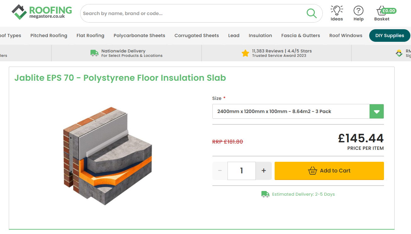

Iceverge Posted February 23, 2023 Share Posted February 23, 2023 @seano That is 2 layers of OSB3 floating 1 layer of this for the UFH (its about £30/m2) 110mm of the K103 Phenolic insualtion @ about £55/m2. 157mm. Total £85/m2 not cheap. You could bin the UFH and use rads and save 25mm and just meet the 0.18W/m2/K limit with just 110mm K103 @ 132mm. 1 Link to comment Share on other sites More sharing options...
Iceverge Posted February 23, 2023 Share Posted February 23, 2023 For what its worth 225mm of EPS 70 would give you the same U value as above but would only cost £12.60/m2. Over 250m2 UFH and phenolic speciality boards would be £21,250. EPS would be £9500. Bump it to 300mm for a U value of 0.12 and put some of the left over change towards digging out the old floor you'll still come out ahead. 2 Link to comment Share on other sites More sharing options...
