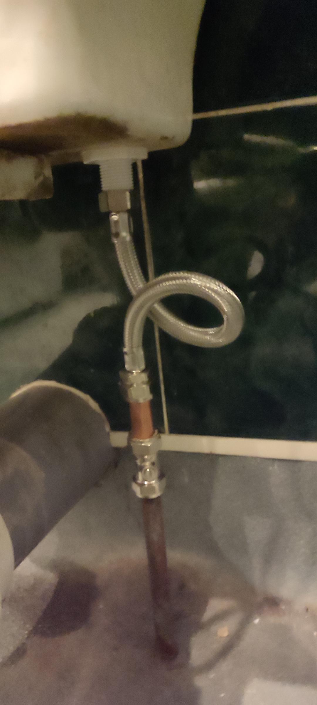

Question Posted February 18, 2023 Posted February 18, 2023 (edited) I have a British Gas service contract (work is contracted out to Dyno Rod), and an engineer came to our house to fix a leaking cistern. He put a flexible tap connector to the cistern. It was too long, so he put a loop in it. I have read that one shouldn't bend them too much. Should I get British Gas back to change it ? Edited February 18, 2023 by Question
ProDave Posted February 18, 2023 Posted February 18, 2023 Was there a flexi before? Personally in a situation like that, a flexi is the very last way I would connect that cistern. Just a straight bit of copper to a tap connector from the isolator.
Question Posted February 18, 2023 Author Posted February 18, 2023 I can't remember whether there was a flexi before. There certainly wasn't a loop. Why do you say that a flexi is the very last way you would connect to a cistern?
Mike Posted February 18, 2023 Posted February 18, 2023 55 minutes ago, ProDave said: Personally in a situation like that, a flexi is the very last way I would connect that cistern. Just a straight bit of copper to a tap connector from the isolator. +1 A flexi is that last thing I'd use anywhere. I've changed too many burst ones in the past.

Nickfromwales Posted February 18, 2023 Posted February 18, 2023 1 hour ago, Question said: a British Gas service contract Cancel it. Put the money into a glass jar each month. IF or WHEN you NEED something doing you'll have plenty of money ( of your own ) to appoint a company which isn't a sharky shit-show such as these legalised thieves. British Ass more like. Dyno Rod are drain un-blockers, not plumbers. Why the feck would they not have cut the pipe lower down and used that to absorb the length of the flexi. OR ( drumroll please ) just have used the exiting tap connector which would have been a like-for like swap?!? Cancel your contract, and save a boat-load of money over the next x number of years where nothing breaks. Biggest scam ever, and if your boiler fails they'll just cancel your contract for you, stating that the boiler is obsolete, and give you a massively inflated price to replace it.
Nickfromwales Posted February 18, 2023 Posted February 18, 2023 1 hour ago, Question said: I can't remember whether there was a flexi before. There certainly wasn't a loop. Why do you say that a flexi is the very last way you would connect to a cistern? You would have had a proper tap connector. These clowns took the lazy route, and just started cutting pipework for no good reason. Fill valves in the cistern have an industry standard connector, and replacements are manufactured to allow an 'alteration-free' replacement. Tossers. Get this changed for free, then cancel.
Question Posted February 19, 2023 Author Posted February 19, 2023 I had a look on line at a manufacturers blurb and they have done it wrong!!!!! British Gas are such time wasters. Here is the link: manual-hydraquip-installation-guide.pdf (toolstation.com)

Nickfromwales Posted February 19, 2023 Posted February 19, 2023 2 hours ago, Question said: I had a look on line at a manufacturers blurb and they have done it wrong!!!!! British Gas are such time wasters. Here is the link: manual-hydraquip-installation-guide.pdf (toolstation.com) 13 hours ago, Nickfromwales said: Get this changed for free, then cancel. "The power is in your hands". Go kick their arses, and then cancel your worthless cover plan.
