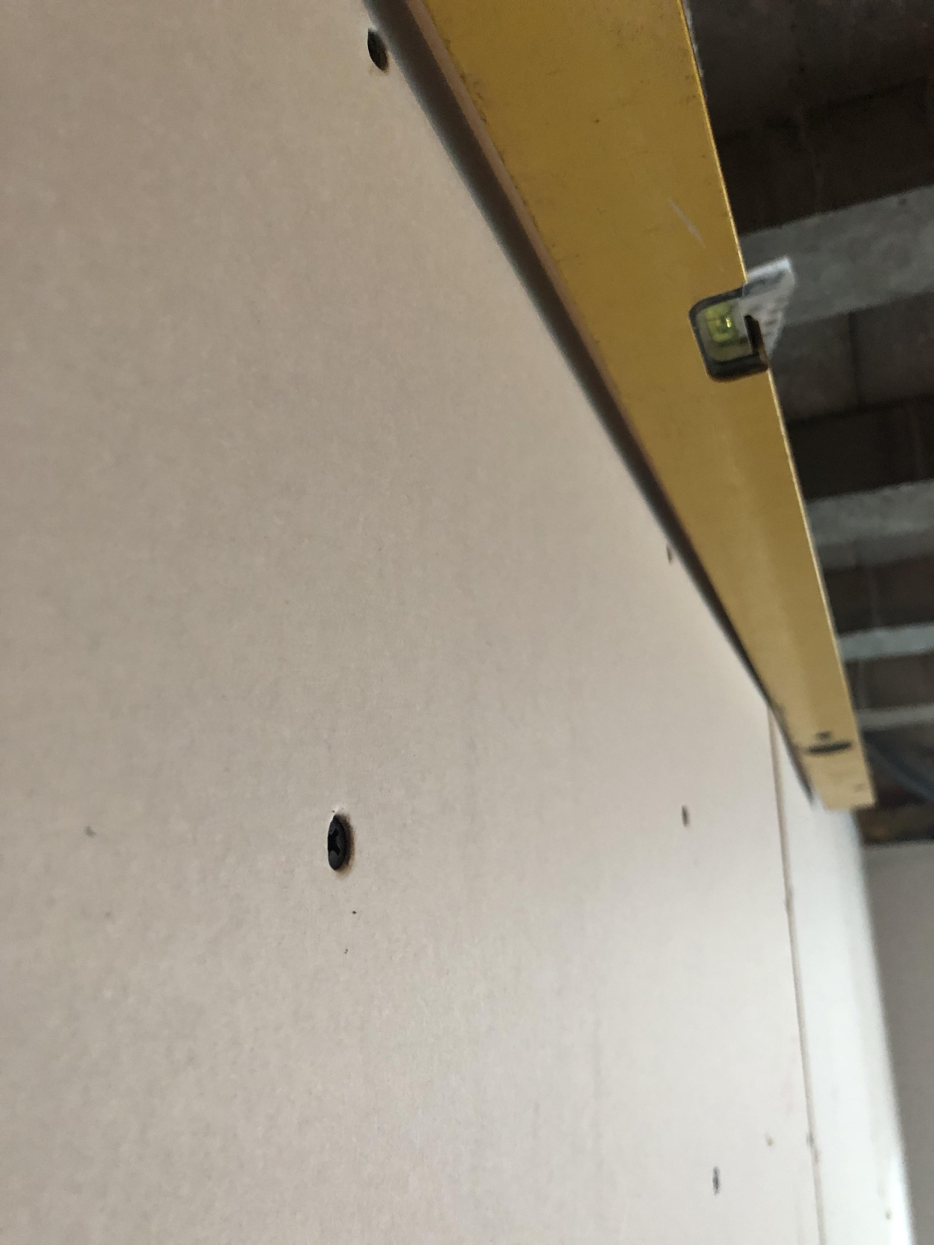

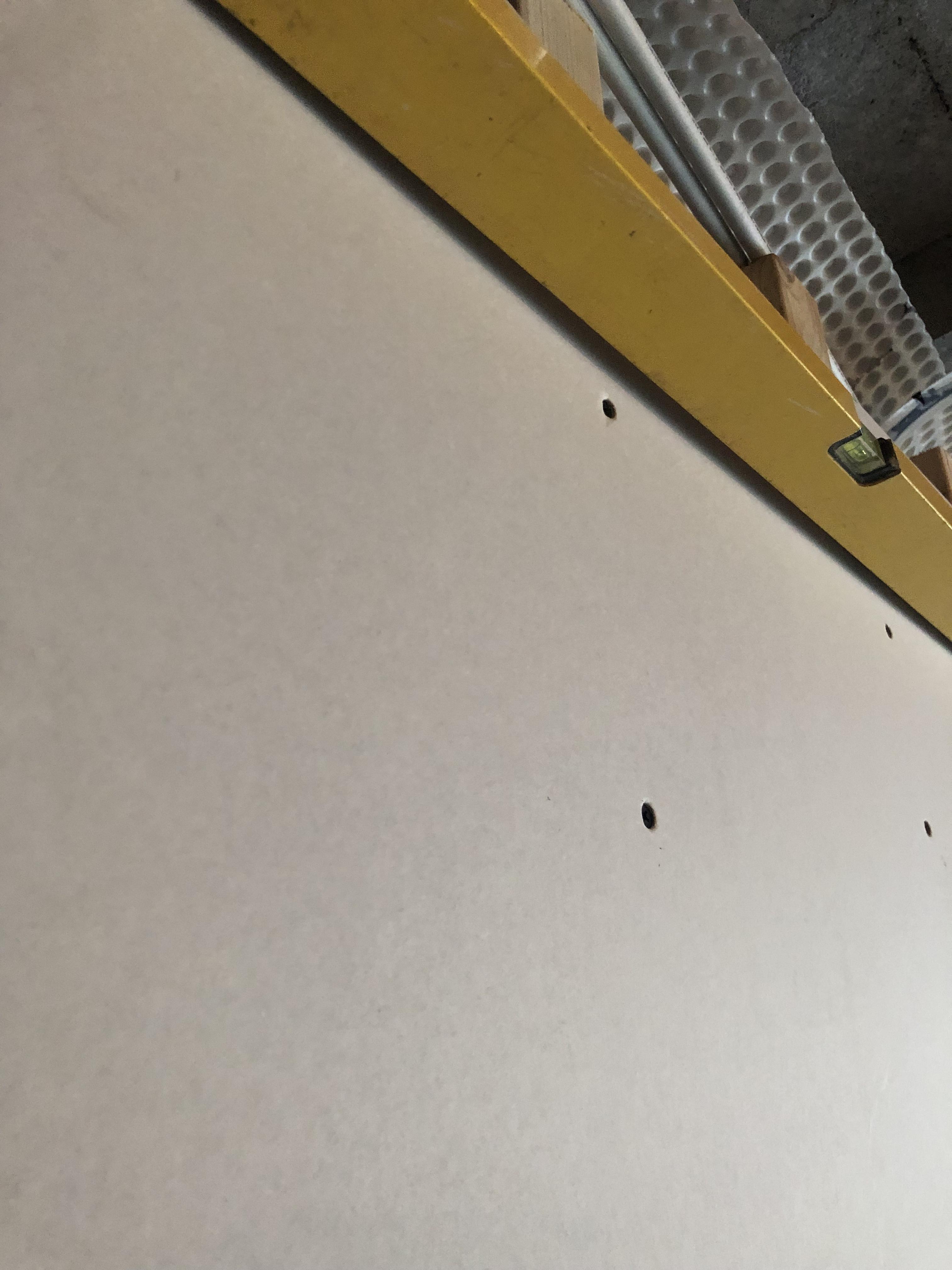

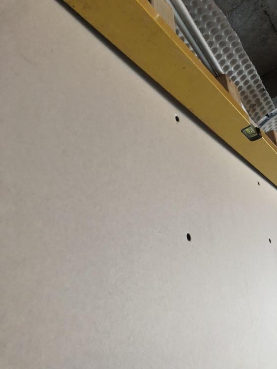

Pocster Posted February 17, 2023 Share Posted February 17, 2023 Done plenty of studwork and never worried about a bit of drift . I’m now doing a long wall ( 14m ) I notice once I’ve boarded typically a bow on some boards . Studs must be out or warped I assume . Worst case is around 10mm in the centre . Is this acceptable drift ? . Once skimmed and painted will it be even noticeable?? Link to comment Share on other sites More sharing options...

Pocster Posted February 17, 2023 Author Share Posted February 17, 2023 (edited) 8 minutes ago, crispy_wafer said: Sorry I don't know, but I would be interested to find out what is acceptable for a spread to take out, because I'll be bloomin surprised if I manage to get all my boards up without a deviation, even though I've been running string lines and straight edges. Yeah . As “ worry “ takes over that particular board I took down and managed to get the stud in an additional 5mm or so . It still ‘ bends ‘ but less noticeable. It’s when you stick a straight edge across the face - like a long spirit level you see the wobbles across multiple boards ! . From my experience of plasters . I did a bathroom ceiling and it was super (expletive deleted) level ; laser proved it . Got it skimmed ; looked great . Put up some straight beading - at either end touching the ceiling - in the middle maybe 10mm out . Plasters are indeed only human and judge by eye . Edited February 17, 2023 by pocster Link to comment Share on other sites More sharing options...
Russell griffiths Posted February 17, 2023 Share Posted February 17, 2023 You should have put the level across the studs before you put the board up. Good god man, I thought you were improving 🤦🏻♂️ Take the board down and pack the dodgy studs, or plane face of proud one. You probably won’t see it much if you squint a bit, but think of when you put skirting on. 1 Link to comment Share on other sites More sharing options...

Pocster Posted February 17, 2023 Author Share Posted February 17, 2023 (edited) 39 minutes ago, Russell griffiths said: You should have put the level across the studs before you put the board up. Good god man, I thought you were improving 🤦🏻♂️ Take the board down and pack the dodgy studs, or plane face of proud one. You probably won’t see it much if you squint a bit, but think of when you put skirting on. Redone now . It was level at the bottom I.e skirting . This one drifted out only at the top - so probably put a level across the middle where it’s ok .m; didn’t notice until board up Edited February 17, 2023 by pocster Link to comment Share on other sites More sharing options...

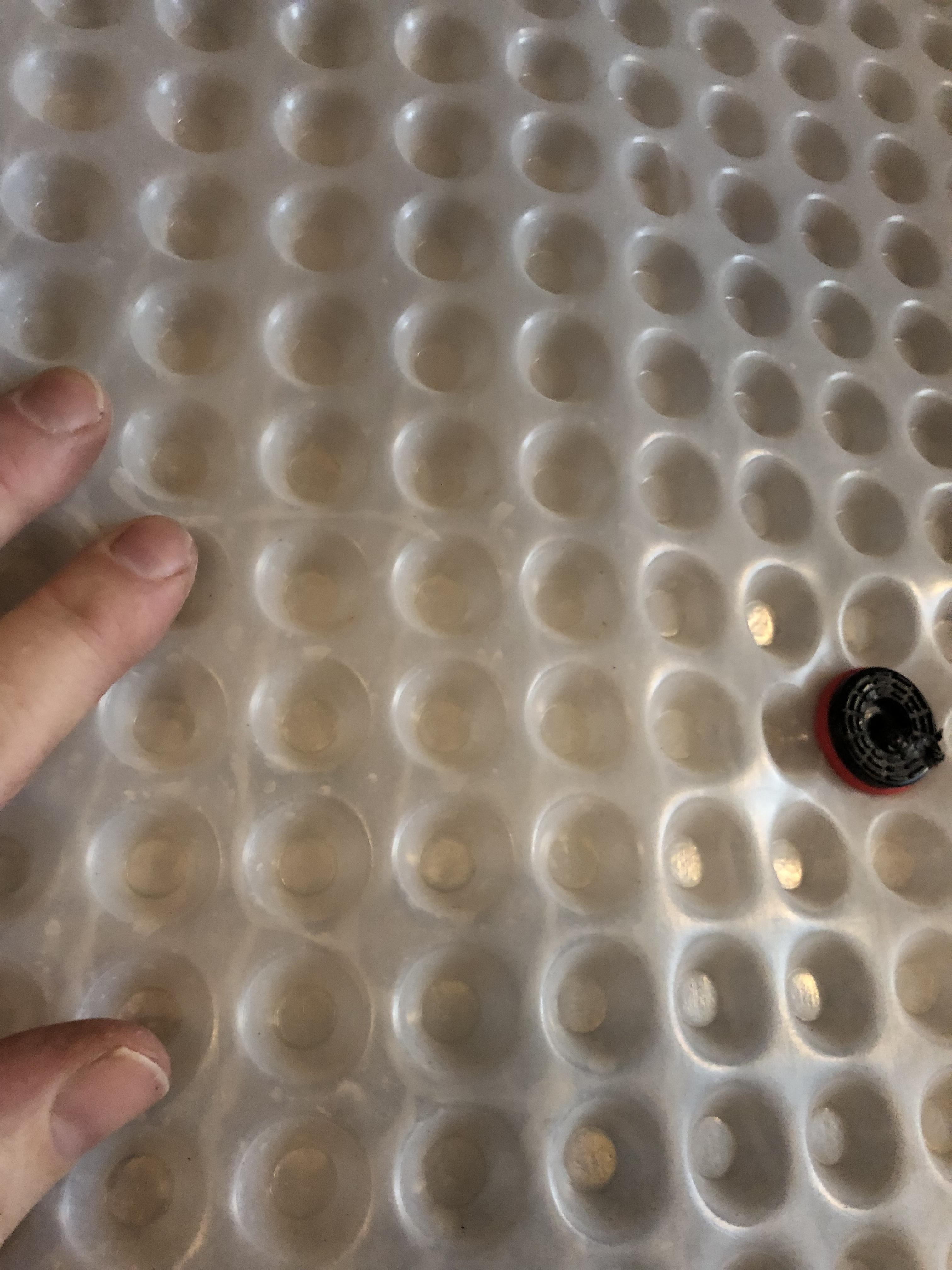

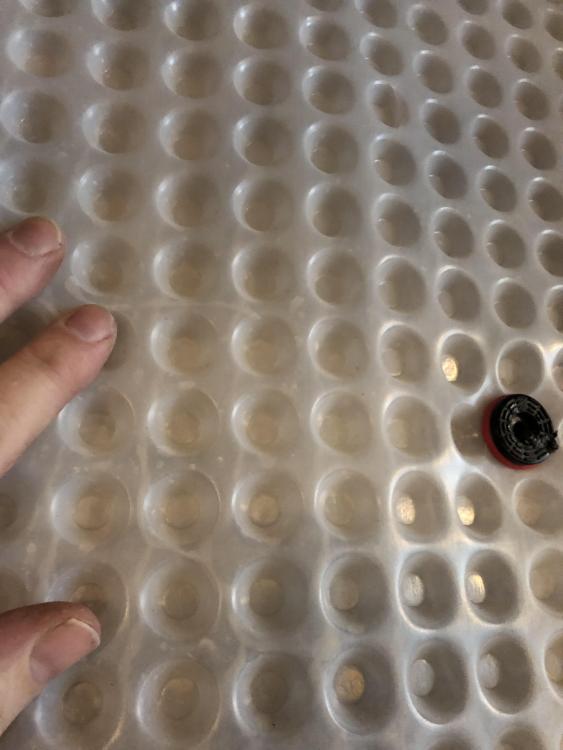

Pocster Posted February 17, 2023 Author Share Posted February 17, 2023 (edited) Took off the last stud I did yesterday as correcting the other one seemed to suggest an issue with this one . Cant tell in the photo but a bit of crap has fallen down behind the membrane right at the top . Hit the membrane ; shatters crap - stud now tight to the wall ( not rude ) . Must remember to check membrane by feel for lumps Edited February 17, 2023 by pocster Link to comment Share on other sites More sharing options...

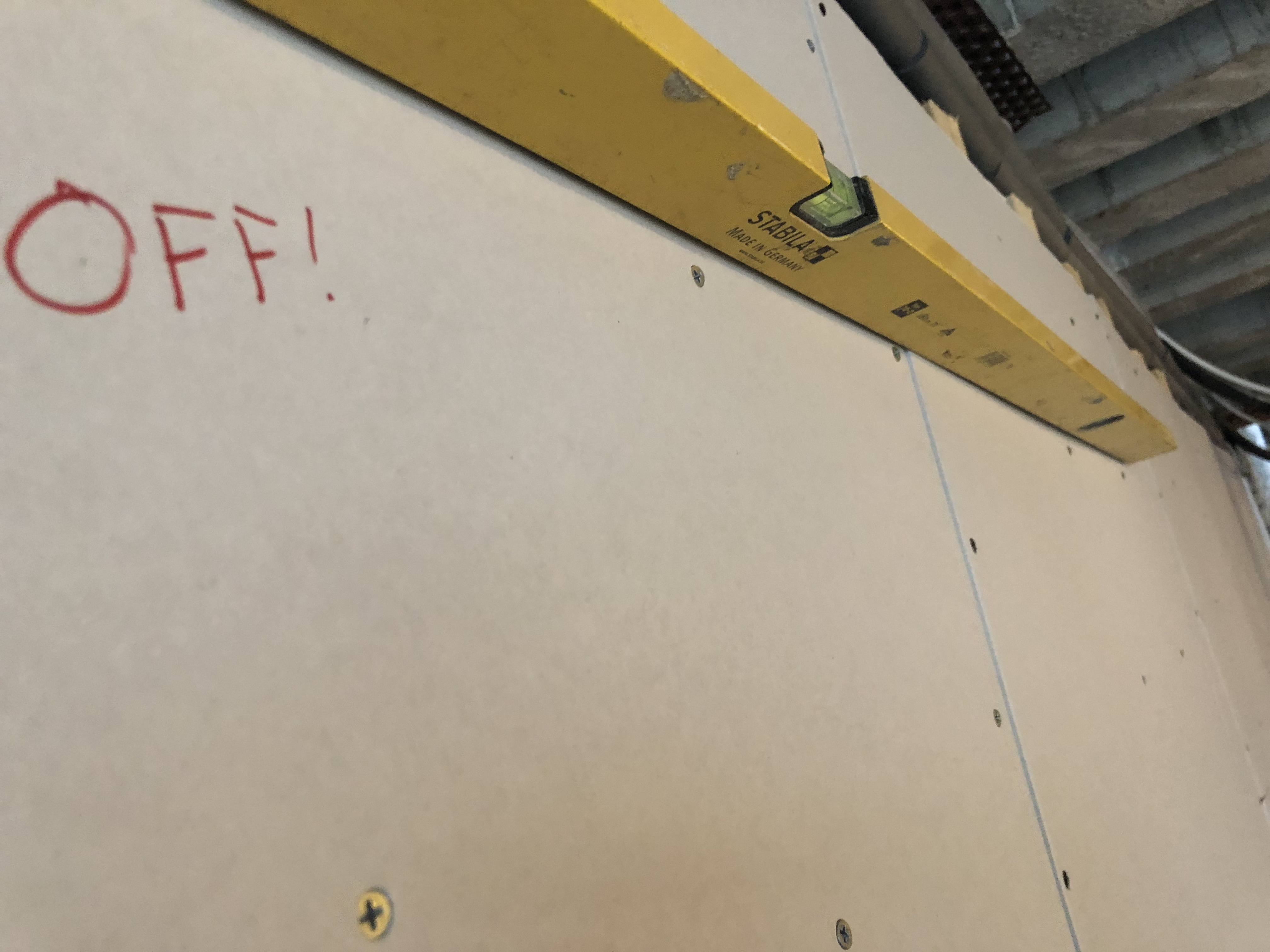

Pocster Posted February 17, 2023 Author Share Posted February 17, 2023 @Russell griffiths as you showed faith in my skills improvement here’s a photo of the other wall done last week . ‘Drift ‘ across board faces around 2mm or so …. Link to comment Share on other sites More sharing options...
Russell griffiths Posted February 17, 2023 Share Posted February 17, 2023 Absolute bloody legend. Always put a straight edge at floor level for skirting, and ceiling level, these are the two areas it will show. 1 Link to comment Share on other sites More sharing options...
