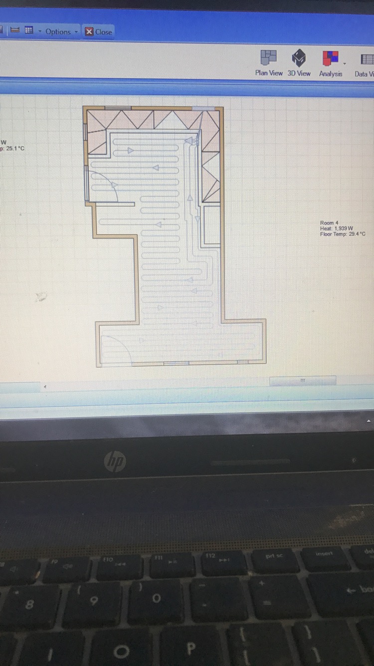

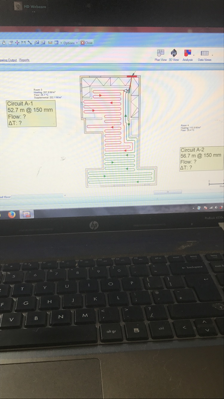

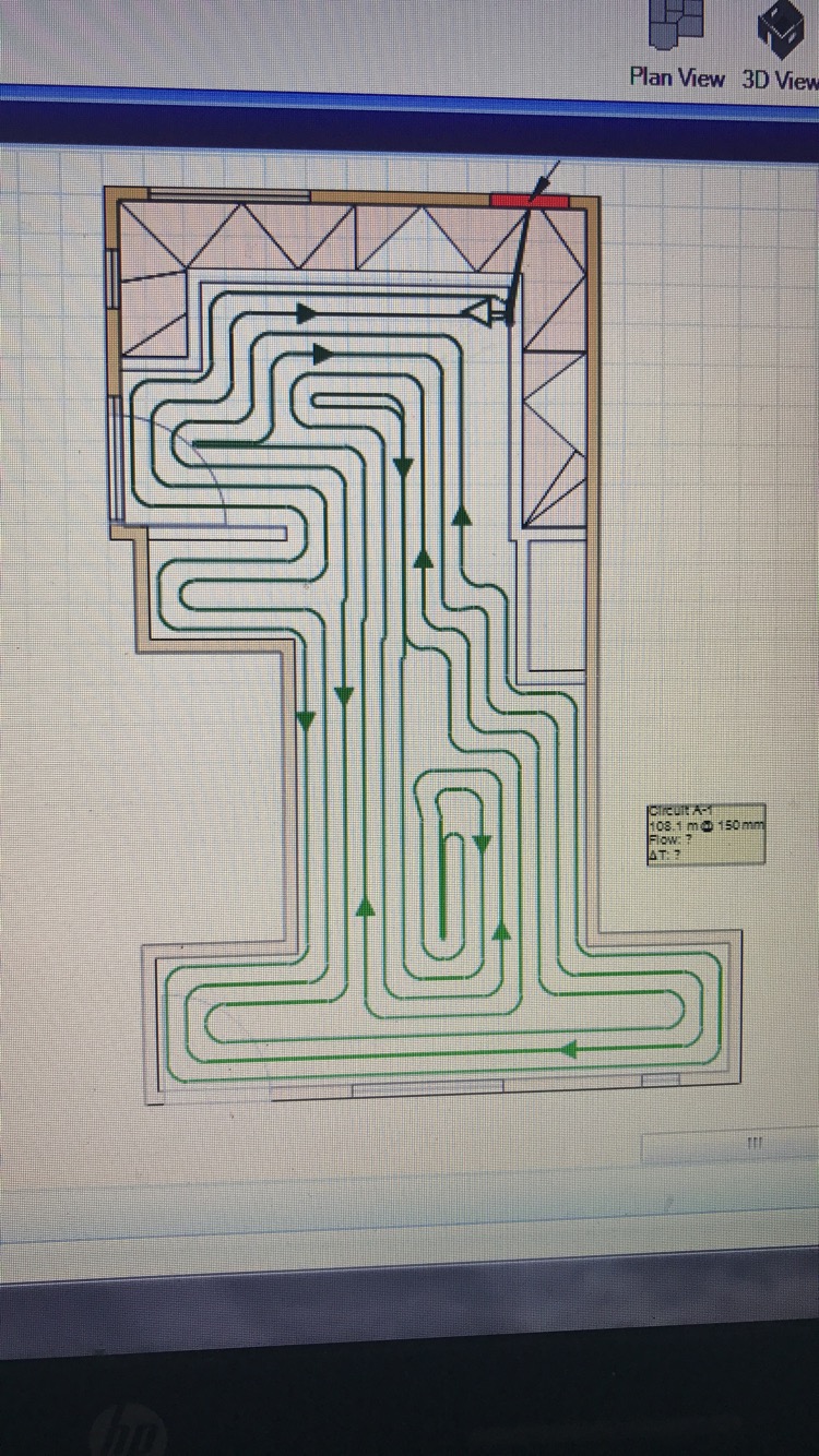

Russ P Posted July 30, 2017 Author Share Posted July 30, 2017 So today I have downloaded LoopCad and had a play. Best lay out is 2 circuits and it says that between the 2 I need 109.4metres of pipe at 150mm spacing. I have 200m of pipe so am wondering whether to cut the spacing to 100mm instead! See the plans for reference but please excuse the lame attempt at units with all the diagonal lines Link to comment Share on other sites More sharing options...
Nickfromwales Posted July 30, 2017 Share Posted July 30, 2017 I don't ever lay 'serpentine' as it's a pita and doesn't heat evenly. I much prefer reverse / inverted TBH. That way you only have one or two tight 180o bends in the middle of the loop rather than the 36 or more you have in your first revision . Link to comment Share on other sites More sharing options...
Russ P Posted July 30, 2017 Author Share Posted July 30, 2017 This is the layout plan for that one then. Looks a little tight in 2places Link to comment Share on other sites More sharing options...
Nickfromwales Posted July 30, 2017 Share Posted July 30, 2017 That's just computer generated free waffle. Get a piece of graph paper and you'll draw out a much better layout in minutes. Scrap copies first so you can just bin them until its looking good. . Link to comment Share on other sites More sharing options...
