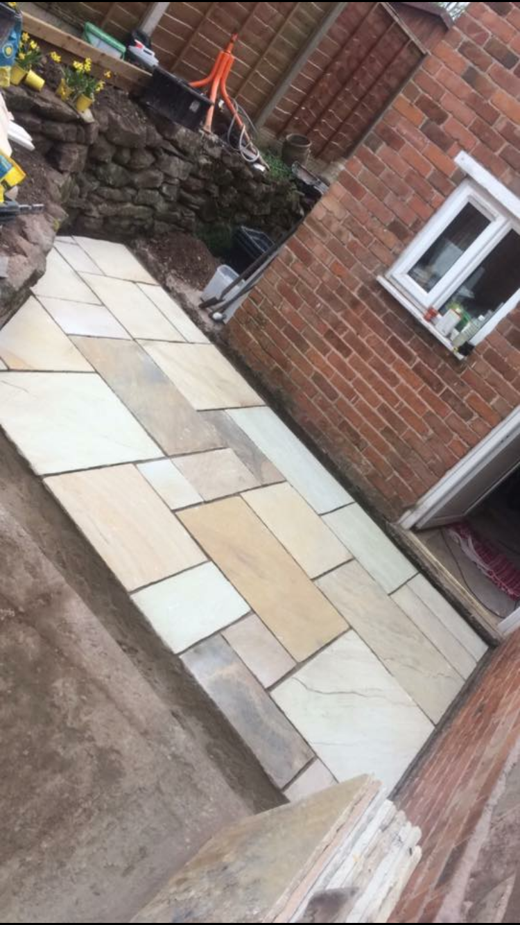

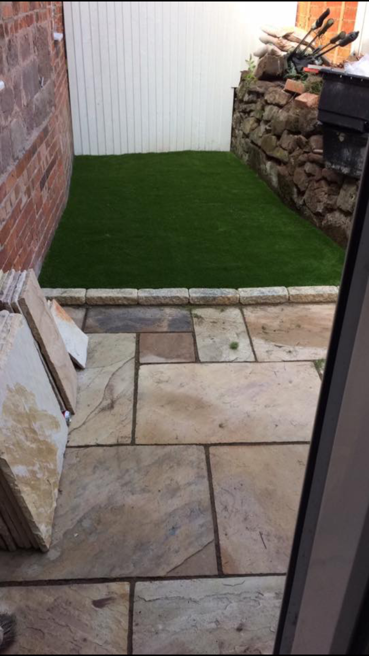

So The final thing I never mentioned has my final finish isn't the normal finish like most people have tiles or wood!! It's going to be a golden fossil paving slab

Go on, what's a golden fossil?
They are the paving slabs that I have used on my patio but the boss (wife) thinks they will keep a nice cottage feel if we continue them through the Kitchen. Which I strangely agree with her on
Posted
You need to seal that sandstone very well if you use it indoors as it stains very easily. It may even be worth sealing it with one coat before laying and then add another over the grout and slabs when it's done.
You will  have to watch carefully if you are linking direct to a boiler with the UFH as the time for it to warm through will be quite a lag from when you put heat in - mixed UFH and trad rads can mean issues where the rads overheat as the floor hasn't reached temperature.
Plan carefully ..!
Was planning on putting a few coats of sealant over it!
