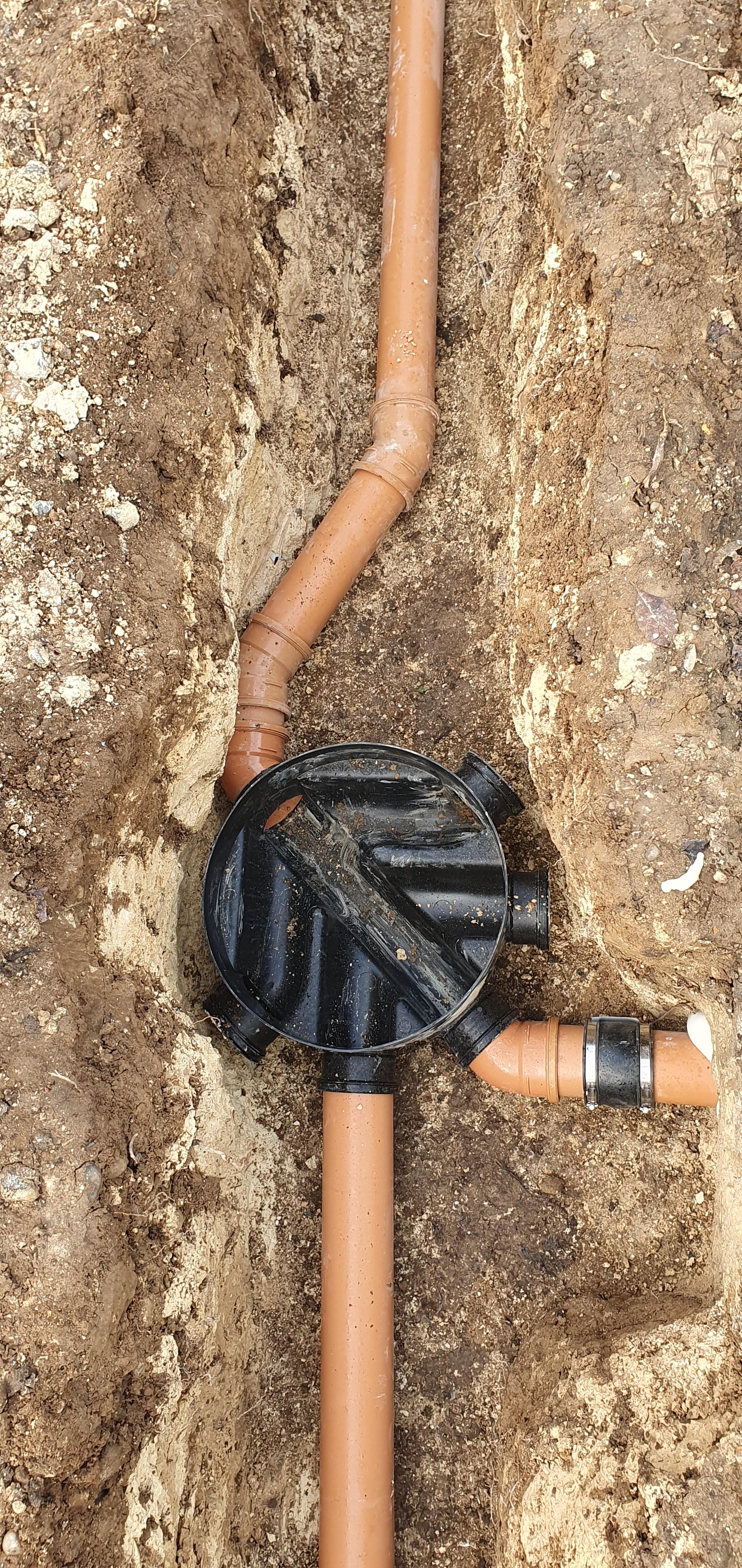

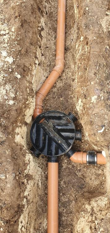

I've got two of these, similar but slightly different. The one in the photo, luckily, is immediately adjacent to a rest bend and a vertical stack, taking flow from 2 upstairs bathrooms. The 'matter' will be passing through with some velocity.
The other one is slightly less so.
It feels like a flaw in the system from the outset.
The notion of differential movement in this case baffles me, the drainage is all in the chalk layer. In fact if you lifted the house and foundations away, the drainage would all remain. I don't really see how there will be differential movement in the same way there would possibly have been had I passed through the foundations or wall structure.

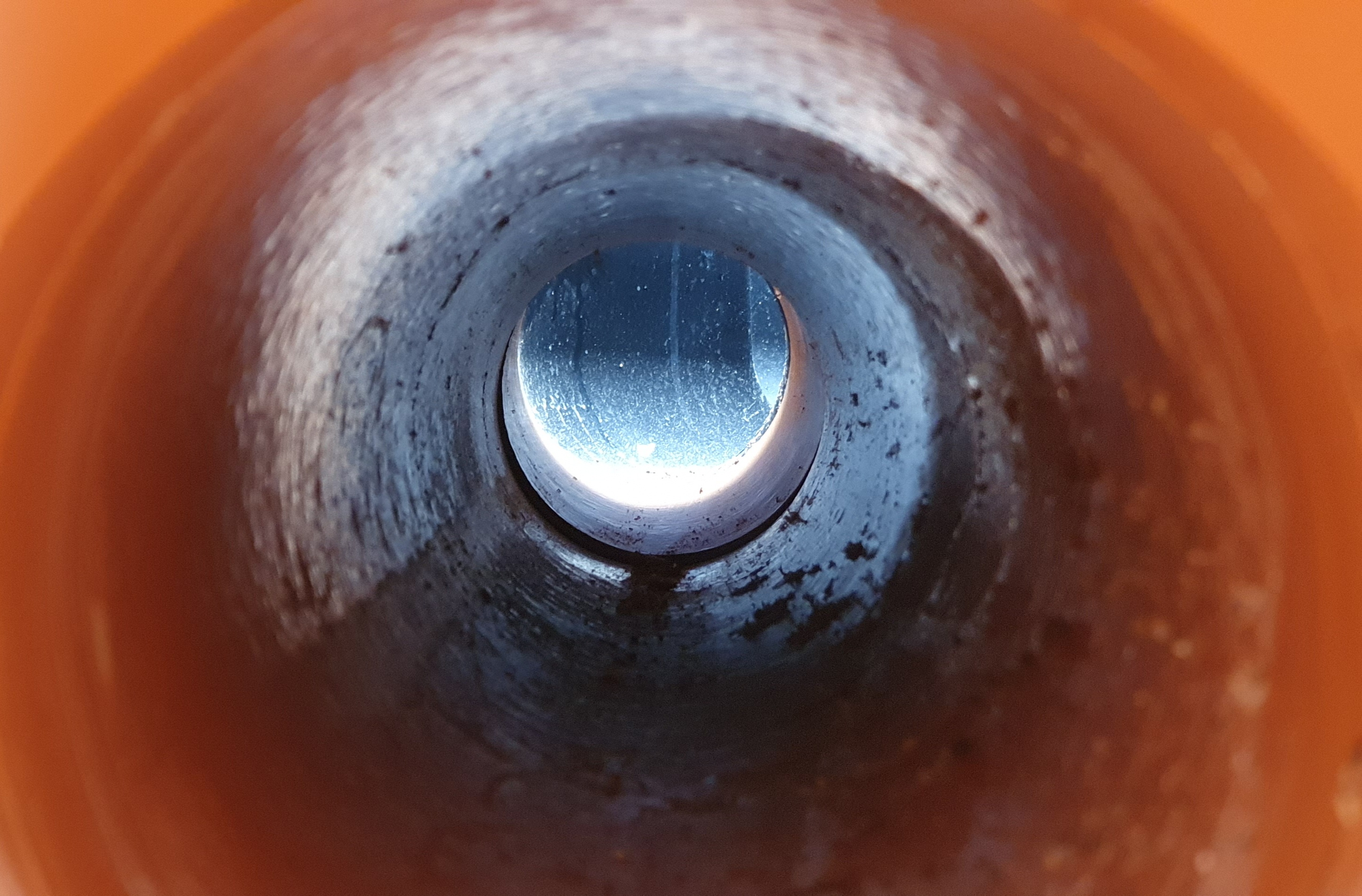

This is the view from upstream to downstream, so this is the lip that 'stuff' will have to pass over as it currently stands...
I say again, this run is contained within the solid chalk bed, beneath the foundation and does not pass through the concrete foundation in any way, so the idea of needing to make it flexible just isn't logical to me, well, here any more any than anywhere else. Why should there be any differential movement here that there wouldn't be under the drive for example? I understand it if the pipe is passing through a wall, but not in isolation completely underneath the foundation.

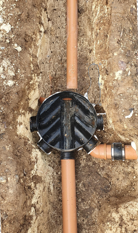

20 minutes ago, Temp said:
Why not rotate it like this or am I missing something..
I deliberately orientated the chamber like that, despite it not being my first thought because it it is more logical that way. The flexible connector branch comes in from the 2 upstairs bathrooms, hence it'll see flow from 2 toilets and a large bath/shower. I gave that the priority of the main gulley. The one that comes in from the bottom of the photo is a grey run from the Kitchen, so made sense to me for that to drop in from one of the side ports.
Does my logic stack up?!
In my dealings with BC they like the main flow to be on the bottom so that it cleans any incoming from the branches. I don't see any issues with your suggestion, if anything it's removed some 45's so a good thing. It doesn't stop the s**t getting clogged in the joint though.
I tend to think when using the rubber couplers it's better to have a bigger gap between the two pipes i.e. don't try to butt them up. The space will afford some self cleaning.

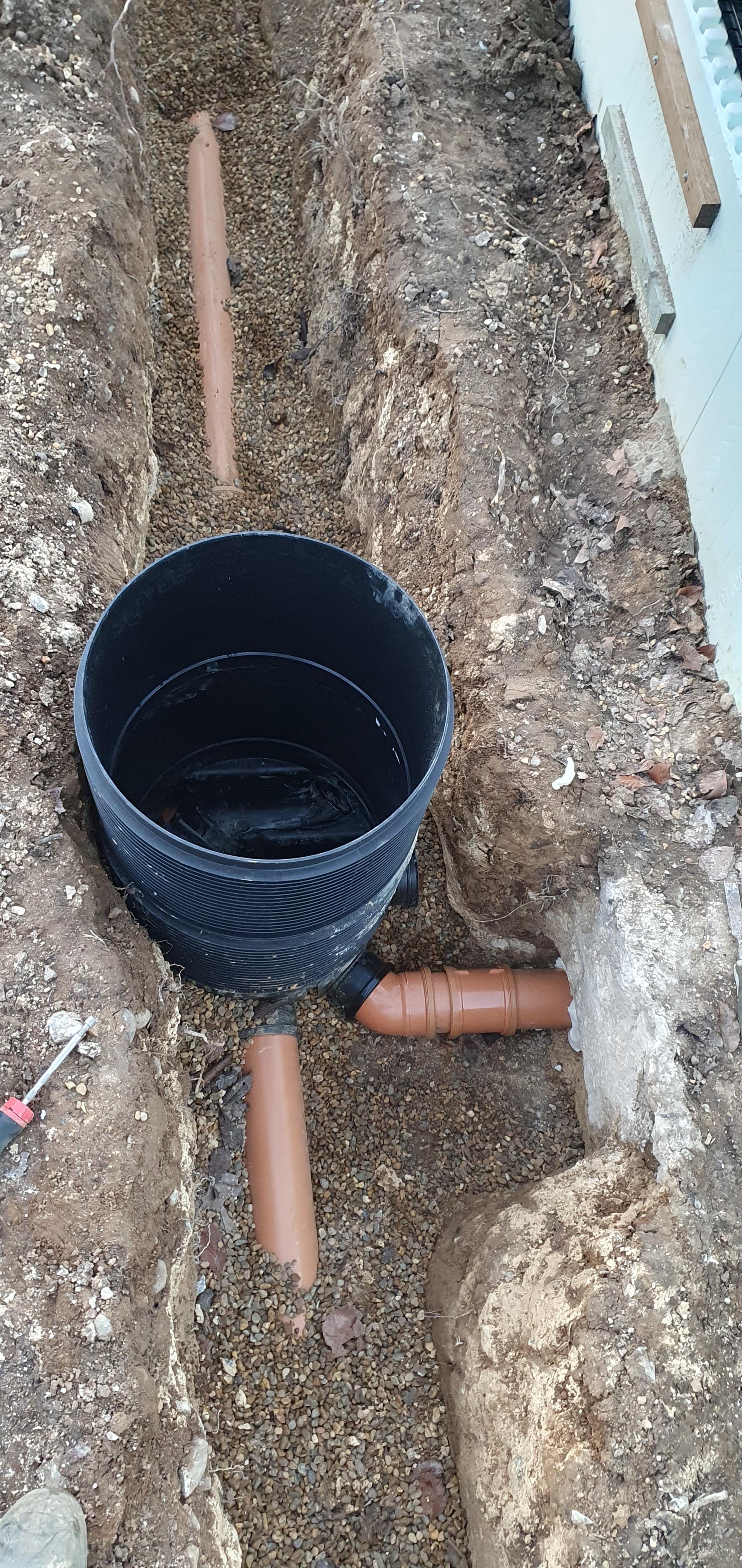

On 30/01/2023 at 11:28, Mr Punter said:
I only use the band seal couplings on different pipe type and sizes, so plastic to clay, MDPE etc.
Turns out this was the correct answer. My SE specifically suggested the Flexseal type of fitting, but turns out that a normal coupling was actually the right thing to use.
So, out came the pea shingle, expanding foam and after a few hours of struggling, I'm much happier.
BCO came and gave me the green light, so we're all good. Thanks for your input everyone.

use a smaller chamber it doesnt look that deep, remove the coupler attached to the pipe coming through the conc and you should have enough room to move/align the chamber and to lose all those bends.
If BC still want a rocker connection cut off some of the pipe and move the coupler closer to the conc.
you really dont want dogs leg immediately leaving the chamber, may as well do it properly.
