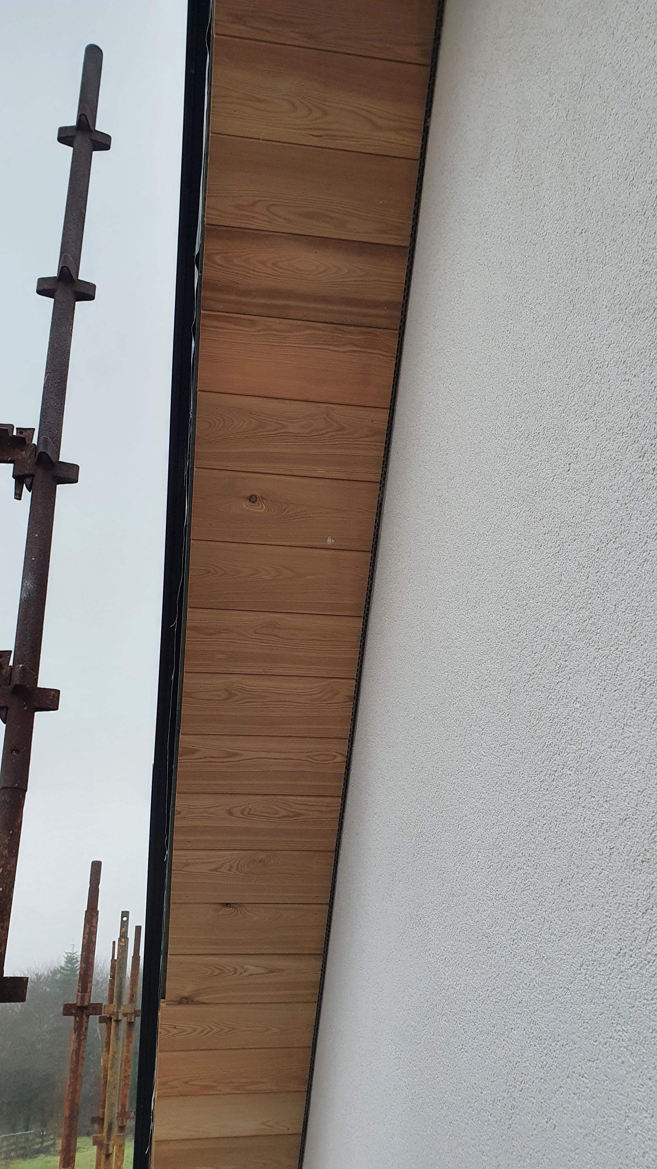

Russell griffiths Posted November 30, 2021 Posted November 30, 2021 (edited) If it’s a soffit then it’s not going to pick up much weather. I face fixed all my cedar with the second fix paslode, from the ground you cannot see any fixings. Remember to not butt them up tight to allow for a bit of expansion. Edited November 30, 2021 by Russell griffiths
SuperJohnG Posted November 30, 2021 Posted November 30, 2021 59 minutes ago, Russell griffiths said: If it’s a soffit then it’s not going to pick up much weather. I face fixed all my cedar with the second fix paslode, from the ground you cannot see any fixings. Remember to not butt them up tight to allow for a bit of expansion. Looks great @Russell griffiths. Wish I had the cedthebutnits was more than double the price. What fixings did you use? Normal d head or full size?
Russell griffiths Posted November 30, 2021 Posted November 30, 2021 @SuperJohnG no second fix gun, so 16 gauge stainless t head. You can probably use first fix gun with larch if your having the more rustic look.

SuperJohnG Posted December 1, 2021 Posted December 1, 2021 8 hours ago, Russell griffiths said: @SuperJohnG no second fix gun, so 16 gauge stainless t head. You can probably use first fix gun with larch if your having the more rustic look. I'm hoping to get a nice finish is siberian larch unsorted so is pretty neat. Do those t head ones go into the wood below surface then?
Russell griffiths Posted December 1, 2021 Posted December 1, 2021 8 hours ago, SuperJohnG said: I'm hoping to get a nice finish is siberian larch unsorted so is pretty neat. Do those t head ones go into the wood below surface then? Yes nearly invisible. But I don’t know if it’s what I would use for yours, my timber is super dry and knot free, I’m hoping for zero movement so happy with a second fix nail, your timber is also heavy compared with mine. I would probably use a bigger fixing on yours. That wasn’t much help was it ??

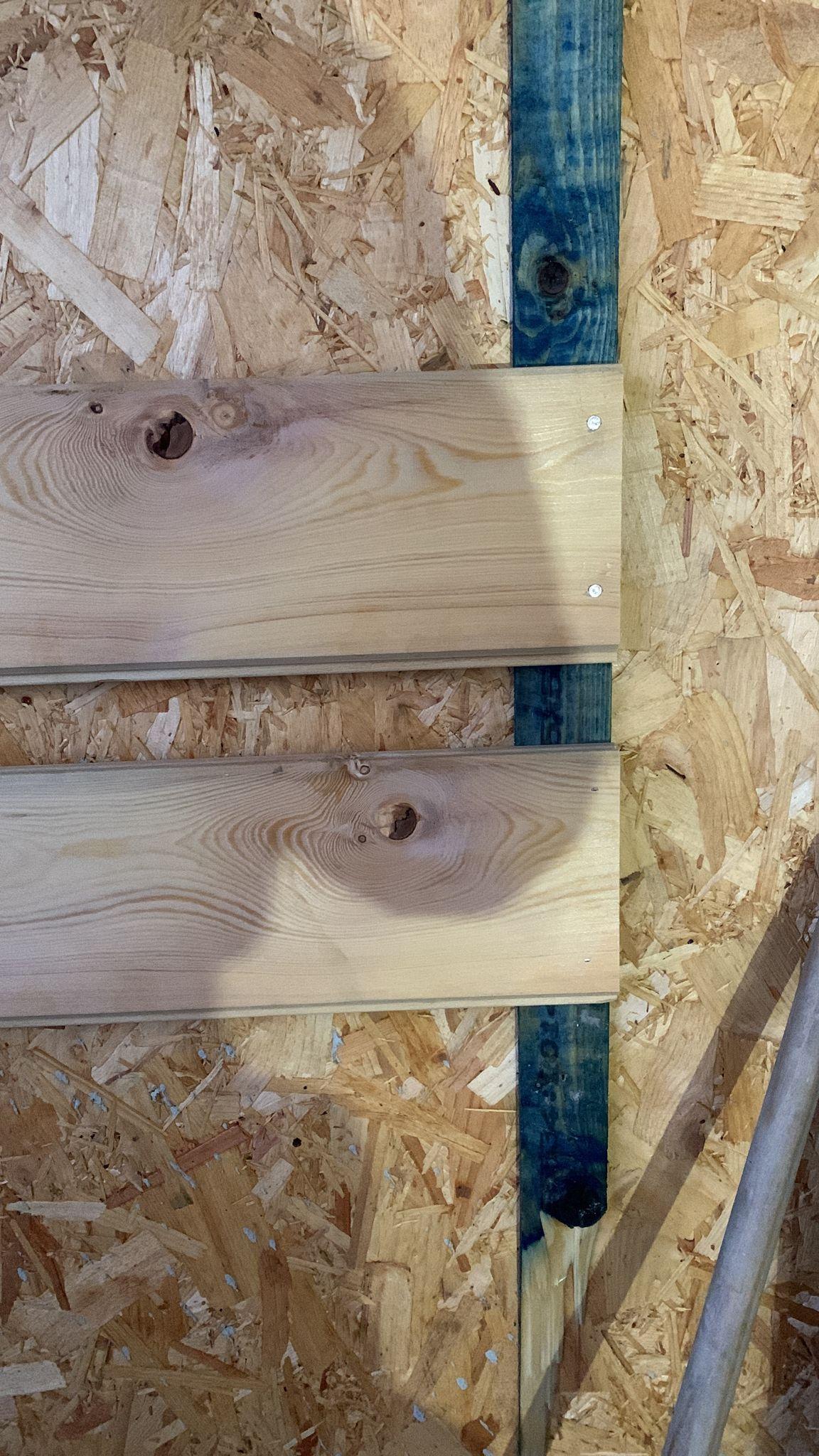

SuperJohnG Posted December 7, 2021 Posted December 7, 2021 On 01/12/2021 at 09:35, Russell griffiths said: Yes nearly invisible. But I don’t know if it’s what I would use for yours, my timber is super dry and knot free, I’m hoping for zero movement so happy with a second fix nail, your timber is also heavy compared with mine. I would probably use a bigger fixing on yours. That wasn’t much help was it ?? @Russell griffiths I'm back on this. Joiner reckons the second fix t head stainless works fine and done a wee test today. Do you get the second fix stainless in ring shank? That would make me happy I think. Image attached of normal type full head head finishing gun below for those who are looking in the future. Paslode say they do a specific 2.8 x 50mm Neil for cladding. But not sure if it is normal d head type which will look gash.
SuperJohnG Posted December 9, 2021 Posted December 9, 2021 I've ended up going for the Paslode st/stl Brads for the second fix gun - they seems absolutely solid on the test piece, hence going to give that a try. Will report back once the soffit cladding is up!

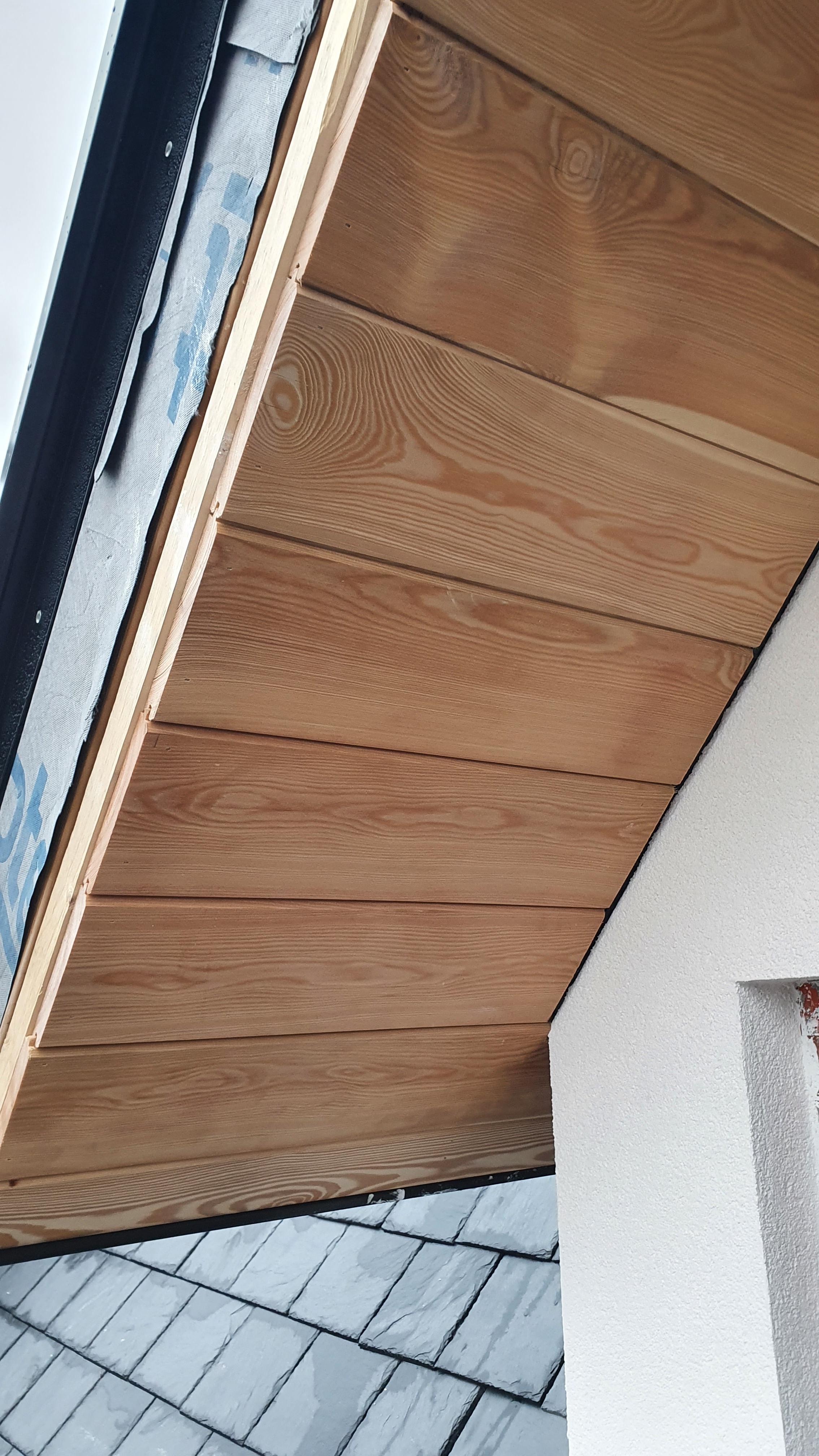

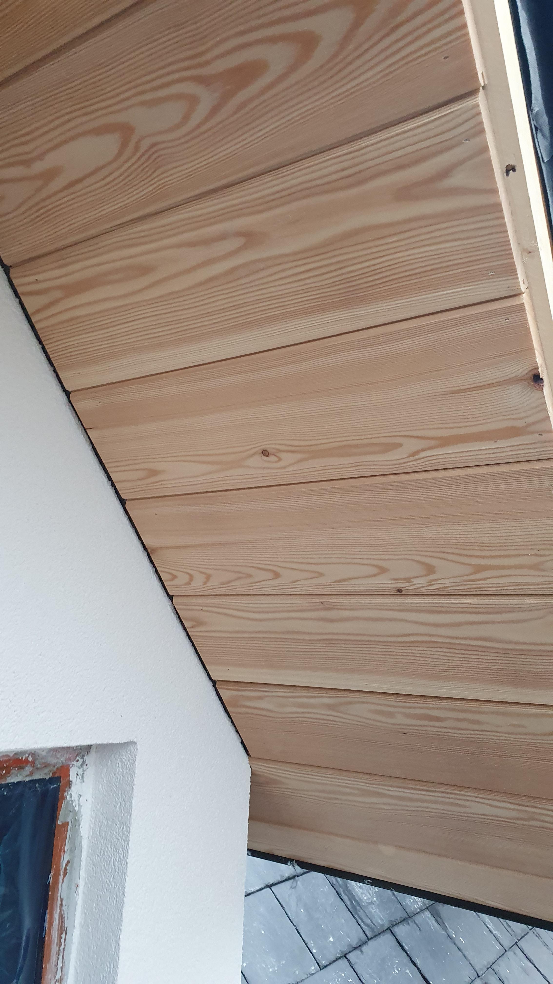

SuperJohnG Posted December 19, 2021 Posted December 19, 2021 On 09/12/2021 at 10:47, SuperJohnG said: I've ended up going for the Paslode st/stl Brads for the second fix gun - they seems absolutely solid on the test piece, hence going to give that a try. Will report back once the soffit cladding is up! Now started fitting at the weekend. The paslode brads work perfect, great hold and ant see a thing. So far no pre drilling required at the ends. Can't see the fixings from 2m away. 1
