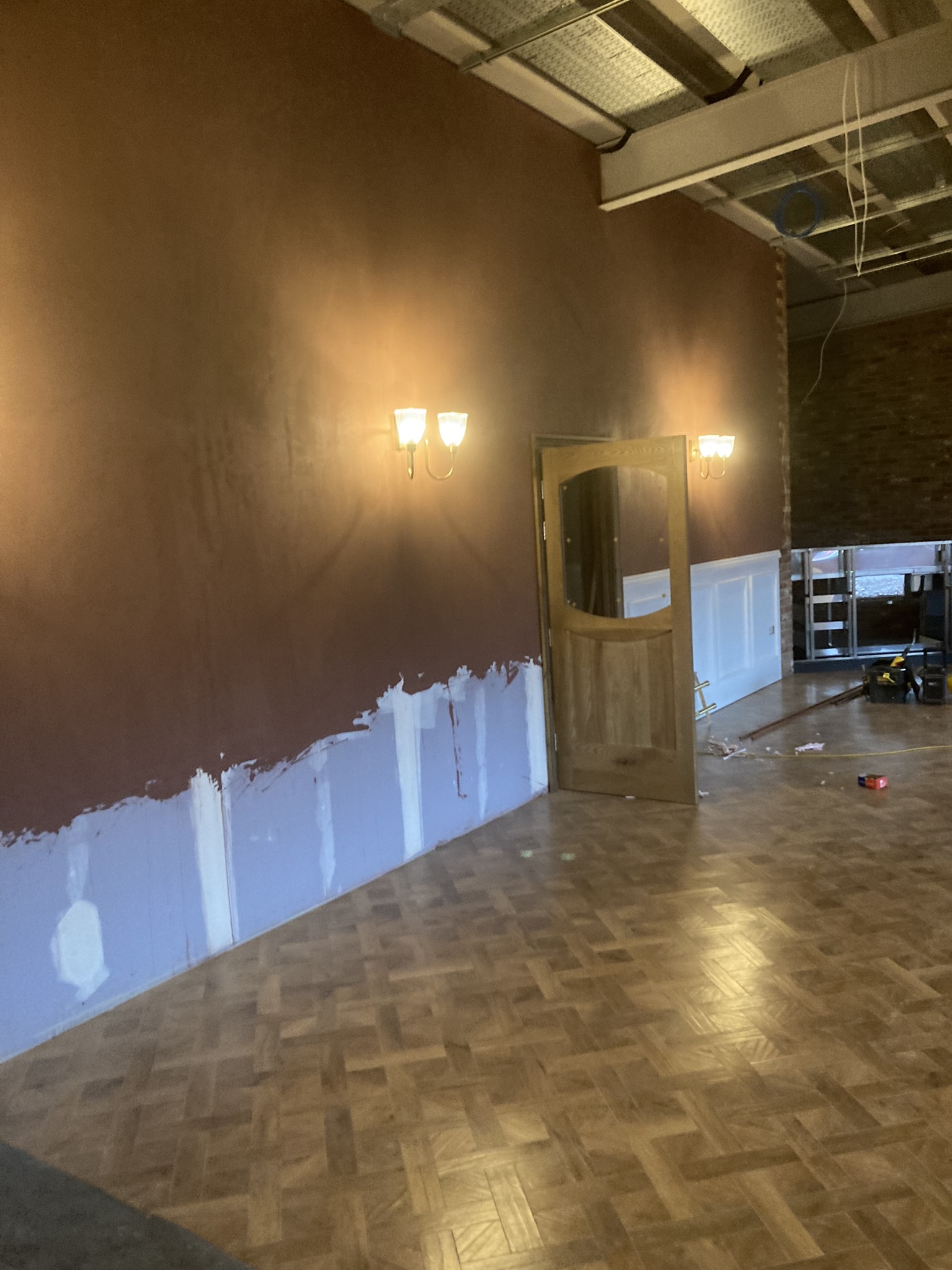

AppleDown Posted January 23, 2023 Share Posted January 23, 2023 Hi all, First post on here - but will have many more as we move on from a 'quick' renovation of our current home into building a new one. We're in the market for a feature wall in a high ceiling lounge/diner/kitchen area. We really want to add a concrete/cement style area and have looked at some of the wall panels you can get. There are a few that could work, but they're quite expensive. We were in our local builders merchant at the weekend and both stopped when we went past the cement board, and were thinking - why couldn't this work? Is there any reason why you wouldn't use just basic cement particle board to fulfil this need? As long as it doesn't have any standard maker marks or prints on it, it looks the deal. Can match it up with some fine colour matched grout. Just haven't seen any examples of using it online. Am I missing something? Link to comment Share on other sites More sharing options...

nod Posted January 24, 2023 Share Posted January 24, 2023 32 minutes ago, AppleDown said: Hi Nod - this look interesting. Any downside to using a clay plaster? It’s quite expensive But if your only doing one wall it’s not to bad It comes in every shade and colour We deal with two designers who incorporate it Into what seams like every job difficult to tell from the photo I’ll see if if can find some better ones 1 Link to comment Share on other sites More sharing options...
