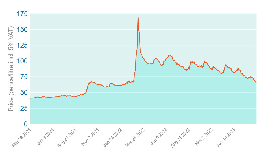

Furnace Posted March 27, 2023 Posted March 27, 2023 On 27/03/2023 at 08:02, Iceverge said: Yikes, oil is certainly cheap. I didn't realise it was so much so now. Expand Prices now back to pre-Russian Special Military Operation levels
