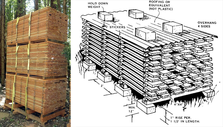

Onoff Posted January 12, 2018 Share Posted January 12, 2018 (edited) Draughts are good for wet wood! A covered stack with spacers in between is how they season wood without / before a kiln. Make that shed airtight and it it'll rot and go mouldy quicker than a quick thing........unless you plan fitting MVHR! If you use the wet boards make sure you screw where you can get them out again. If that wet you can probably afford to butt them up tight. When they dry out once covered you'll hopefully have a shrink gap that's not enormous. Edited January 12, 2018 by Onoff Link to comment Share on other sites More sharing options...

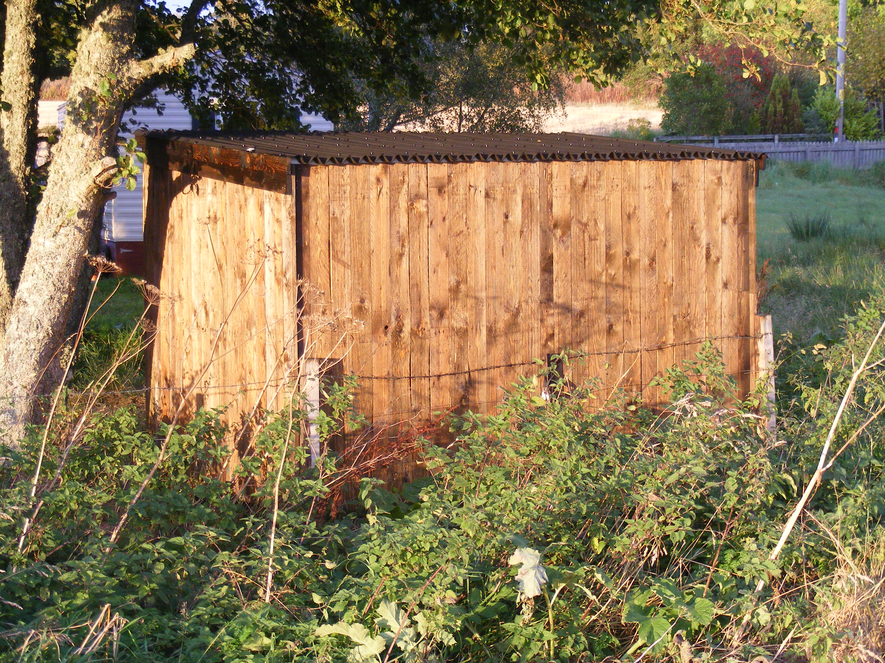

ProDave Posted January 28, 2018 Share Posted January 28, 2018 I would never ever ever use "roofing felt" for a shed roof again. Miserable product with a very short life before it starts leaking. Corrugated bitumen impregnated solid panels is my choice of shed roof now. Link to comment Share on other sites More sharing options...
Onoff Posted January 28, 2018 Share Posted January 28, 2018 Must admit I've used the corrugated bitumen panels (from Wickes) on a garage, even putting extra cross supports in and they were utter shite and then some. Washing up bowl size depressions formed between the supports and it just collapsed like wet carboard. BiL did the same with green ones on his workshop and it failed on there too. Link to comment Share on other sites More sharing options...
ProDave Posted January 28, 2018 Share Posted January 28, 2018 My wood shed at the old house has those (from B&Q perhaps theirs are better?) and after nearly 10 years they are still fine (outlived the roof felt on the other shed) with no sag. Supported horizontally every 2ft. Link to comment Share on other sites More sharing options...
