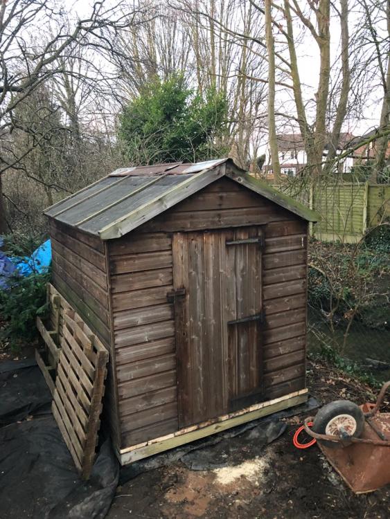

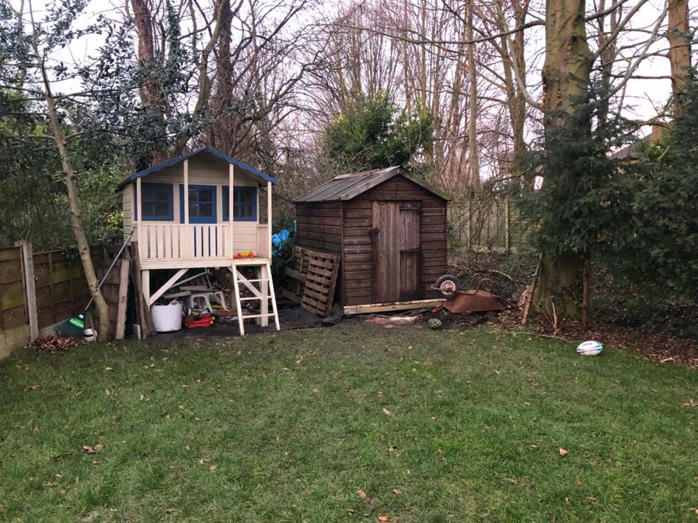

daiking Posted July 17, 2017 Share Posted July 17, 2017 I now have somewhere permanent to site a shed so I better do it properly. It has just spent 2 years sat on a tarp on the ground - although it is heavily shaded by mature trees that also suck the water out of the ground so the base was reasonably dry. I have obviously googled shed bases and I can do anything from lay concrete footings and a concrete slab, to paving flags base and even a timber frame base. Assuming the cement mixer I acquired still works its probably worth me having a practice with that. The flaw in my plan is that even if the mixer works, I'll still need to hire a compactor for the hardcore. I don't need something that you could build a house on but which way would you do it? Link to comment Share on other sites More sharing options...

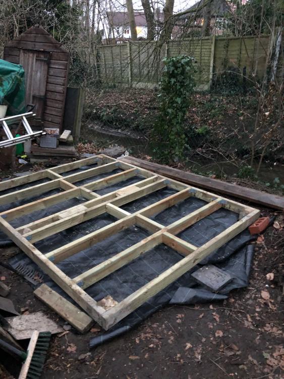

ProDave Posted July 17, 2017 Share Posted July 17, 2017 Is it going on a bit of your newly infilled and leveled garden? If so you might have a problem with the ground settling. In that situation I have put a shed base on wooden stakes (think short fence posts) driven into the ground and hammered in until they will go no more (into the underlying firm ground) Then support a timber base frame from that. then if the infilled ground settles, the shed won't move. 1 Link to comment Share on other sites More sharing options...

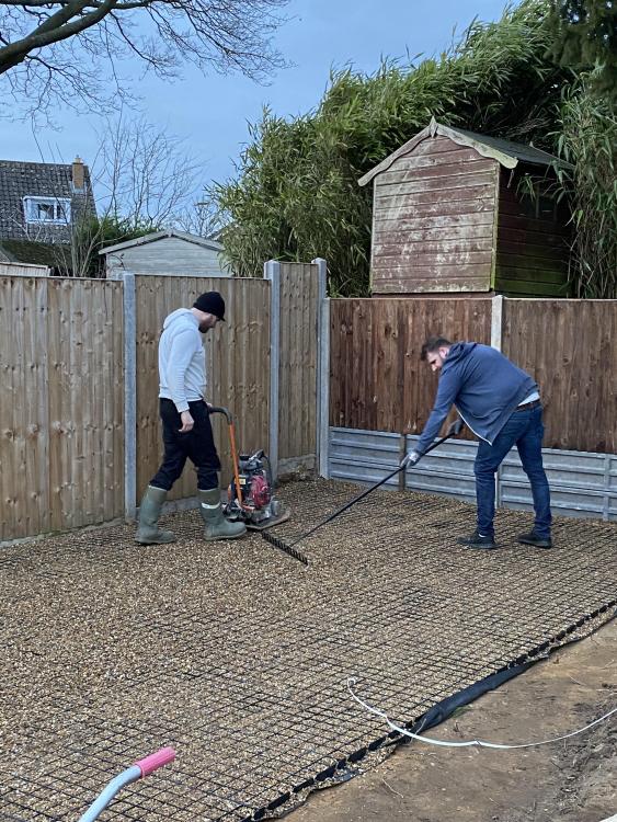

Onoff Posted July 17, 2017 Share Posted July 17, 2017 (edited) I need to get rid of some hard-core so reckon I should get on with the shed (base) under the tree house. It's only about 10'x5'. You honestly don't need to hire a compacter. I did my last base with a hand tamper. Just a weight on pole you lift and drop. Edited July 17, 2017 by Onoff Link to comment Share on other sites More sharing options...
ProDave Posted July 17, 2017 Share Posted July 17, 2017 A wacker plate is a bit of equipment that one should buy, use, and then possibly sell on. I have already hired mine out twice and that has covered about 1/3 what it cost me. Link to comment Share on other sites More sharing options...
Onoff Posted July 17, 2017 Share Posted July 17, 2017 Tbh I'll probably use my Evolution electric wacker plate seeing as I haven't made the other one yet! Link to comment Share on other sites More sharing options...
daiking Posted July 17, 2017 Author Share Posted July 17, 2017 1 hour ago, ProDave said: Is it going on a bit of your newly infilled and leveled garden? If so you might have a problem with the ground settling. In that situation I have put a shed base on wooden stakes (think short fence posts) driven into the ground and hammered in until they will go no more (into the underlying firm ground) Then support a timber base frame from that. then if the infilled ground settles, the shed won't move. It's down the bottom of the garden that hasn't been properly sorted. Just scraped off a little so the ground is fairly sound. The plan is to put membrane and mulch bark in that area anyway. A bit of joinery wouldn't be bad experience either. And I have 3 pieces of 11mm OSB2 that I could layer to make a 6x8 shed floor. Posts could be concreted in as well, not just into the ground. The playhouse sits on 4 posts bit that is going on the grass so that will have to wait a while. I'm just going to make 4 concretr pads for those legs. It was on paving stones before but I don't want to take up that much space this time. Link to comment Share on other sites More sharing options...

Ferdinand Posted July 17, 2017 Share Posted July 17, 2017 (edited) Can you concrete galvanised scaffold poles into the ground and go off those? If concerned about the thing moving I might incorporate something adjustable that can be relevelled without major trouble. Can I put another word in for Wallbarn Adjustable Support Pads even on one slab each... which can be obtained in varieties up to 400mm tall, or as heavy duty. http://www.wallbarn.com/products/roof-and-terrace-finishes/asp-adjustable-support-pads/ The normal ones ones cost a fiver and support just under half a tonne each. Wish I had them as I am going to have to jack my shed up this year because my fence post base has moved. Edited July 17, 2017 by Ferdinand Link to comment Share on other sites More sharing options...
Barney12 Posted July 17, 2017 Share Posted July 17, 2017 4 hours ago, daiking said: The internetz sayz the 2.4hp petrol Evo is rubbish, let alone an electric one... Not going on eBay or gumtree for one, I'd have no idea what I was looking for. I have a petrol Evo. Is it rubbish? Well it depends on what you are comparing it against: Is it as good as a hired heavy duty plate vibrator? No. Not even close. Is it capable of being lifted by one man? Yes. Is it much, much more efficient than hand wacking? Yes and more yes. Would I use it to prep a very large area? No. Is it good enough for shed bases, paths etc? Yes. Mine lives in the shed shed with a variety of other "stuff" and I find it useful. If buying again gain I think I'd look out for a second hand Belle unit. As @ProDave said it will likely get its money back again when you come to sell it. 1 Link to comment Share on other sites More sharing options...
daiking Posted July 17, 2017 Author Share Posted July 17, 2017 42 minutes ago, Barney12 said: I have a petrol Evo. Is it rubbish? Well it depends on what you are comparing it against: Is it as good as a hired heavy duty plate vibrator? No. Not even close. Is it capable of being lifted by one man? Yes. Is it much, much more efficient than hand wacking? Yes and more yes. Would I use it to prep a very large area? No. Is it good enough for shed bases, paths etc? Yes. Mine lives in the shed shed with a variety of other "stuff" and I find it useful. If buying again gain I think I'd look out for a second hand Belle unit. As @ProDave said it will likely get its money back again when you come to sell it. That's why it was internet with a z. I'm in no position to offer an opinion about the relative merits of any tools Link to comment Share on other sites More sharing options...
Onoff Posted July 17, 2017 Share Posted July 17, 2017 No issues with my Evolution leccy wacker. 5kN is better than me doing it. Did the bathroom fine, Link to comment Share on other sites More sharing options...
Onoff Posted July 18, 2017 Share Posted July 18, 2017 It's a shed base, not over critical. Plenty out there barely have the rubble compacted I bet. I would though add this to your concrete mix along with a sheet of mesh. Much less tamping as it is a deaerator too. https://www.toolstation.com/shop/p80460?table=no Link to comment Share on other sites More sharing options...

Siochair Posted July 18, 2017 Share Posted July 18, 2017 I once had a neighbour who used a plastic grid filled with stones/gravel as a shed base. No idea how long lasting it was as we both moved not long after. I do remember that it was pretty idiot proof to do. He managed both base and shed in just over a morning. I have no idea where he got it from but I am sure there are probably kits available. Link to comment Share on other sites More sharing options...
