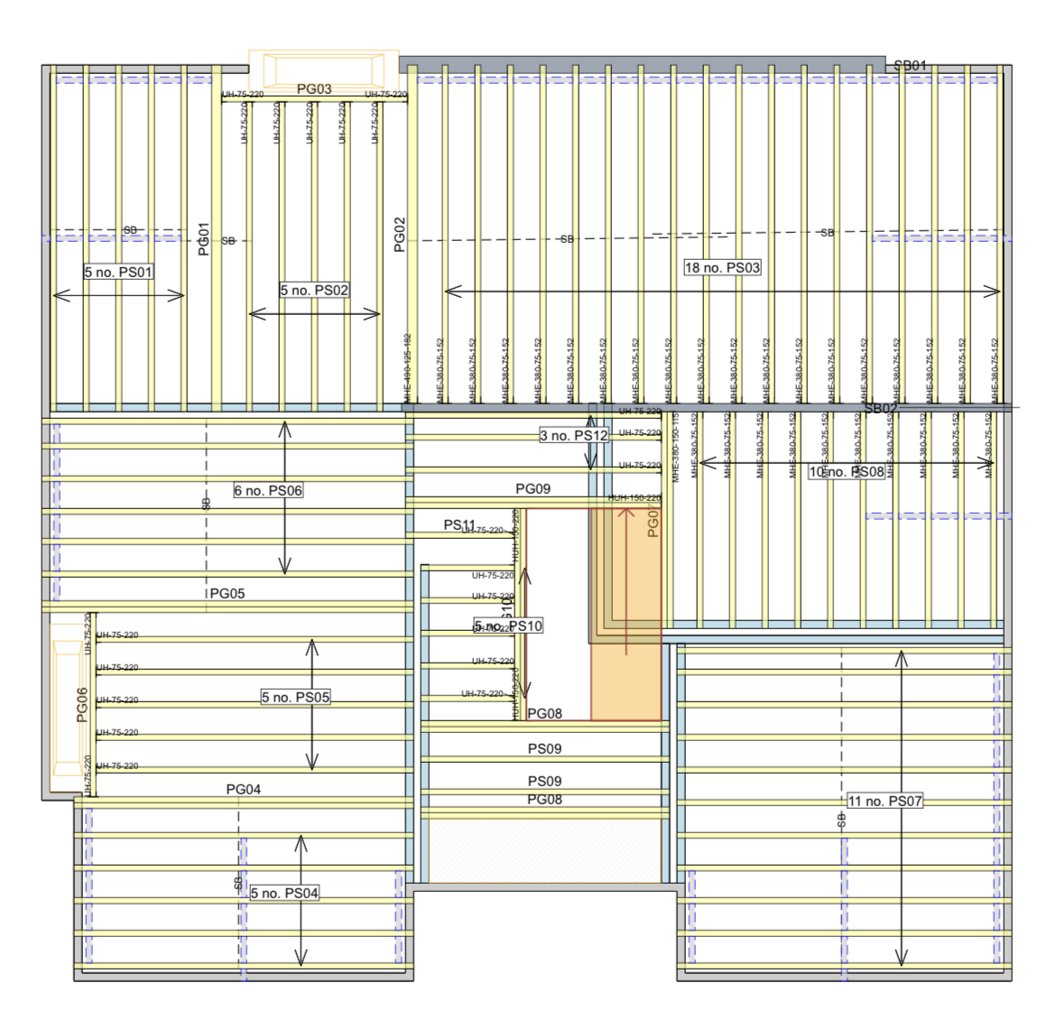

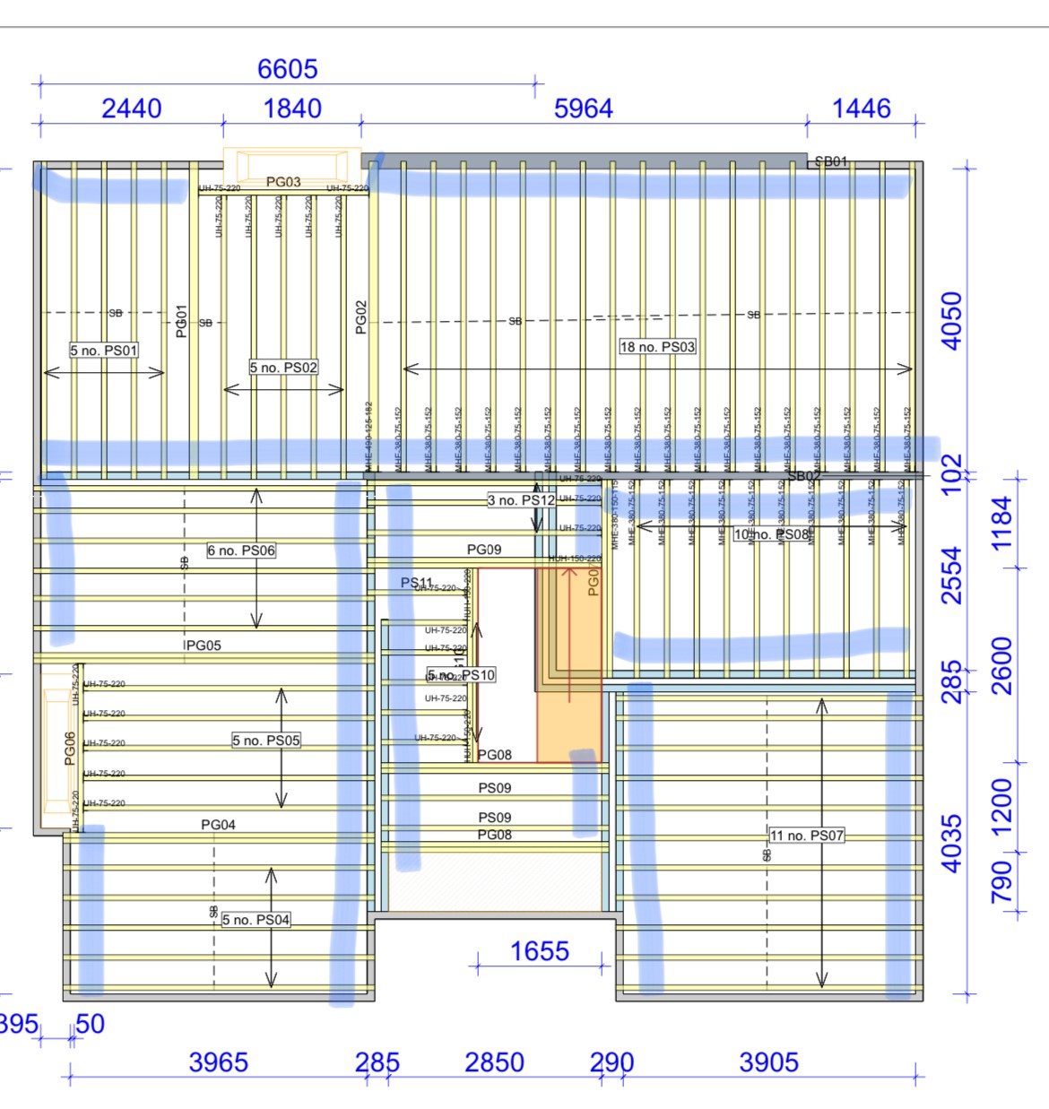

richo106 Posted January 10, 2023 Posted January 10, 2023 Hi all This time next week the builders want me start installing Egger peel & clean 22mm T&G floorboards, i have downloaded the egger installation and happy with how it needs to be fixed. I have 75mm posi joists that are going to be installed at 400mm centres, I am pretty sure the layout created by the posi joist company would not have any thought for the floorboards to ensure they finish on a joint. I am guessing that I will have to install quite a few noggins What is the best way to reduce the amount of noggins needed and also the best way to install a noggin on a posi joist? How much glue you reckon is required per board/m2 etc just so i can make sure i order enough Many Thanks
nod Posted January 11, 2023 Posted January 11, 2023 You will need nogs where the wall restraints are Normally three per restraint x 4 But that will show on your drawing and anywhere where a stud lands between two joists But these can be done from below if you haven’t settled on your layout and a bunch under your bath tub Presuming Posi You won’t need them around the perimeter If you recon a liter of glue per 4-5 sheets

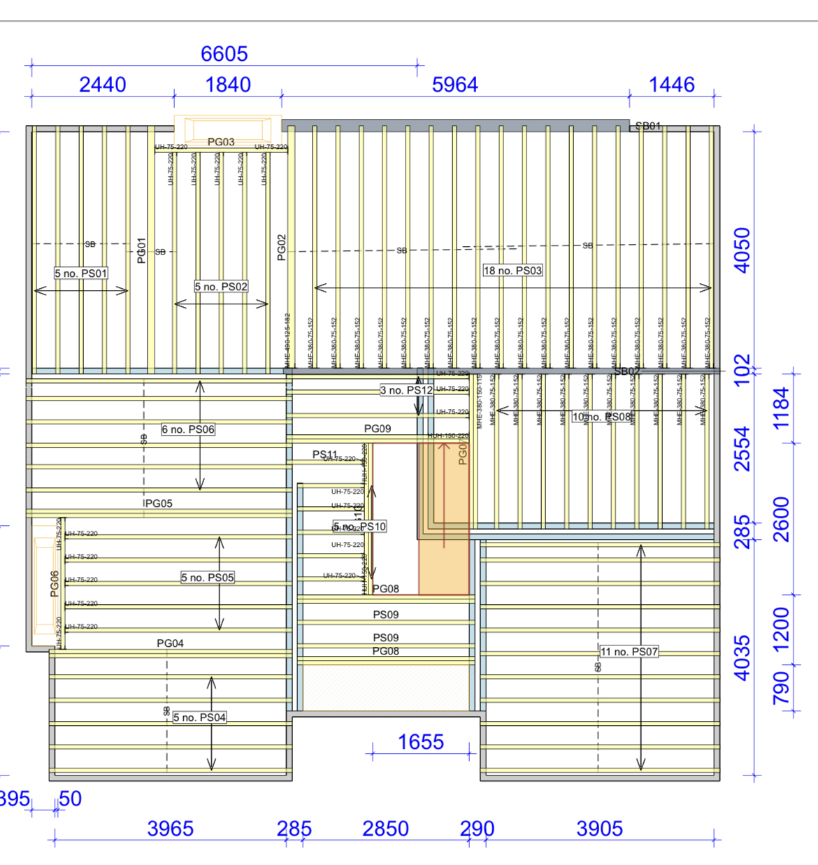

richo106 Posted January 11, 2023 Author Posted January 11, 2023 There is no noggins shown on my drawing at all (see attached) Am I right in thinking I need a noggin where the floorboard join? Thanks regarding the glue
nod Posted January 11, 2023 Posted January 11, 2023 10 minutes ago, richo106 said: There is no noggins shown on my drawing at all (see attached) Am I right in thinking I need a noggin where the floorboard join? Thanks regarding the glue I’d check with the supplier But here’s where your restraints should be Everything else can be done afterward
richo106 Posted January 11, 2023 Author Posted January 11, 2023 When you say restraints….are they strongbacks? cheers
nod Posted January 11, 2023 Posted January 11, 2023 1200 long wall plate straps They hook over the cavity and are then built in You joist supplier should supply these Along with any joist hangers
PeterW Posted January 11, 2023 Posted January 11, 2023 9 hours ago, richo106 said: installed at 400mm centres, At 400 centres you don’t need to land on a joist with a short join - the boards either side will support it. If these are Pozijoists then they should have edge trim all the way round using z clips - usually use 47x47 timber. As @nod says though - should have restraint straps into your blockwork where the joists run parallel to the walls plus they need blocking at that point. Strongbacks should already be installed.
richo106 Posted January 11, 2023 Author Posted January 11, 2023 9 minutes ago, PeterW said: At 400 centres you don’t need to land on a joist with a short join - the boards either side will support it. If these are Pozijoists then they should have edge trim all the way round using z clips - usually use 47x47 timber. As @nod says though - should have restraint straps into your blockwork where the joists run parallel to the walls plus they need blocking at that point. Strongbacks should already be installed. That's good regarding the boards not needing a noggin I have emailed the posi joist company regarding the issues raised about the restraints and edge trim. I already have some z clips ready to support a couple of stud walls above If i don't get an answer this morning ill give them a ring Strongbacks will be installed shortly Many Thanks

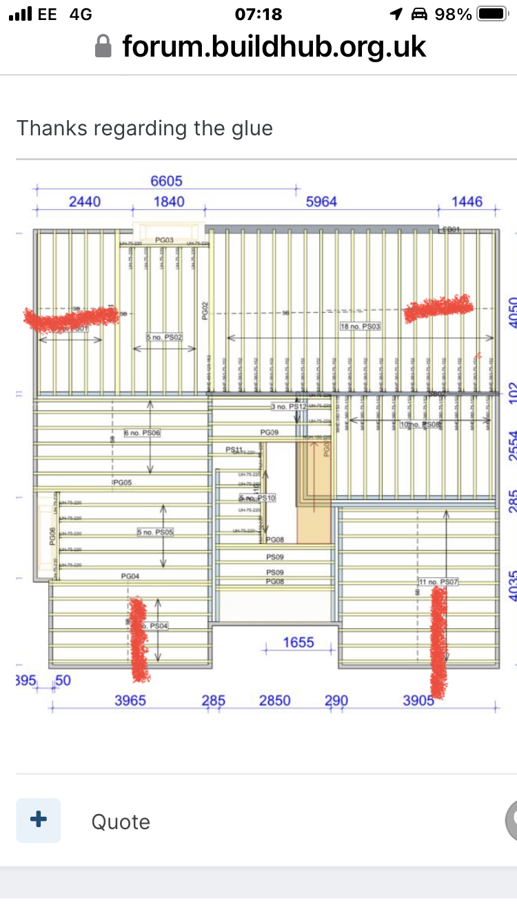

richo106 Posted January 11, 2023 Author Posted January 11, 2023 4 hours ago, PeterW said: At 400 centres you don’t need to land on a joist with a short join - the boards either side will support it. If these are Pozijoists then they should have edge trim all the way round using z clips - usually use 47x47 timber. As @nod says though - should have restraint straps into your blockwork where the joists run parallel to the walls plus they need blocking at that point. Strongbacks should already be installed. Regarding the edge trim, I have attached my layout and highlighted the areas that I will need edge trim for. Would you agree with this? Just so I can all z clips ordered The company haven't got back to me yet but planning to do it

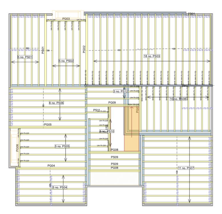

richo106 Posted January 11, 2023 Author Posted January 11, 2023 Update: The joist company has done an updated layout drawing that shows noggins and restraints. Does this look ok? Thanks again @nod @PeterW
nod Posted January 11, 2023 Posted January 11, 2023 22 minutes ago, richo106 said: Update: The joist company has done an updated layout drawing that shows noggins and restraints. Does this look ok? Thanks again @nod @PeterW Your welcome Anytime

nod Posted January 11, 2023 Posted January 11, 2023 19 minutes ago, richo106 said: Is that 25mm off any brick wall? I was reading it depends on length of run etc. Is 25mm a safe cover all? When trimming up around the stairs I guess I make that flush? Yes Off the perimeter 25 mil will easy cover

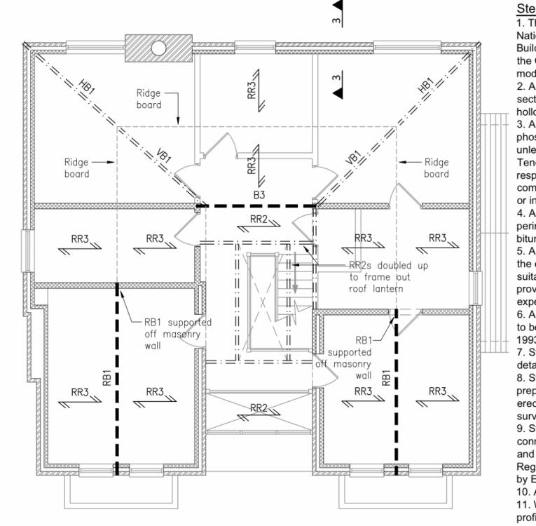

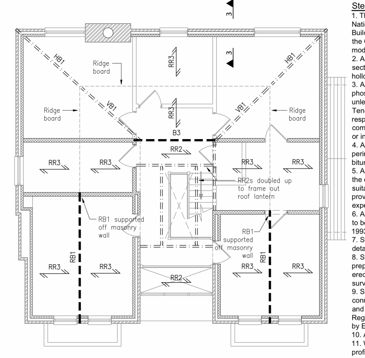

richo106 Posted January 11, 2023 Author Posted January 11, 2023 35 minutes ago, nod said: Yes Off the perimeter 25 mil will easy cover Sorry to clarify, I have attached my first floor SE drawing and as you can see I have a lot of block walls that fly through the build. Leave 25mm off all these or can I go tighter on this. All block walls are planning to be dot/dabbed on the first floor
nod Posted January 11, 2023 Posted January 11, 2023 5 minutes ago, richo106 said: Sorry to clarify, I have attached my first floor SE drawing and as you can see I have a lot of block walls that fly through the build. Leave 25mm off all these or can I go tighter on this. All block walls are planning to be dot/dabbed on the first floor Yes off all If you only leave say 100 mil which is adequate They will soon fill with mortar snots I normally use an off cut of 25 mil baton Without the gaps sound will resonate around the house
