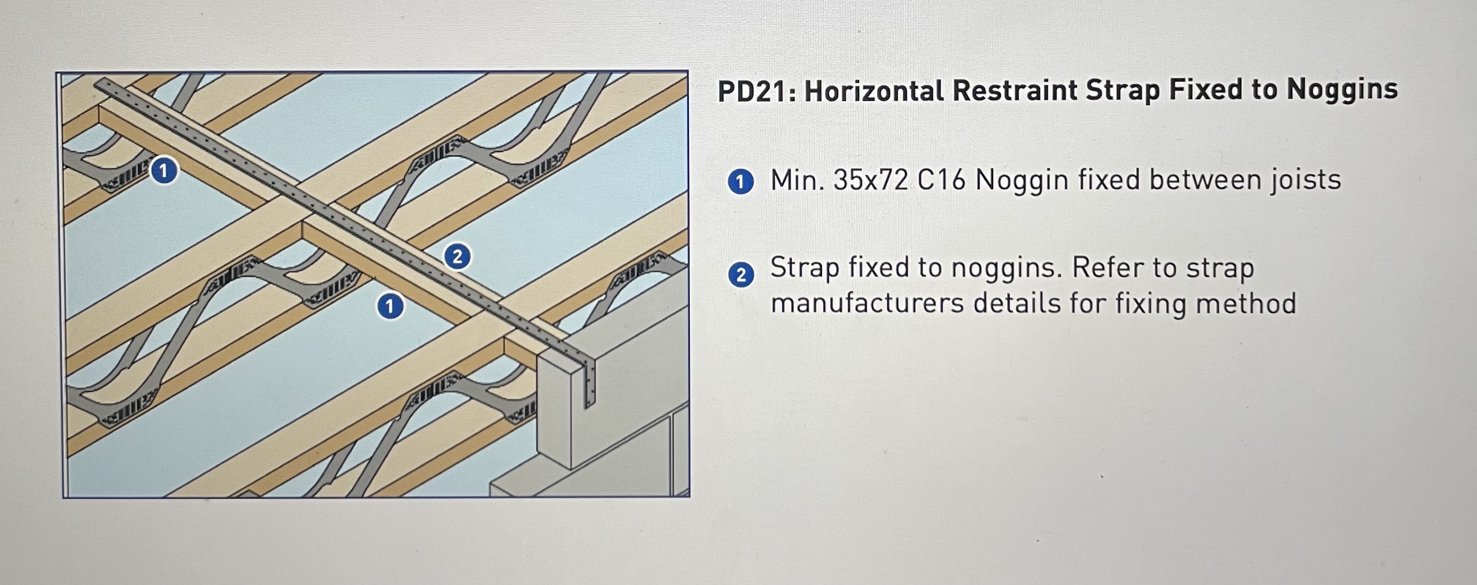

January 12, 20233 yr Author Me again Was just getting all my stuff ready to fitting the rest of my joists including noggins and restraints etc I have ordered the 1.5mm restraints so I can nail them over the top of the noggins. (Please see attached) my concern is that the block work running parallel either isn’t at that height yet or builders have took the block work above the height so I cant fix the strap on the inside of the block work? what is the best way around this? Edited January 12, 20233 yr by richo106

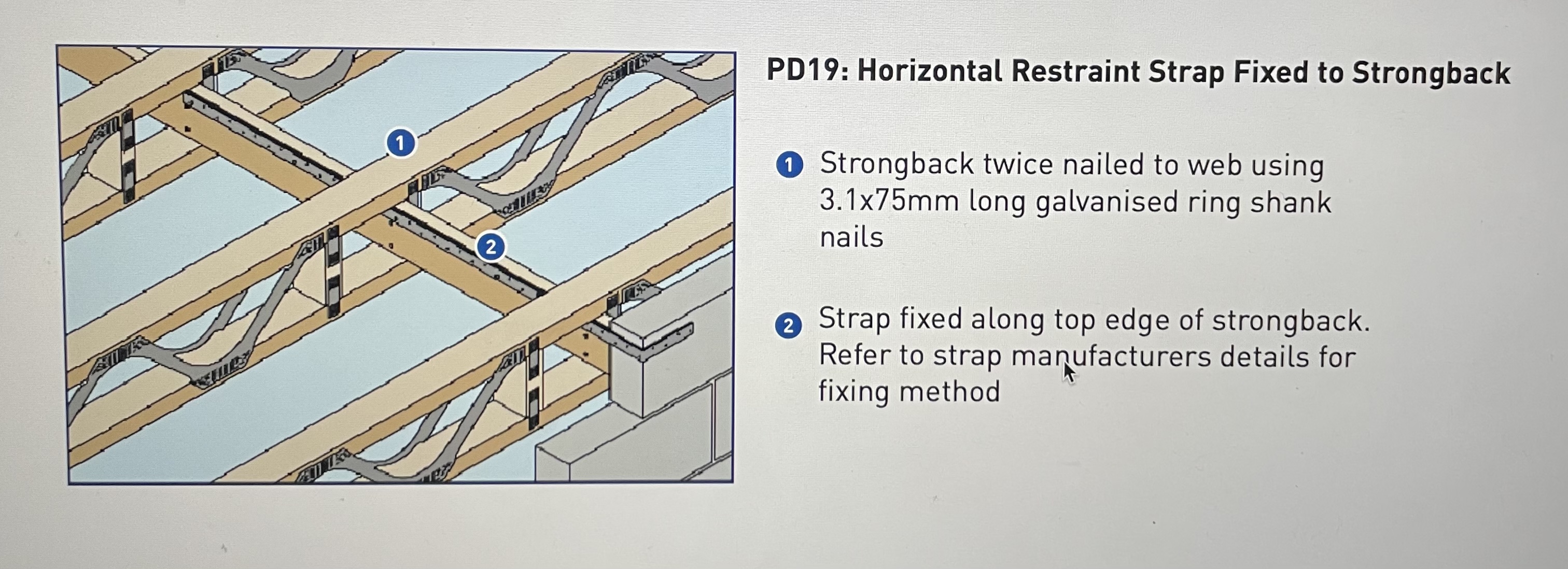

January 12, 20233 yr Author Suppose if the block work isn’t there, I could mount the strap on the strong back as where there is restraints I have strongbacks. Then the builders can build in the straps is this a better method?
January 12, 20233 yr 24 minutes ago, richo106 said: builders have took the block work above the height so I cant fix the strap on the inside of the block work? Nope - if the outside skin isn’t up then you can stitch drill a row of holes and push it through from the block side. If the outer skin is up then you may need to drill a bigger hole to take the leg and the push through and rotate it to hook behind the blocks. Those straps are stabilising your walls and tying the middle of the house together - you don’t want to be missing them out of frigging it with a few screws and plugs …
January 12, 20233 yr 9 minutes ago, PeterW said: Those straps are stabilising your walls and tying the middle of the house together - you don’t want to be missing them out of frigging it with a few screws and plugs … Indeed, in my build this aspect was part of the SE’s design.
January 12, 20233 yr Author 19 minutes ago, PeterW said: Nope - if the outside skin isn’t up then you can stitch drill a row of holes and push it through from the block side. If the outer skin is up then you may need to drill a bigger hole to take the leg and the push through and rotate it to hook behind the blocks. Those straps are stabilising your walls and tying the middle of the house together - you don’t want to be missing them out of frigging it with a few screws and plugs … Sounds good to me Where the block work isn't there can I just put the strap in the correct position so the builders can incorporate it and build round it? Edited January 12, 20233 yr by richo106
January 12, 20233 yr 4 minutes ago, richo106 said: Sounds good to me Where the block work isn't there can I just put the strap in the correct position so the builders can incorporate it and build round it? yep although they need to be tight into the block so if they are hanging I tend to leave them an inch or two long into the cavity and screw them to the nogs or the strong back, and when the blocks are up take the screws out and pull them tight into the blocks and nail into place. Don’t forget to go back and seal round them properly..!
January 12, 20233 yr Author 9 minutes ago, PeterW said: yep although they need to be tight into the block so if they are hanging I tend to leave them an inch or two long into the cavity and screw them to the nogs or the strong back, and when the blocks are up take the screws out and pull them tight into the blocks and nail into place. Don’t forget to go back and seal round them properly..! Thank you! That makes perfect sense

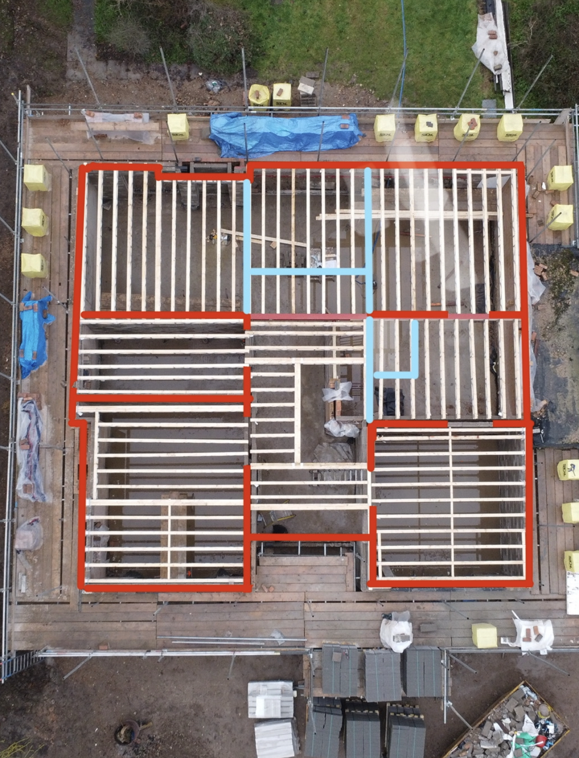

January 15, 20233 yr Author Hi all again I have installed all my joists this weekend, just got plenty of noggins, restraints and strongbacks to add tomorrow. I will be installing the floorboards next weekend just have a couple of questions if anyone can offer some advice. I have attached a picture of my joists and highlighted in red the block walls and then the stud walls that will be on the floor boards in light blue. where the joists are going to same way through a door way do I just do it like laminate flooring and carry it through? Where the joists changed direction through door ways, how and where would I join that? same question really about where and how to join boards on change in direction on joists? Any advice and information greatly appreciated Edited January 15, 20233 yr by richo106
January 15, 20233 yr 14 minutes ago, richo106 said: Where the joists changed direction through door ways, how and where would I join that? Can only see one example of that so don’t panic too much - you can either fit it and cut down the middle of the joist with a circ saw set at 23mm, or easier is to glue and screw a 3x2 to the side of the joist and then land the joins on that. Don’t try and get clever and do T&G ends into sides as it just doesn’t work !! Don’t forget to cut a knocking block off a board offcut - that’s the profile of the edge so you don’t smash the tongue or the groove of a board knocking it into place. Are you screwing or nailing the boards as well as glue ..?
